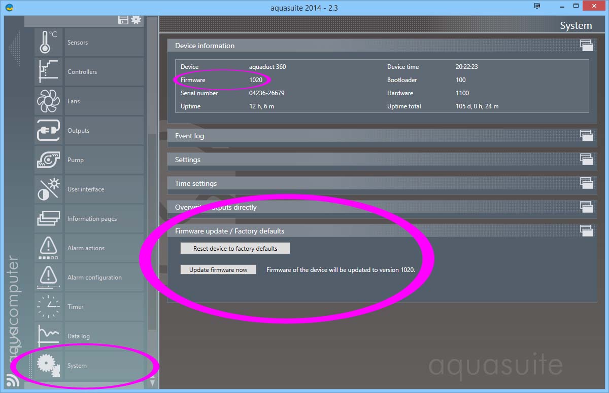

If you click on the system tab under the aquaero, you will see your current firmware version, and the version it is able to update to.
This part I am not 100% clear on, but I believe if they are the same, then you have the latest version installed. - hopefully someone will correct me if I am wrong.
