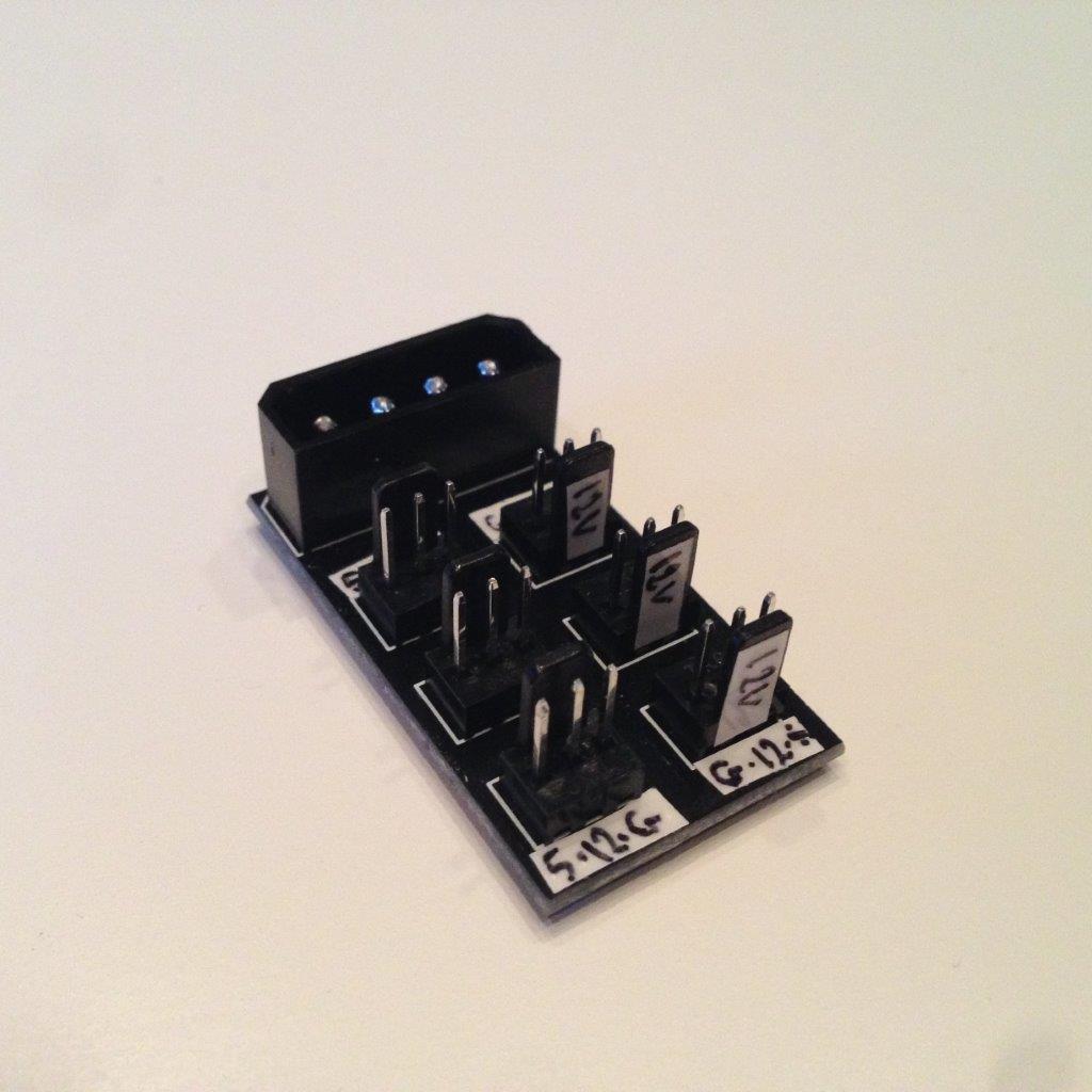

I originalle looked for a Molex splitter on a pcb board, but existing boards were way too big and they also cost 20-30 euros...
Considered buying stuff to make my own PCB, but that would be pretty expensive as well, since I don't have any of the items needed. Also can't find female molex plugs for PCB for some reason! 8|

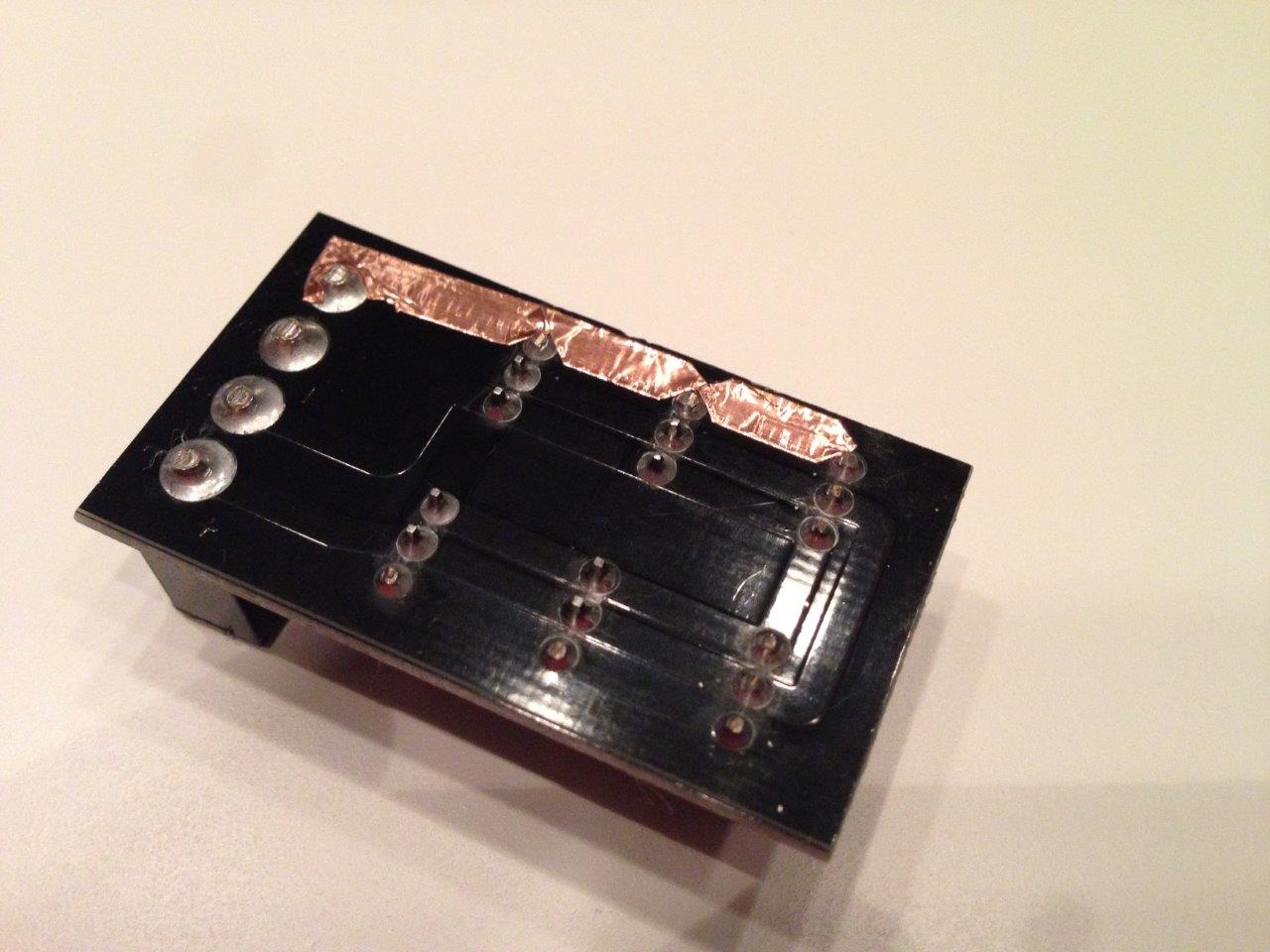

Bought a cheap Molex to 6x fan board and soldered a copper row on the back, so one row of the fan outputs can deliver 5,7 or 12v. There is one GND in it also.
Image is before I soldered it.

I needed to know it in order to make a proper powerplug for Aquaro to use with the adapter I just made (images in above post).. or see if I needed to make a seperate real 4pin molex for the Aquaro.
