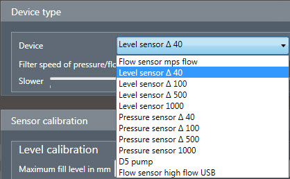

I just setup this D5 pump adapter with this reservoir. Now I'm configuring the fill level sensor. Can anyone guide me on which device I should select (see attached screen shot) for proper operation? There are multiple selections and I can't tell which one is the right one.

At the end of the Pump Adapter Manual it says:
Fill level sensor (art. no. 41095 only)
Please refer to the manual “mps”. The sensor installed into the pump adapter is a “mps
pressure ∆40“. Install a pressure equalizing membrane into the top of the reservoir.
So select the ∆40 you have highlighted in your image.
EDIT: be sure to instal the Pressure equalisation membrane mentioned into one of the top ports of the reservoir, or the results will be incorrect.

Ah I see it now. Thank you for pointing out what I overlooked.
Thank you for the warning about the membrane. It is installed as stated.
