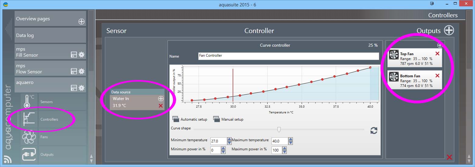

Are you using the controller tab in aquasuite?
You add a controller (I use Curve Controller for fans), then add a "Data Source" to the left side of the controller, and the fans you want controlled to the right side of the controller. You can either use an automatic default curve, or enter manual points for the controller.
[attach]5244[/attach]
Ah! I didn't realise there was software. So you can't actually control the fans on the Aquaero unit itself? You have to use the software?
The entire functions of the controller can be accessed through the LCD display and menus. The Aquasuite software just makes it much easier because you aren't limited to 3 keys and a tiny display.
The whole system is naturally very complex to fit all that functionality in but the important parts aren't difficult once you understand it

In the factory settings all fans connected to the preset controller 1.
To adjust the fan speed you have to adjust only the preset 1 controller in "Controllers" in the Menu.
When you understand the logic of the aquaero it is very simple.
sensor -> controller -> outputs
