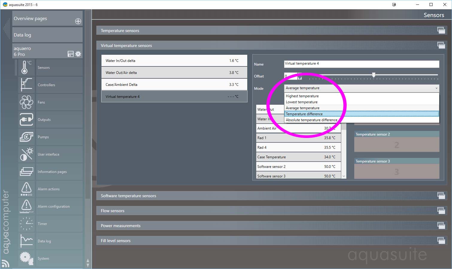

Below is the drop down list of virtual options:

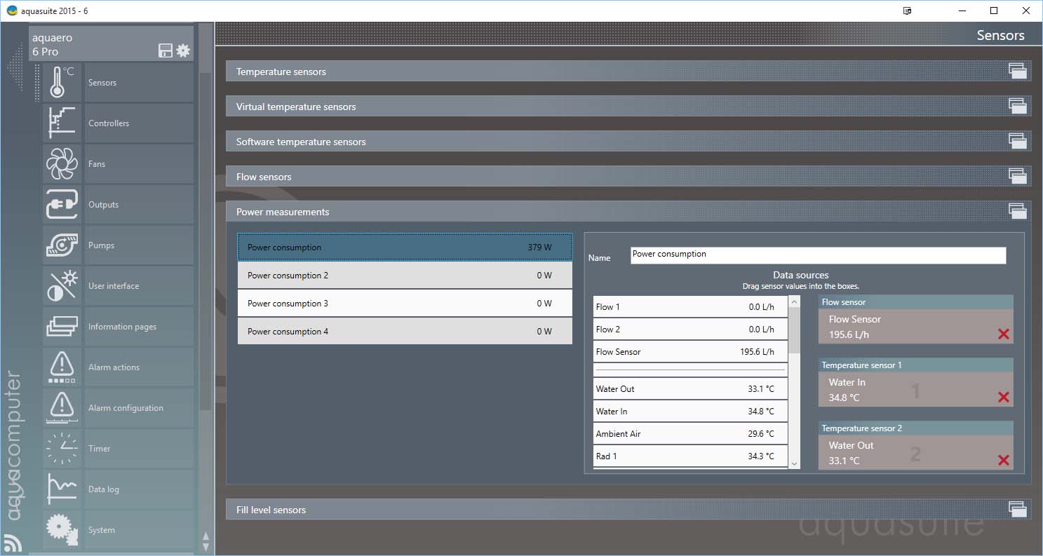

There is a built-in Power calculation in aquasuite, but from what I understand it is to be taken with a grain of salt:
[attach]5356[/attach]
[attach]5357[/attach]
Sweet! That's exactly what I was looking for. Do you know how the power calculation is done? Are they basing the estimates on the standard heat capacity of water?
From the manual page 29:
The aquaero calculates the current power dissipation using the temperature
difference between two temperature sensors and the current flow rate. Water
ha a thermal capacity of 4187 Ws/(kg * K), meaning an energy of 4187 Ws
is required to increase the temperate of 1 kg of water by 1 Kelvin.
Power = thermal capacity * volume flow * temperature difference
Due to inaccuracies of temperature and flow sensors and temperature inertia
of the cooling system, power measurement is a bit problematic in general.
Especially during system start up, the actual power dissipation will differ sig-
nificantly from values calculated by the aquaero. Furthermore, any coolant
additive alters the thermal capacity, this is factored in in the aquaero. The
power measurement functionality should therefore just be seen as an interest-
ing additional information.
