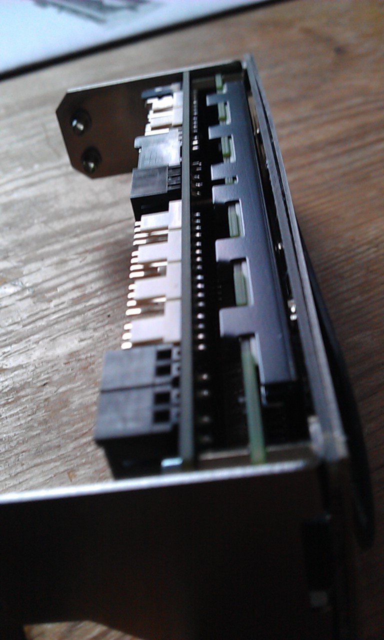

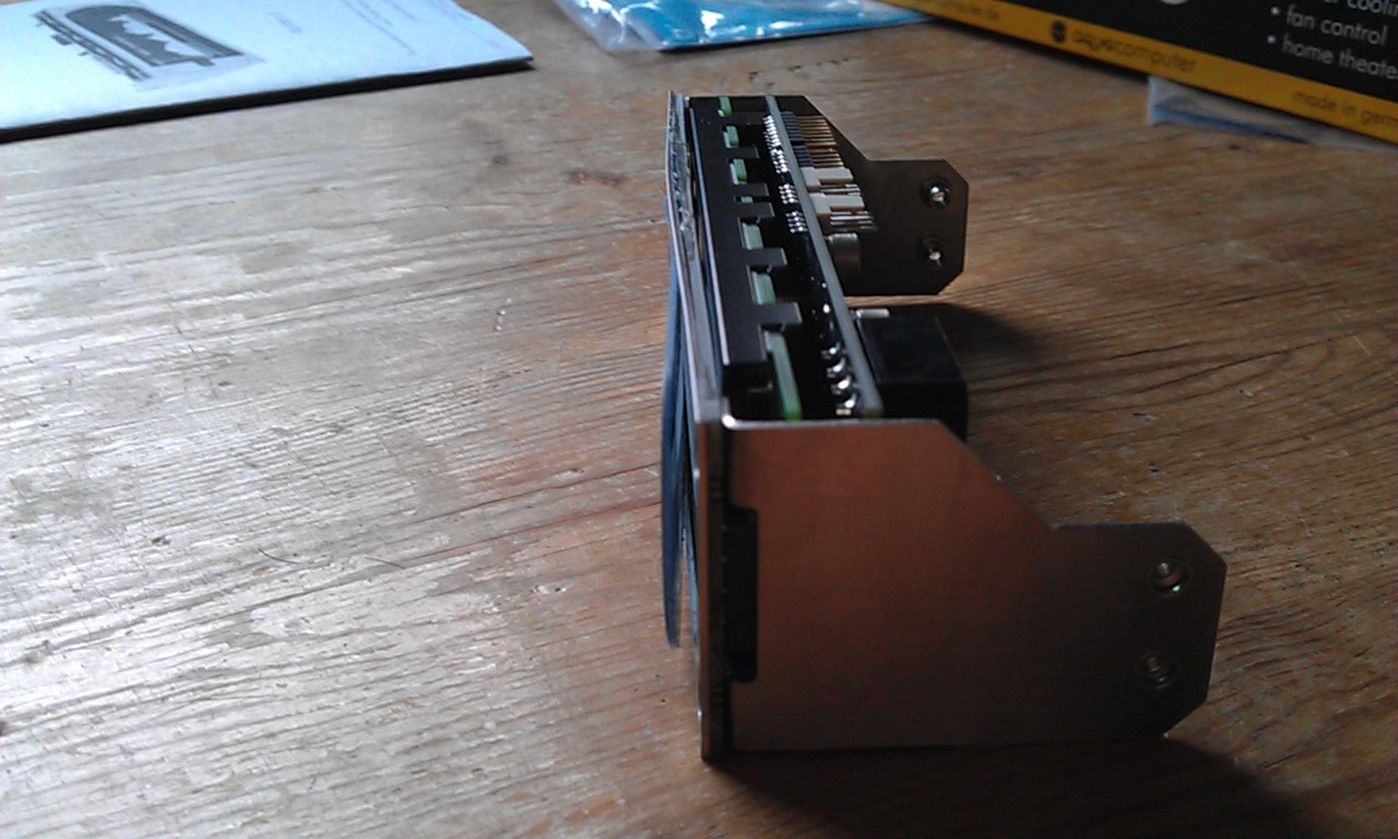

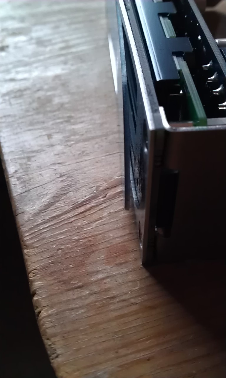

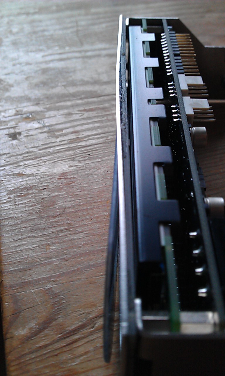

Just got my Aquaero 6 XT in the mail from HighFlow today but instead of turning into a moment of excitement, it very quickly turned into a show stopper as the build is getting nowhere without this piece of kit.
This is what greeted me out of the box:
Freitag, 4. September 2015, 23:23
Sorry to see that. You should send an e-mail with your address details to info at aqua-computer.de to get a replacement part. The whole front (cover, glass, touch PCB) can be easily exchanged. Just refer to this thread and also mention which variant you own (red or blue LEDs).

Aqua-Computer support was contacted prior to making this post. The unit is a blue Aquaero 6 XT.
I've read of others having this issue prior to making my purchase, but I was confident that I'd receive an intact unit which, obviously, didn't happen. Of course the assembly quality of this unit could still be one of a few exceptions, but somehow that isn't either a comforting, nor a reassuring thought.
