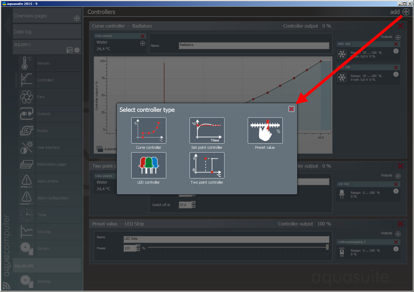

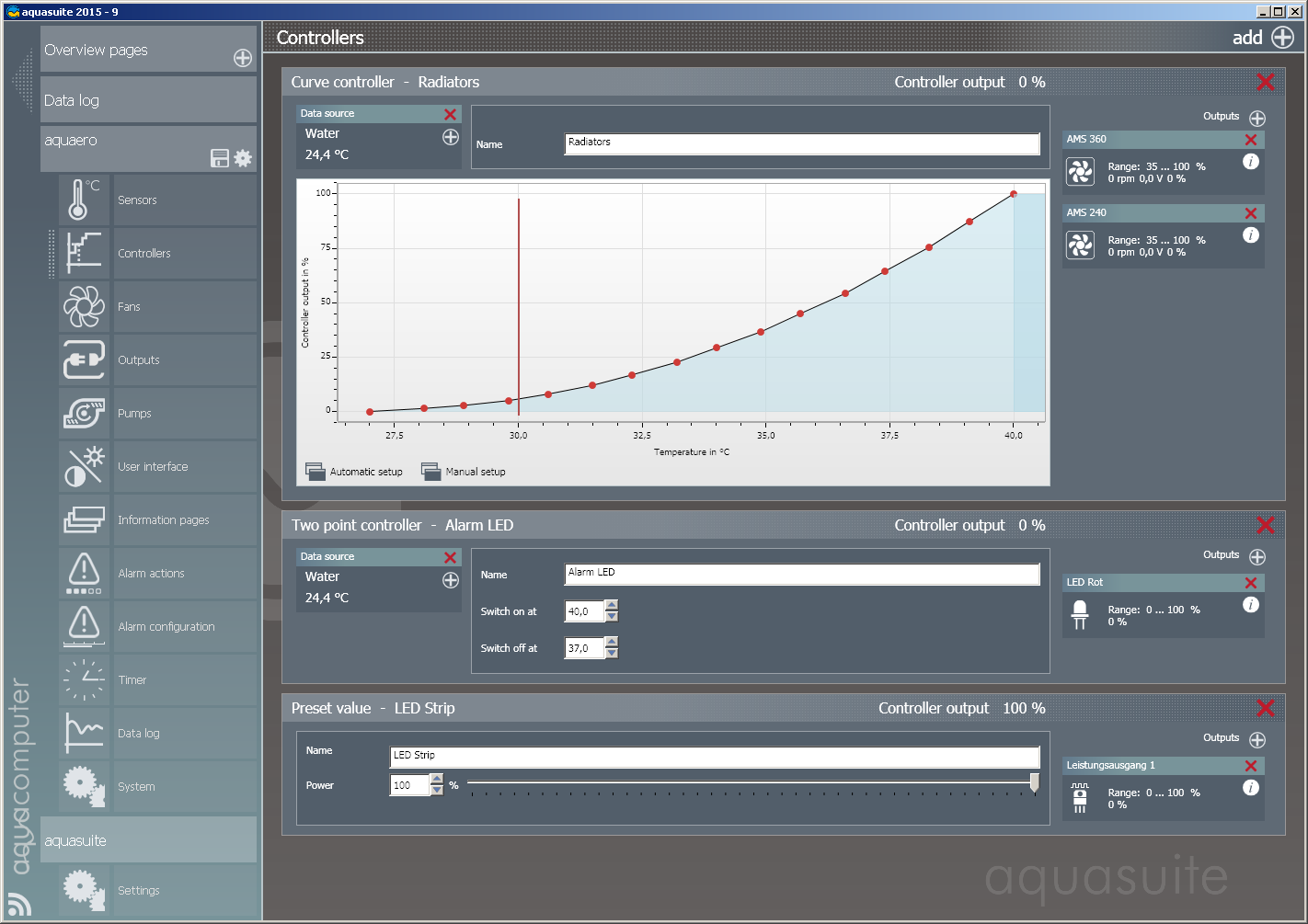

  • New: Optimized layout for controller page

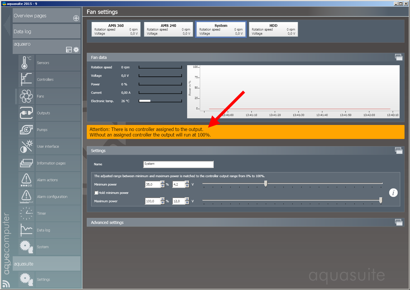

  • New: A warning message appears if fans are not assigned to a controller
  • New: Simulation tool to test the scaling of controller output -> device output

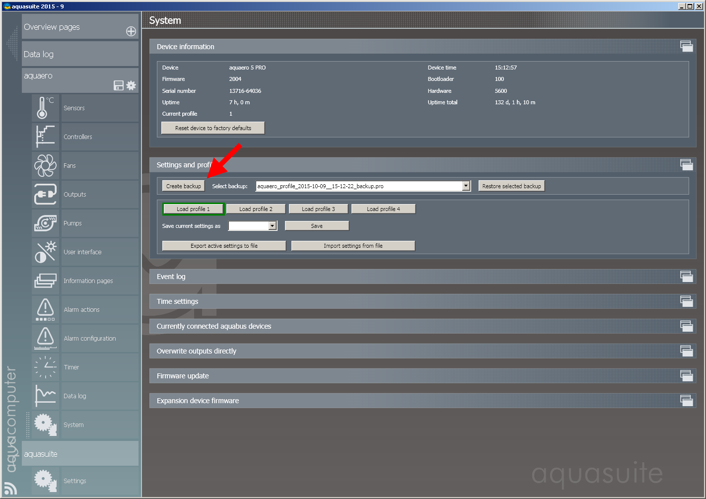

  • New: Automatic backup of the profile data before a firmware update will be applied (only if compatible)

  • New: Backup function to save all profiles of the device

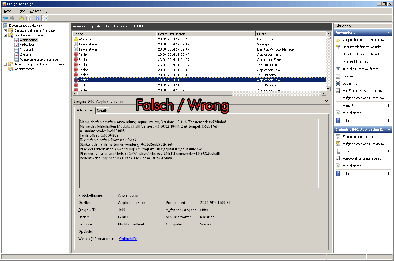

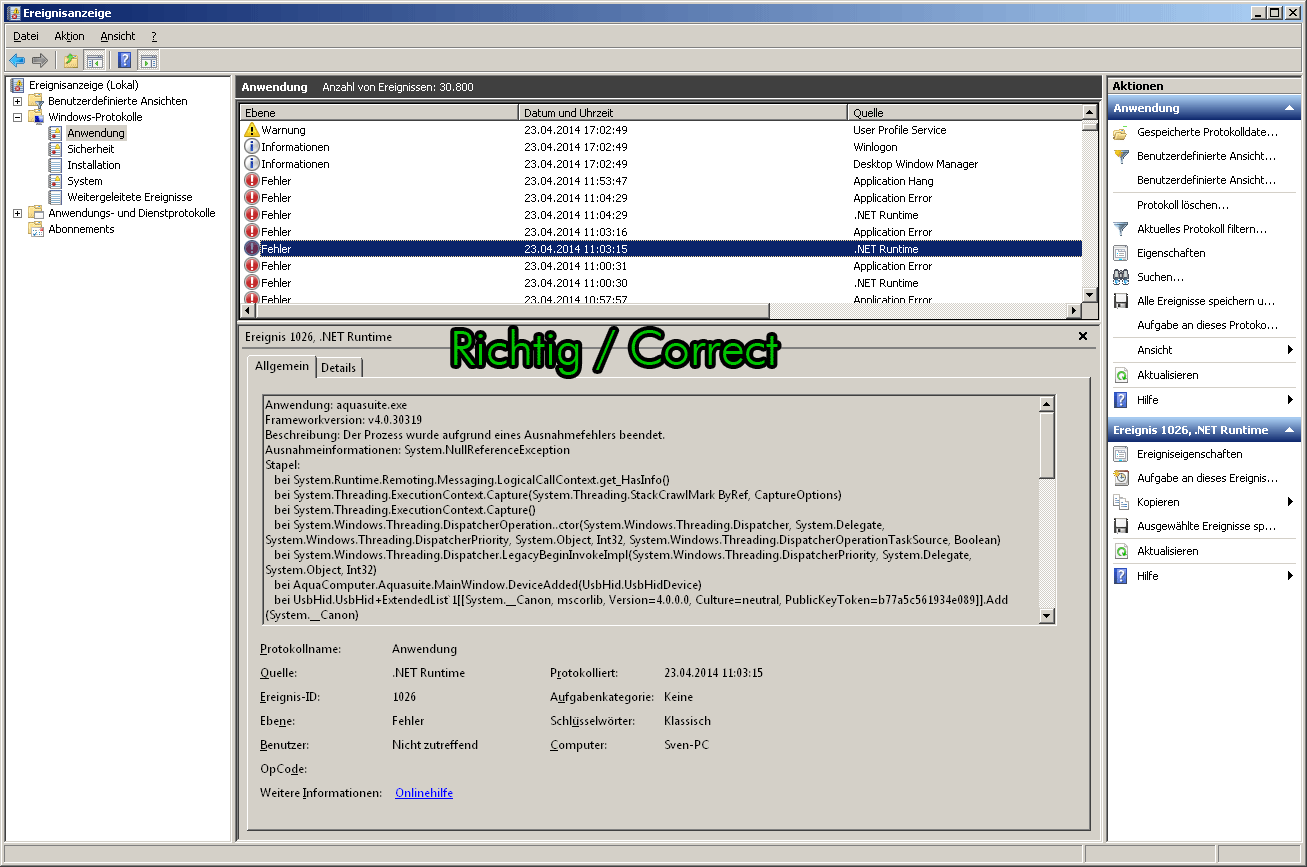

If you encounter problems, please provide detailed information so we can check and fix it if necessary. Just in case your aquasuite crashes, please also provide the error report from the event viewer. We need the extended report, not the short one:

I have not seen all changes, but the few I have, like the controller type selector, are excellent :)
One issue I noticed is the aquaero profiles are lost with the firmware update, so all naming, virtual/software sensors and controllers are gone.
If there is a method to save them you may want to post the procedure so others may not have to rebuild profiles.
I see the new 'programdata>aquasuite>profiles folder, but that doesn't help with this firmware update.

You had to export settings first with an older aquasuite. The new one does this automatically now.
Freitag, 9. Oktober 2015, 17:22
When you start a firmware update the aquasuite add an backup before the firmware update begins. When you upgrade the firmware you see an popup with the name of the backup file.
