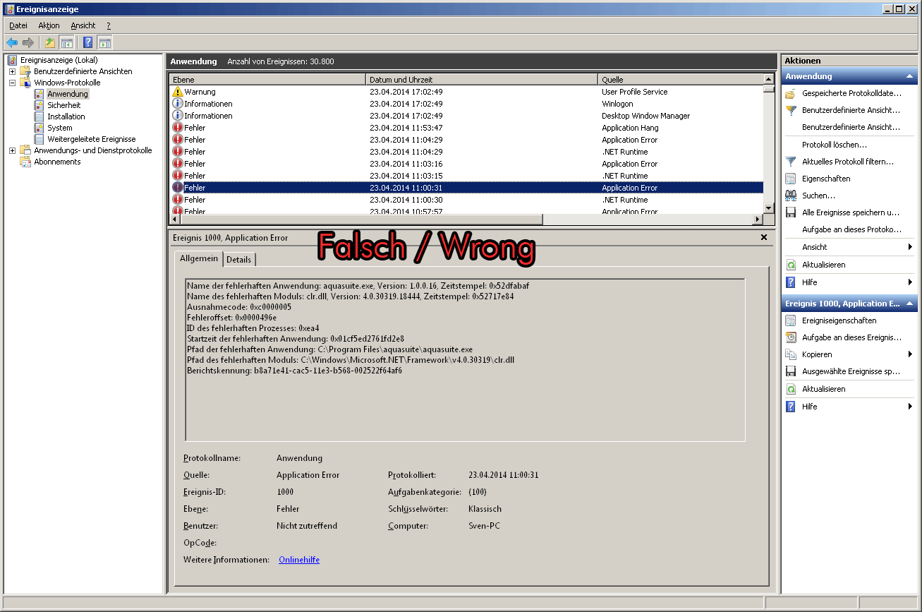

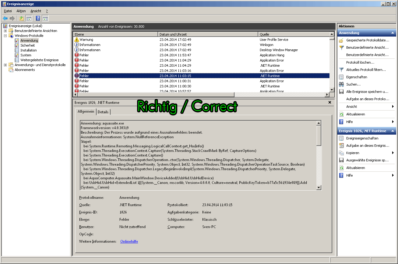

For the crashes in the software it would be helpful to provide the error logs from the Windows event viewer. Each crash creates two reports but we only need the extended one:
[attach]5481[/attach] [attach]5480[/attach]
