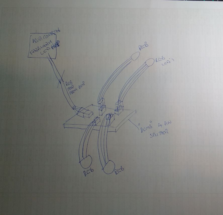

I know I will need 470 Ohm resistors on the R, G and B tails from my common anode LED bulbs that I plan to run from the Farbwerk.
My question is if I run a setup like the picture below, will I need a set of resistors on all 4 bulbs or just one set on the feed from the Farbwerk?
Dieser Beitrag wurde bereits 1 mal editiert, zuletzt von »Blade Runner« (13. November 2015, 17:01)

Thanks for the reply George,
I have got common anode led's, Shoggy told me to get them a few months ago :)
I have a few of them working from my farbwerks in another build.
My questiuon is can I just use one resistor on the R,G & B wires on the feed to a splitter box.
At the moment I have the same setup but with resistors on all the led's individually, the only reason I ask is so that I can make the sleeving neater when it does not have to fit over resistors.

wa3pnt
Samstag, 14. November 2015, 22:52
Thanks for the clarification.
I'm sorry that I cannot answer your question, as I've not tried multiple LEDs in the configuration you're asking about.
I'm certain that someone must have tried the single resistor on the common lead, and can reply.
