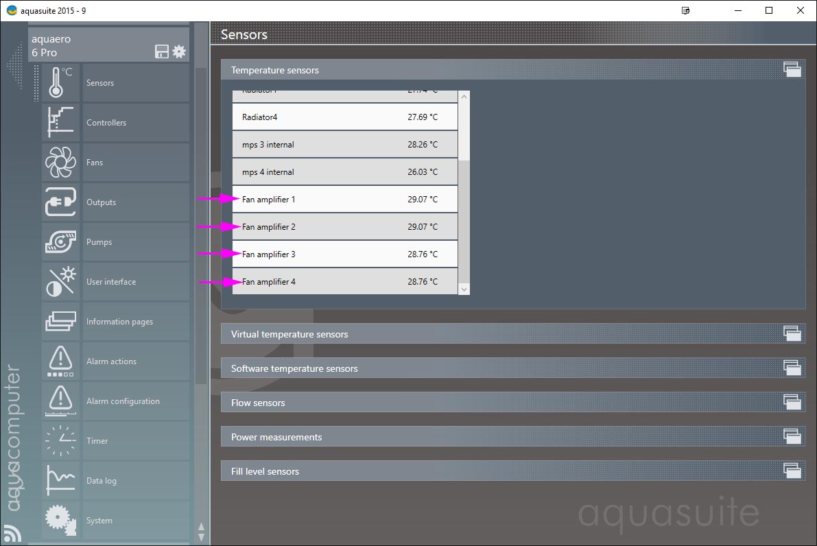

Dienstag, 5. Januar 2016, 04:42
You can see your Fan amplifier temperatures in aquasuite under the aquaero > Sensors tab.

flyoffacliff
Dienstag, 5. Januar 2016, 22:19
[attach]5538[/attach]
Cool. Does the Aquaero 5 show the temps too, or just the 6?

Mittwoch, 6. Januar 2016, 04:23
Yes, the aquaero 5 and 5 LT show the Fan Amplifier temps also.
