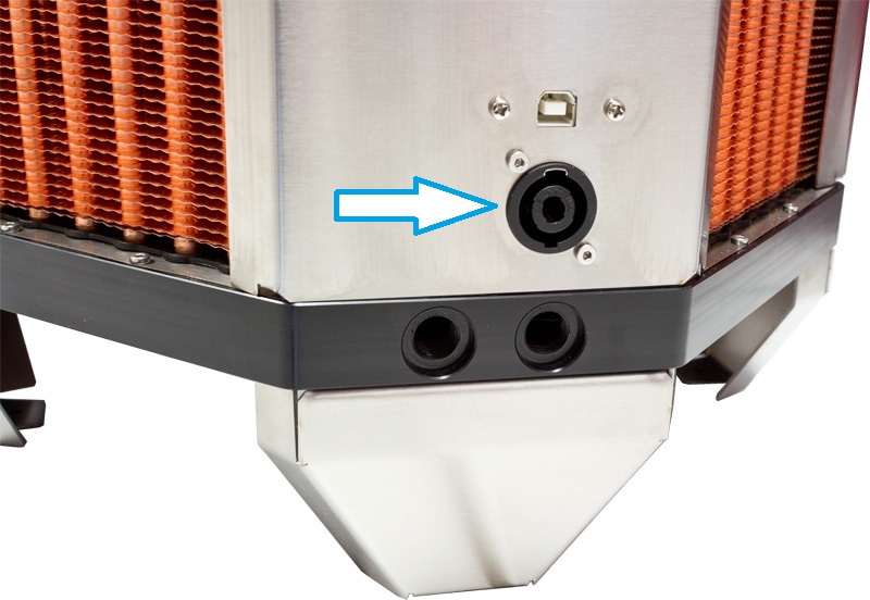

Also, with the aquaero version, so do I only need an usb cable to power it?
I cant see any other power cables going from it.

i think a D5 or DDC should run your system properly. once the system is filled only the flow of the pump is important.
you need to power up the aquaero in this gigant. but the power cable is delivered with this MONSTER! 8)
power supply-connector is below the USB that you can see on the picture. :D
»water-noob« hat folgende Datei angehängt:
  • 33306_4.jpg (111,71 kB - 180 mal heruntergeladen - zuletzt: 24. Februar 2026, 19:55)

I'm not sure a single pump would be enough, so 1 in combo with the airplex and 1 in the case, would be the minimum, I think.
It comes with its own power supply?
Or is it just a cable you connect to the PCs power supply?

What type of power cable does this thing comes with?

I have the non-aquaero version of the 3360 so in first place I couldn't tell. But I found this:
Looks like an Molex connection ;D

So in other words, same limitation as a normal aquaero then.
"Molex connector officially handles 11A = 132W"
132/24=5,5W
Guess I can use any fans I want :thumbup:
