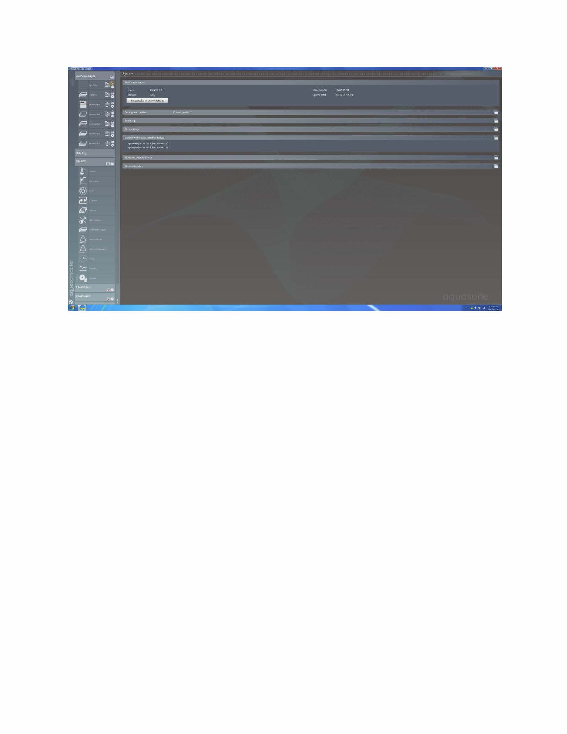

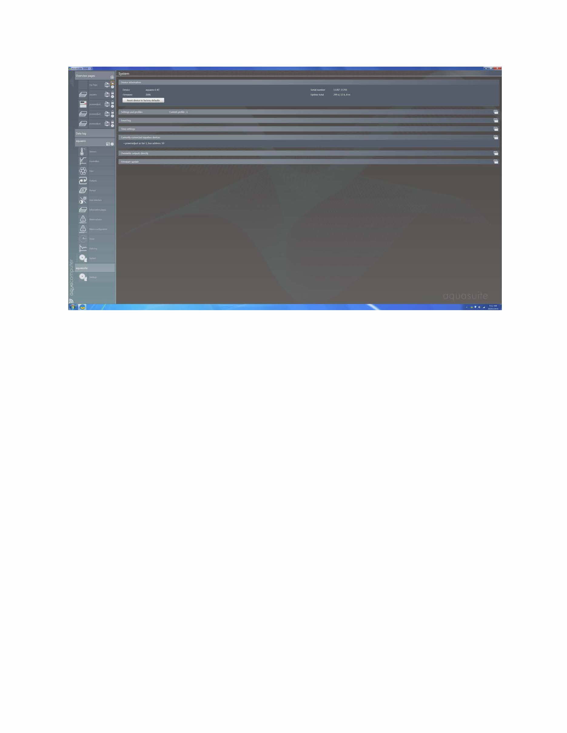

OK here are attachments, that's the only way I could upload them. I have try saving settings but no go.
This is by far the longest I ever spend on trying to configuring either software or hardware on my PC :(

I still don't think your address assignments have been changed. Please plug in all three via usb only if you can and show the address assignments for each. If you can't do all three, one by one is ok.
The image above has the default address. Don't know if that's what it's supposed to be but I want to see the change.

The image I posted was when PA3 was connected via USB before I discovered that the only way I can see PA3 under devices connected via aquabus when I would use 4pin cable .Now when I use 4pin cable to connect directly the first PA3 to aquaero it works, but now if I connect 3pin cable that is connected with the first PA3 (daisy chain) to the second PA3 they both get disconnected.
They both have different ID's that I have assign while they were connected via-USB I can only do 1 at a time I don't have a slitter, but afterwords if I use that 4 pin cable and connect each of those 2 PA3 individually, they show under devices connected via aquabus and they have different ID ...50 and 51 I can make screens of it but that's exactly how it looks, something strange when I try to daisy chain them
Things go wrong when I try to daisy chained them, what cables are you using, that really shouldn't make huge difference, it seems if I use 3pin that came with PA3 nothing works i have try different 3pin cables, same thing ?(

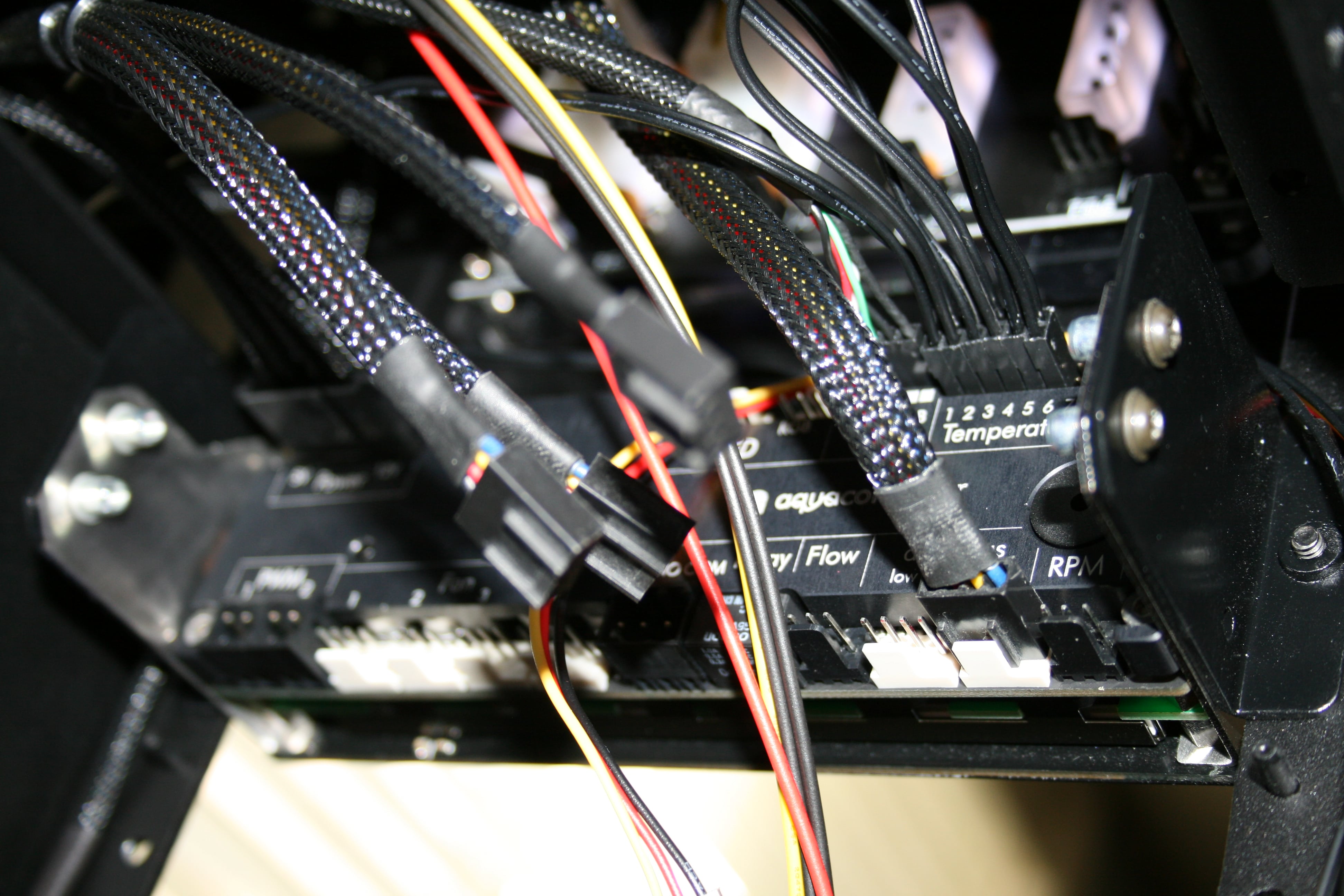

Any chance we can see how you physically have it setup? What cables, etc.

OK sorry for taking that long.
I hope you can see the images and what they represent I have named them. Basically If I use 4pin cable directly to PA3 from aquaero it works as showing and it shows different ID from the other PA3 under devices.
If I use the 4pin cable to connect to splitter and than connect PA3 to that splitter with 3pin cable its not showing, if I connect 4pin cable again directly to the PA3 and try to daisy chain from that PA3 with supplied or my own 3pin cable them they are not showing at all.

Well, Its finally done and I can say it all works as it should.
For minute I was second guessing myself. I'm not an expert by any stretch of imagination, but I figure, this should not be a rocket science unless I'm really not grasping simple procedure.
I have a few of aquacomputer cables and some of my old cables that I did for my system, maybe year ago that I forgot about.
I connected one of my old cables (3pin) boom, it works I use 2 more of them (3pin) daisy chain the 2x PA3 and all works great.

;( I'm going to humble myself and say this..admitting when being wrong its hard in today's world, but it has its benefits as well. My own ignorance made me waist 2 days trying to figure this out and yes the outcome was the cable, but that's not aquacomputer cables fault at all, it was purely my wrong doing.
I just know this something that cut my eye when I was looking at the ends of the cables before connector and I felt so X( and at the same time :wacko: Ive done custom cables for a long time WTH.... I'm really getting old and clumsy.
I think it might have been out of rush (maybe that's just an excuse :D ), when I was customizing the aquacomputer cables I put the darnnn terminals backwards in to the connector :evil: and I just realize I did that to all my cables when I have cut them, put new terminals and hit shrink them...OMGI feel dumb now, all this time and I was even trying to blame AC cables I have to sent an email to Shoggy and apologize as it was purely my fault ;( :)
