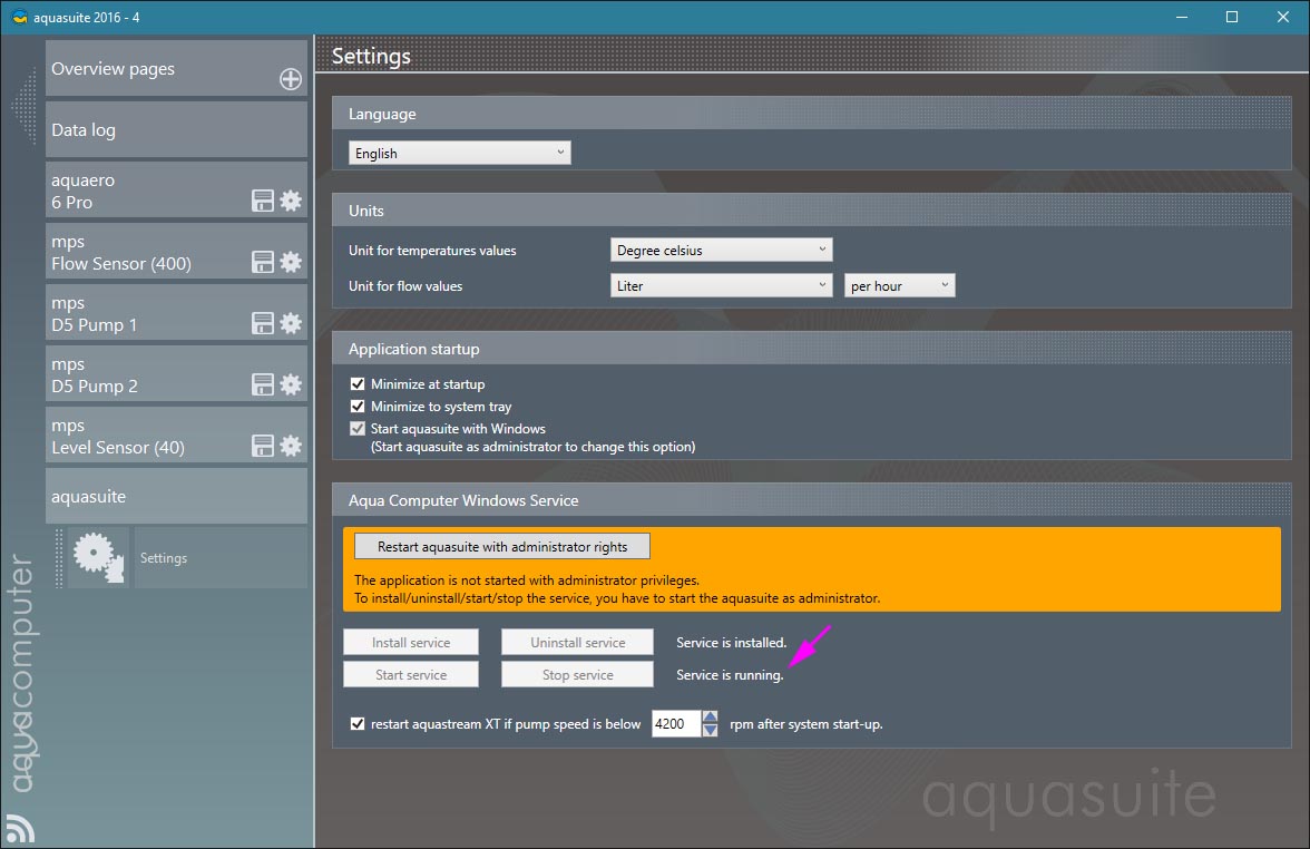

i have a little problem,
i'm using open hardware monitor 0.71 beta,
i was with windows 8 and the aquasuite 2016-2 allowed me to read values, no problem.
then i went to windows 10 and the aquasuite crashed everytimes i wanted to select a source.
i updated to the latest 2016-4 this morning and tried again...
no crash but this time i have no source to select from.
i reinstall the service and restart it from the aquasuite setting panel but no luck.
any idea ???
check the screenshot below.
thanks

You might check to see that Windows Services is installed and running.
When I installed 2016-4 I had to manually activate Windows Services.
You may want to switch to HWiNFO for your external source source (free). Open Hardware Monitor has not been updated for a year and a half... HWiNFO's last update was 3 days ago.

the service was indicated running, before and after i reinstalled it from the aquasuite.
I just reinstalled my windows with full wype, i just installed aquasuite, so let's check...
anddd it's working for now.
and my hardware is quite old (i7 2600k with gtx 770) so open hardware monitor is good for me, but if i change i will surely look for HWinfo.
thanks anyway.
