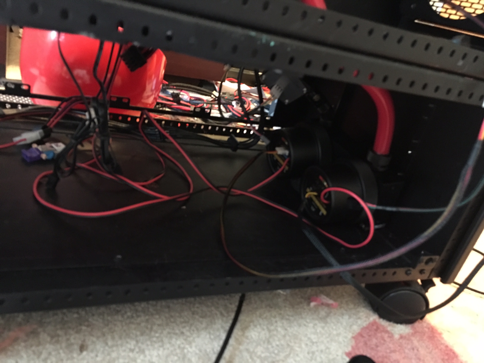

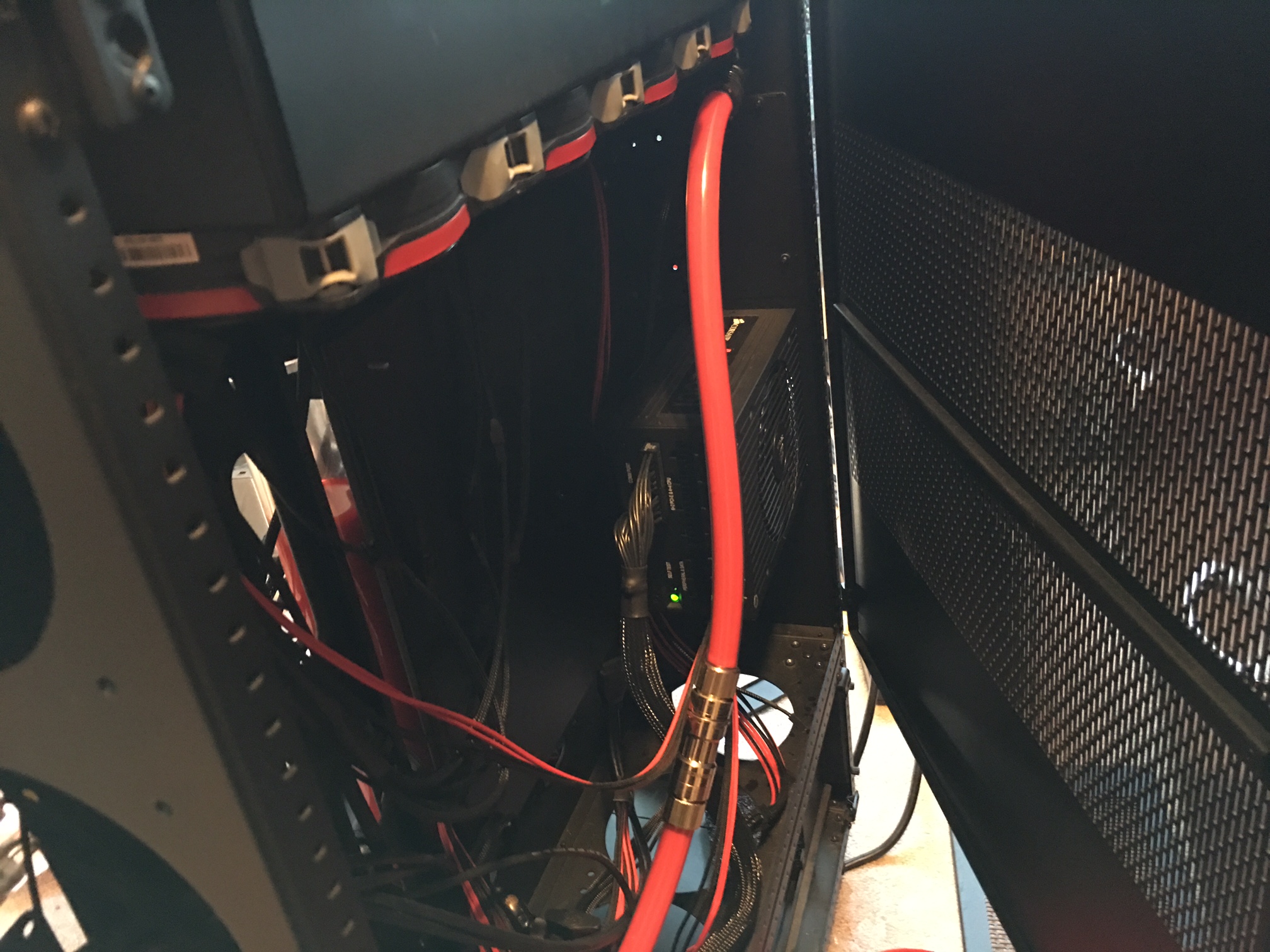

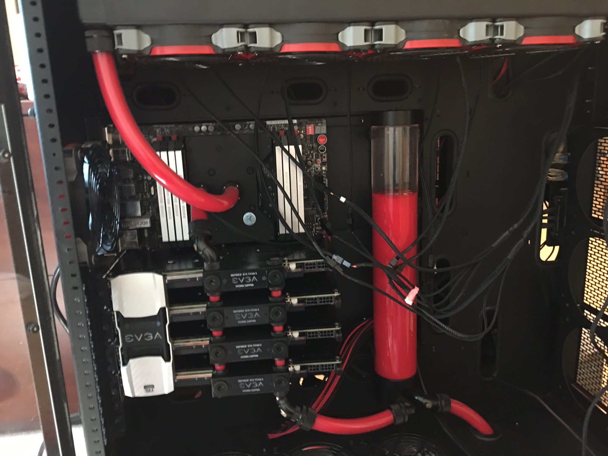

Sure
rampage v extreme board
ek combo cpu/mobo
4x Titan X Hydrocopper, connected with crystal link
bitspower fittings
bitspower dual d5 top
1 koolance quick disconnect in back
EK tube res
2 x http://www.performance-pcs.com/aquacompu…-interface.html
2 x XSPC 480 rads http://www.xs-pc.com/radiators-rx-series…fan-radiator-v2
Flow meter - http://shop.aquacomputer.de/product_info…roducts_id=2294
»tommyt« hat folgende Dateien angehängt:

Montag, 29. August 2016, 01:28
Sure
ek combo cpu/mobo
bitspower fittings
EK tube res
In Image 1 & 2, I see the return line from the GPU cards going to the inlet of pump 1, but cannot make it out from there.
Is it correct to assume the discharge from pump 1 goes to the inlet of pump 2, and the discharge from pump 2 goes to the inlet of the lower radiator?
With the 4 GPU cards being in parallel, and a total 60 lph flow, each card is getting only 15 lph
