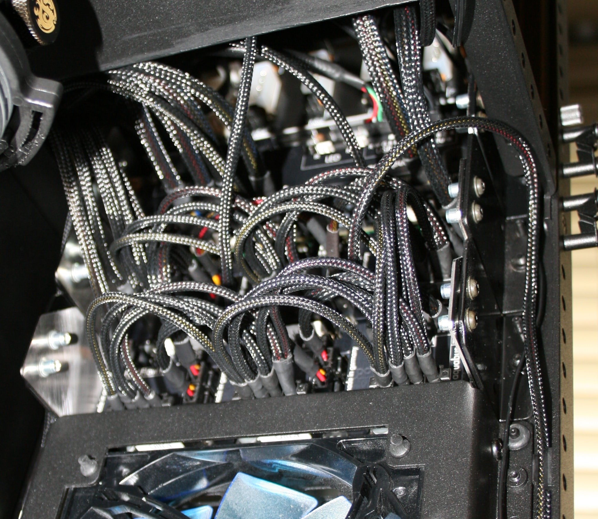

I remember maybe year ago I was seeking help here at the forum I had similar issue and after days of trying, many people reached out with help but unfortunately with no luck. Many of the cables were connected to few of my ModMyToys PCB splitters that where also powering 6x PA3 that where controlling 4 pumps, 2x High speed flow meters, 23 fans some LEDs and ultimately all that was connected to aquabus.
Now!!! how to find the issue among of that......after trying everything I possibly could I took all cables that where connected 1 way or the other to AQ and among all related components and 1 of the cables, don't remember exactly, had bad continuity, it wasn't constant disconnection, so 1 of the PA3's and pump was acting up at random times and then that would totally disconnect my aquabus, it was bad crimp. After changed that cable everything worked perfect.
