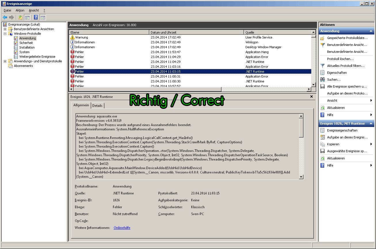

post or send us an email with the errors from the windows event log. this is the only way to solve the problem.

This is not the message that we need. Please check again. There should be a short error report (the one that you have posted) which is not useful for us and an extended one. This is the one that we need.
Two examples:
