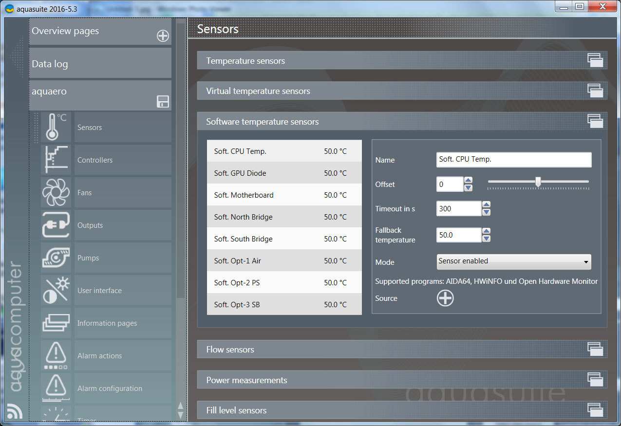

Hi;
I was using my Aquaero 5 Pro with Aquasuit 2015.9, and everything was working fine. I was able to import various Software sensor readings from Aida64. Aida64 and Aquasuit were both autostarting when Windows 7-64 started.
I got pestered to update my software (with a pop-up saying it was out of date I should update it), so I foolishly updated to 2016-5.3. Now I can no longer find any of my AIda64 sensor values.
I did an 'Aquaero/System/'Profiles and Factory defaults'/Restore selected backup to get back my previous layout (using the backup made during the Aquasuit 2016-5.3 software install). I then performed a firmware update (since it said I needed to).
After all this, my 'old' 'Software temperature sensors' show up, but aren't working (see Software-sensors.jpg). If I go to 'Source' I do not see any entries from Aida64 to select (see No-soft-sensors.jpg).

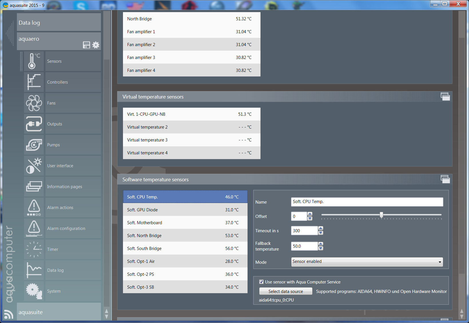

'Untitled-3.jpg' shows the old 2015-9 using software sensor 'aida64:tcpu_0:CPU', for example. The only thing that was changed between working and not working was the Aquasuite version. When that didn't work, I updated Aida64, which also didn't help.
