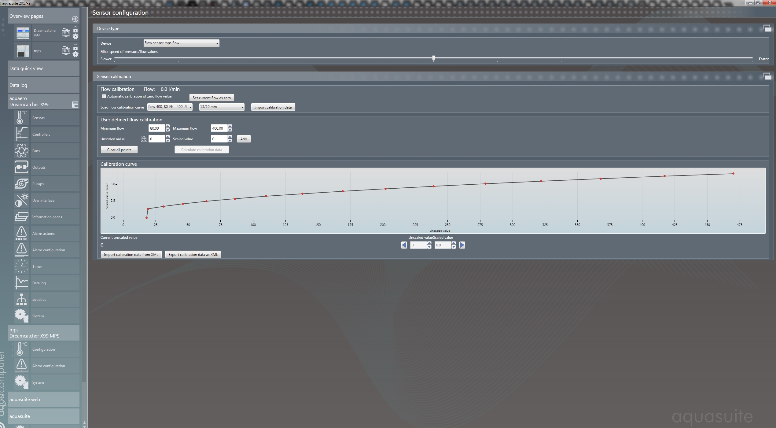

Hi guys
Can someone help me to calibrate Aquacomputer MPS400 sensor ?
This is reading when my pump is running at 1% or 1216RPM
There is 25 current unscaled value which I don't understand what this does mean,when I save that I'm getting 0 flow
EK DDC is plugged on channel 4
Thanks in advance,Jura

The "Unscaled Value" is raw data that the sensor is putting out.
At this point you do not need to concern yourself with that.
I'm working from memory due to being on my backup system (non-aquaero),
It should take 3 steps to load the default calibration:
1. next to "Load calibration curve", select the flow sensor you have (MPS400) from the drop-down menu
2. from the next drop-down menu, select the fitting size you have on either side of the flow sensor
3. lastly, click on "Import calibration data"
The calibration will not be perfect, but it should be in the ballpark.
The usefulness of the flow sensor is not to be absolutely accurate, but to show change over time.

Hi there
Thanks for reply,this I've done several times and still nothing,flow is at 0.0 l/m or 0.0 l/h,I've uploaded what I'm seeing,I'm seeing 0.0 l/m which is very strange and tried to unplug Aquaero and downloaded older 2016 because seems this sensor is licensed only for 2016 and Aquaero is for 2017
Thanks again for yours help
