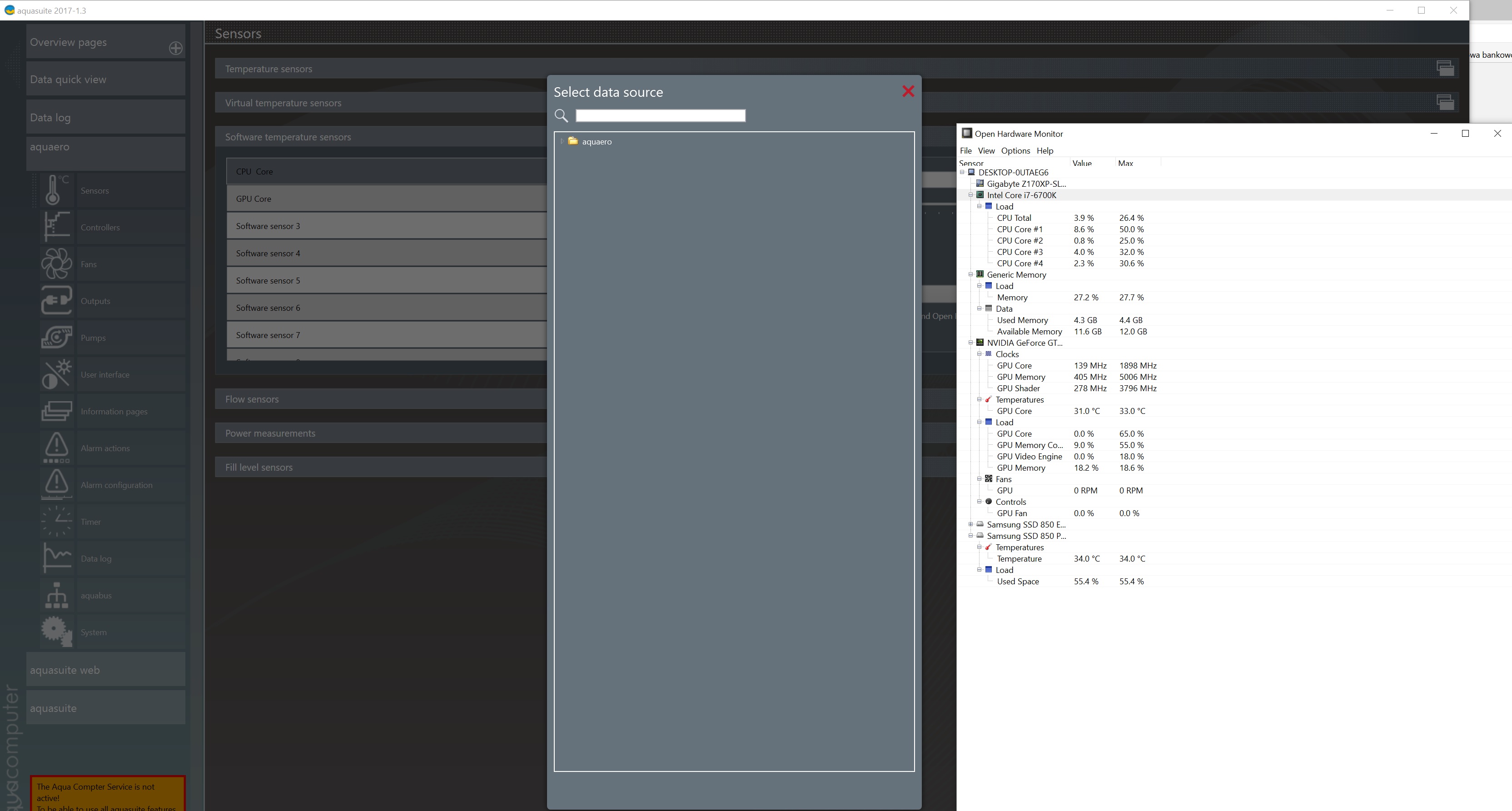

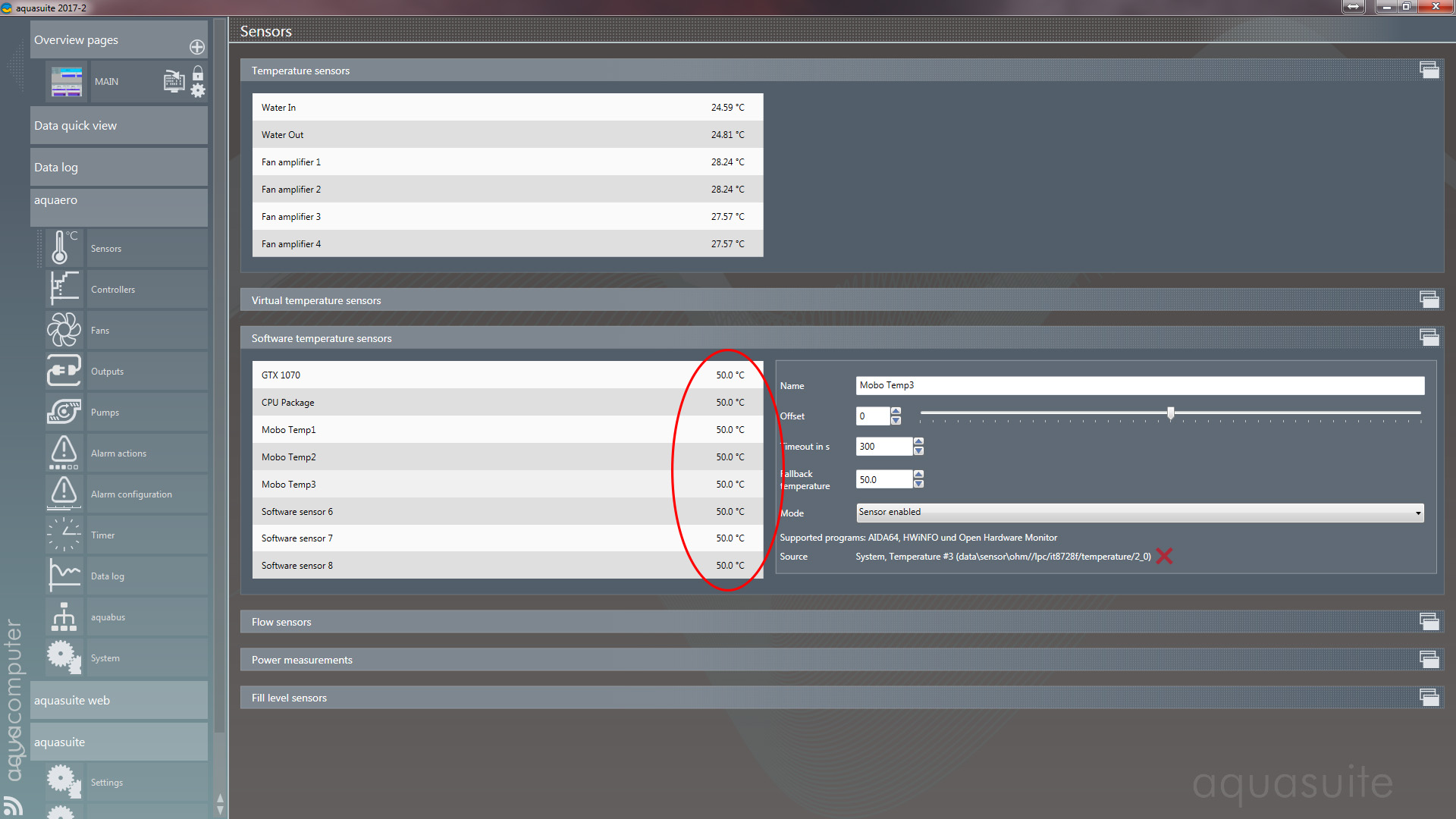

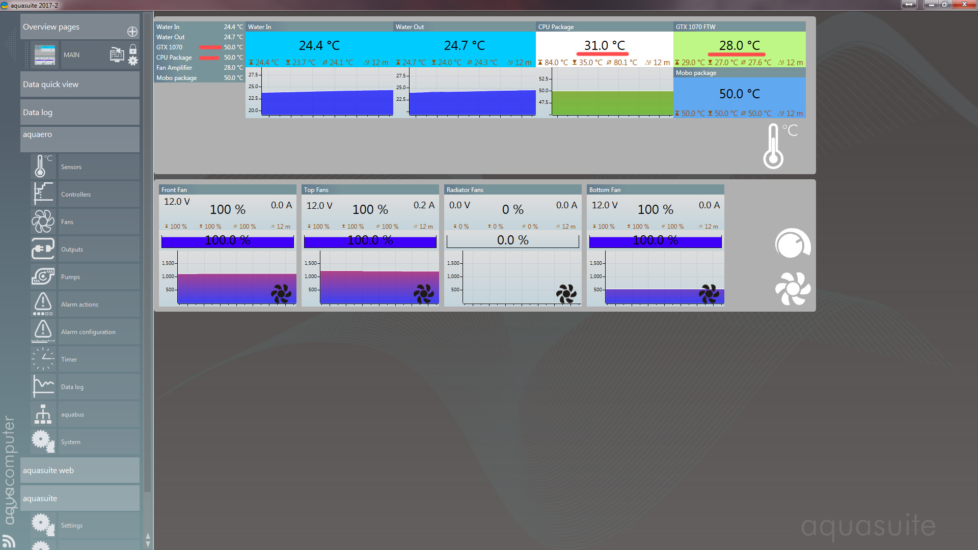

however, on my main screen cpu and motherboard temps are displaying correctly in 1 section and then as 50 degrees in another. when i go to 'select data source' then 'open hardware monitor' or 'aquacomputer hardware monitor' the temperatures are correct. If i select the data source the temperature stays the same but the software thinks that the sensor is reading 50 degrees.
heading into the sensors section of Aquasuite shows that all the software sensors are displaying 50 degrees even though the main screen shows them to be working.
Even more confusing is that this is intermittent. on the odd occasion everything will work perfectly however more often than not i just get 50 degrees.
Ive attached pictures to show what i mean. everything has the correct data source assigned and open hardware monitor is working and running.

Looking at your 2nd screenshot, you have "Mobo Temp3" selected, and the fallback temp for it is set to 50.00.
As the problem is intermittent, I would guess Open Hardware Monitor is not sending updates at times, and AQS is displaying the fallback temp when this happens.
You could use the HWiNFO program to drive your AQS Software Sensors instead of OHW.
HWiNFO is free and generally more reliable.

Yes I have the same thing.
I know where the problem is.... I just don't know how to fix it.
Aquasuite is not letting me use software temp sensors from other programs.
It has happened before, and suddenly it started working again.... but now it is not working for me.
See pics.

I just looked at your attached pic again and saw something I did not notice the first time.
Looking at the lower left corner of the picture, there is a red warning box that says "The Aqua Computer Service is not active".
That service HAS to be active to interact with HWiNFO, AIDA64 or OHM.
