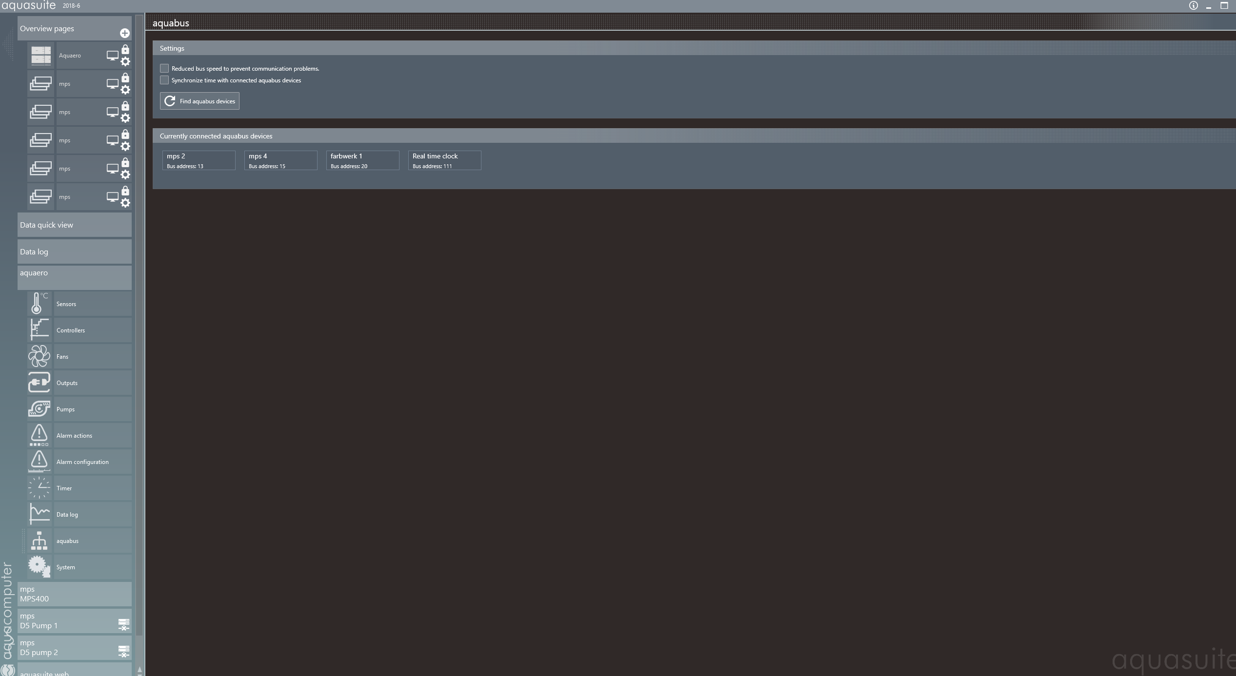

I power off the system and unplug all USb except the Aquaero and Plug all Aquabus devices using all 4 pin aquabus cable.

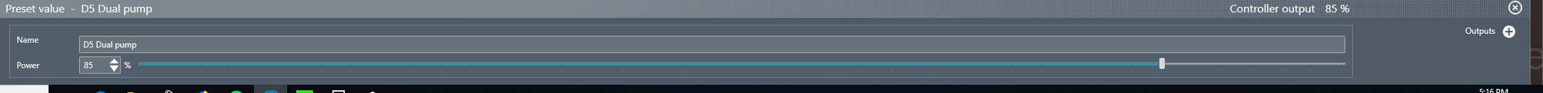

I used Setpoint controller on all fans while the 2 D5 USB Aquabus are on Preset controller.

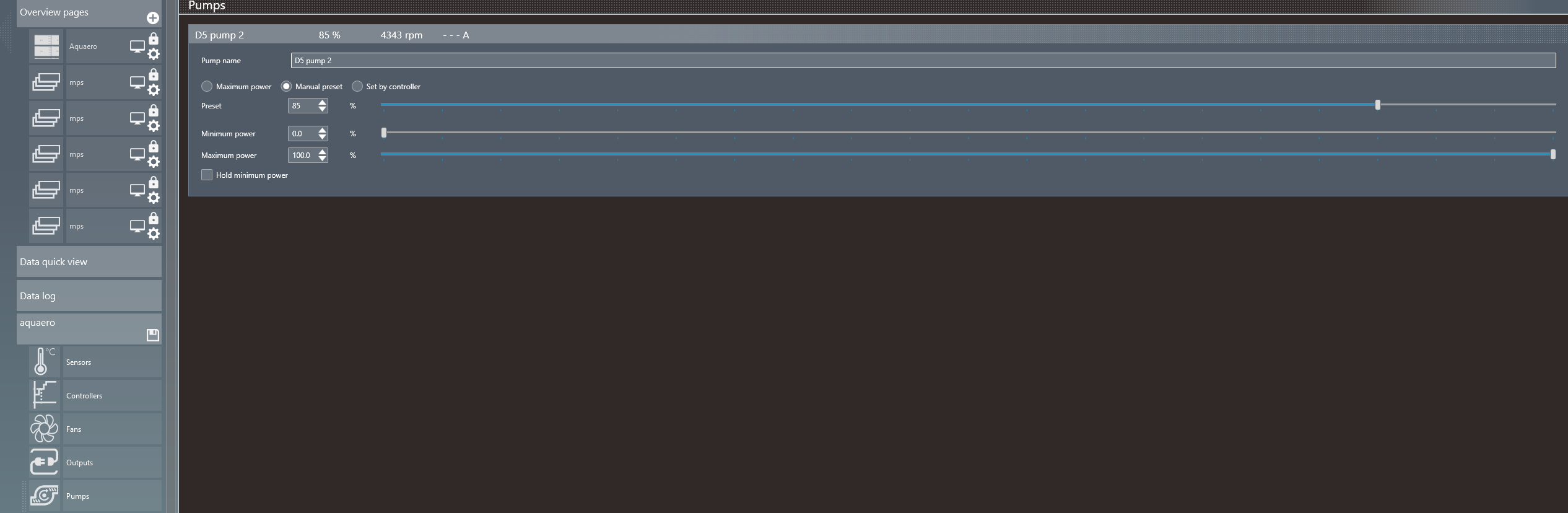

When I press the Pump icon on Aquasuite, It only show pump 2 and pump 1 is not detected on aquabus. (BTW I also set the pump by controller).
I check all aquabus device on the pump and it was assign to aquabus 13. (I know this is normal).

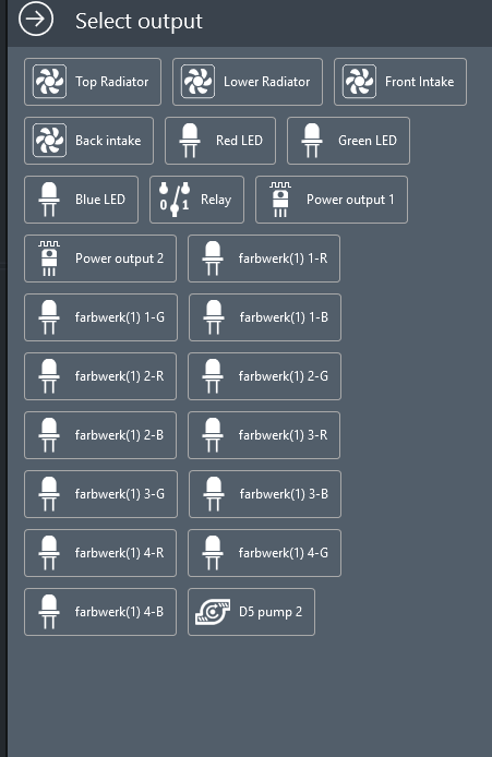

On the preset controller I set at 80% speed. When I select output there is only 1 D5 pump assign when before there were 2.
I check the pumps and they are both running.
On previous Aquasuite the pump icon used to have 2 pumps but the current one only show 1. Pump assignment on Preset controller show 2 pumps before and currently it is showing 1.

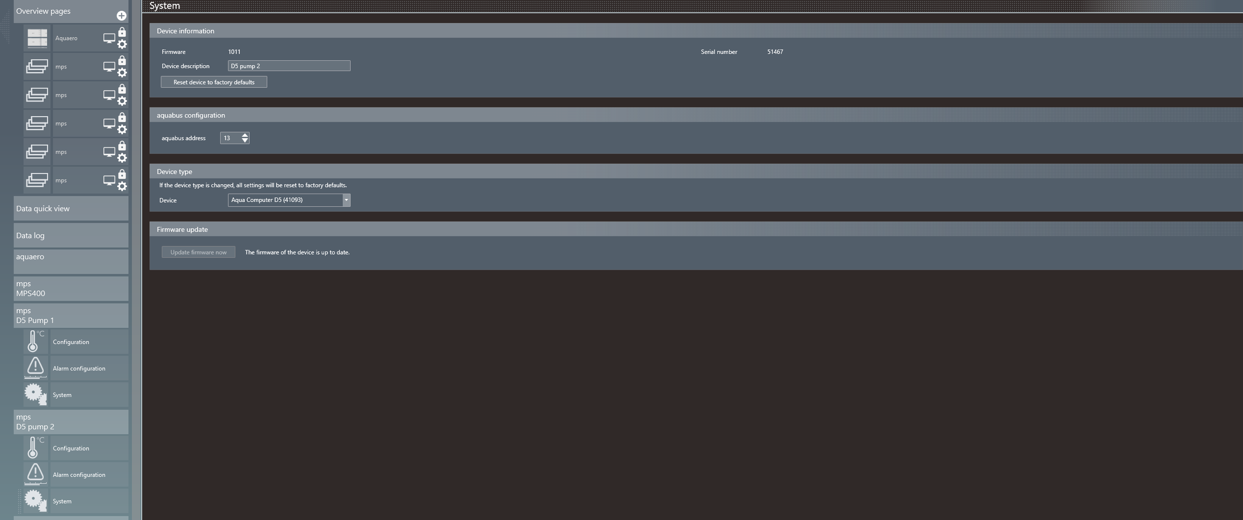

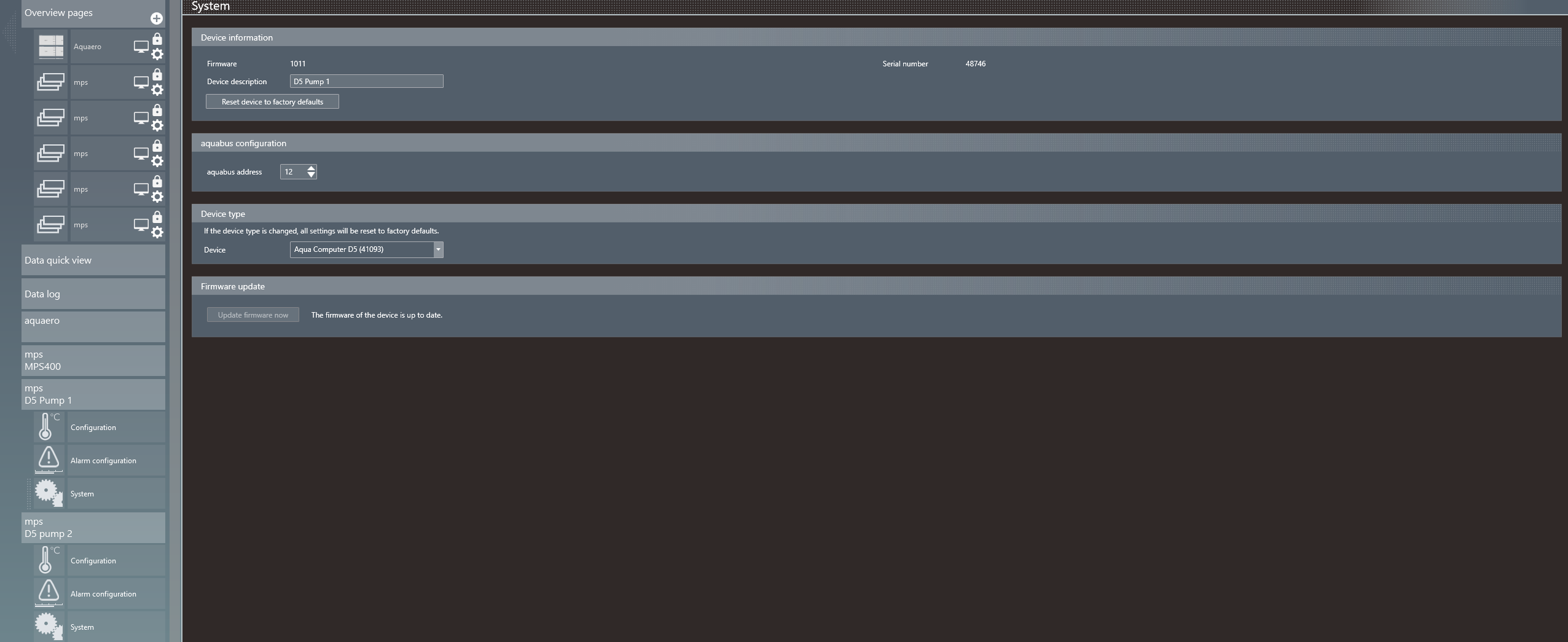

I factory reset both pump and assign each individual aquabus and it can only detect pump #2 no pump #1.
Pump #1 can be control via manual settings on USB.

From the screens we can see that one of the pumps is not being detected by the aquabus system. This is quite common when settings are changed or resets.
The normal solution is to remove all power from the Aquaero, including it's USB standby power through the USB cable. Then reconnect everything and power up again.
Make sure all wiring is firmly in the correct places too.
This should resolve the problem so when you look in the aquabus tab it will show the pump as connected again.
