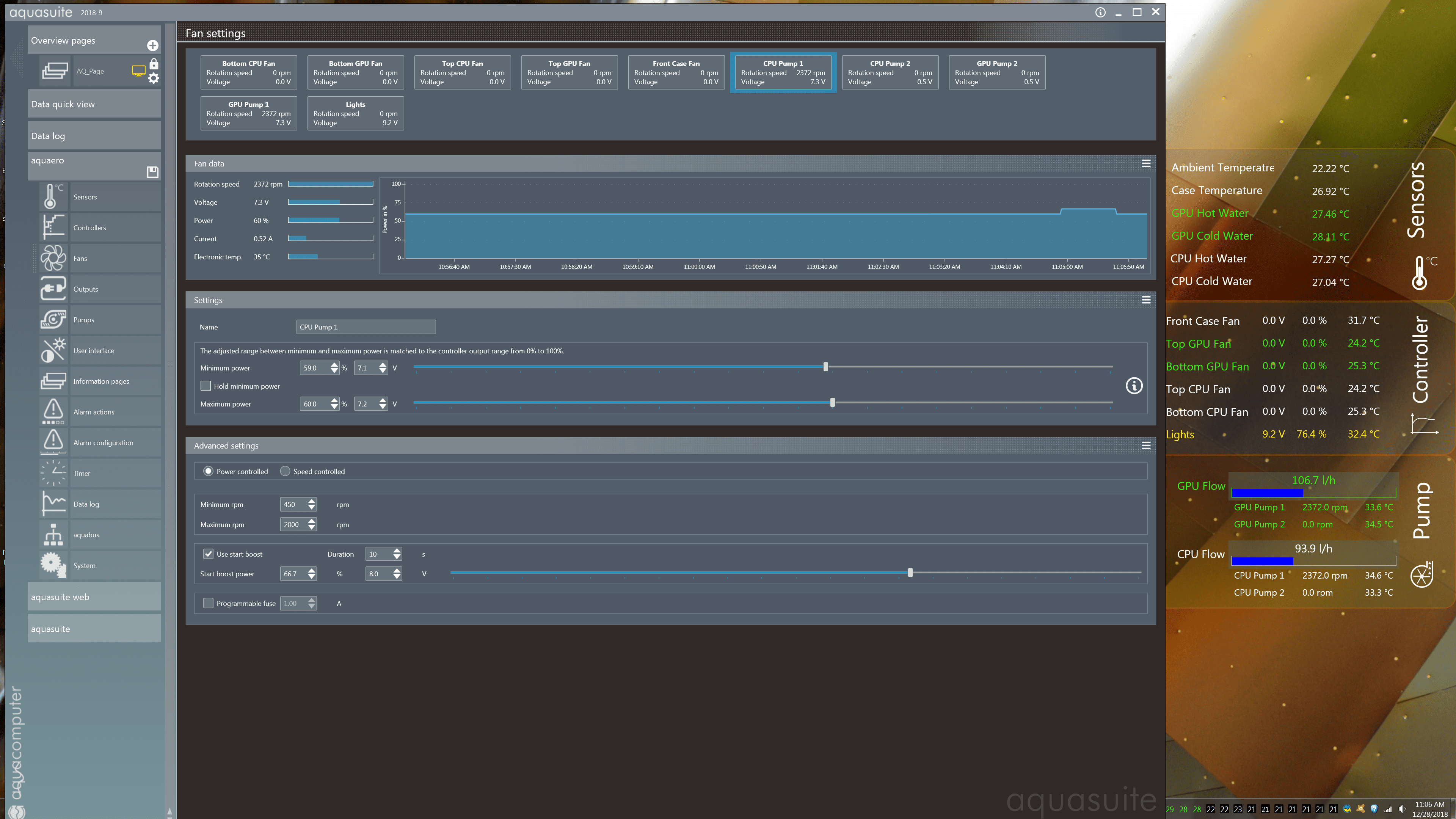

OK!!! here are some screenshots, I don't know if you need more detailed info with different screen shots but let me explain where I'm having the biggest problem, maybe I came across to aggressive and haven't explain the issue in clear manner.
My system is ON pretty much 24/7 with exception of Sunday, that's when I move collected data from that system onto external drives. The system runs very silently because I only run 2 main pumps on low (2200 RPM) and because I am not home most of the time that is one of the reason I have 4x D5 pumps (redundancy) to make sure that if any
of the main pumps loses power or simply dies, the secondary pumps will get enabled by alarm that suppose to load 1 of 3 profiles depending which pump failed and the secondary pump takes over as if nothing happens.
Also with 4 pumps I can initially bleed the system much faster as it is a big unit (4x 480 radiators, 3x GPU's, 2x High speed USB flow meters, 2 AQ filters) and all that is in BIG STH10 case with pedestal, so I need more than 2 pumps for reason.
So let me rephrase this issue…from the cold boot Startboost works, admittedly the delay is much longer then prior to this update so instead of me having to set "Startboost" to 7 seconds duration and 7.6v initial start then the pumps themselves go back to 7.1volt, now I have to set Duration to at least 10 seconds and 8-8.9v and that’s fine, I can live with that.
The bigger issue is with Startboost starting while system is running when the main pump fails and any of the 3 profiles are loaded. Normally I would have the secondary pumps set to exact the same settings as the main pumps which is 7 seconds duration and 7.6v to initially start the pump then the secondary pumps go back to 7.1 volt.
Now if you look at one of the screens the GPU flow is 0 and will remain 0 until I either move the voltage to 8-8.4v so the pumps can start, but then they will remain running that voltage oppose to slowing down after Startboost initial start and that's when the Startboost don't work when the profile is loaded and you can see the Startboost its set to
max voltage and I can even set to 20 seconds duration it still won’t start when certain profile are loaded and this was never the issue, this was always working great until I updated this time around, so there is a change that negatively affected this function which now doesn't work at all.
Like I mentioned, this works fine via USB connection, the issue exists only over the Aquabus connection.
I’m hoping that I made this clear enough and I’m also hoping somehow this will get fixed, unless you keep persisting that there is no issue and if that's the case I can’t force you to make it to work the way did prior to this update.

Freitag, 28. Dezember 2018, 09:14
Screecshots == PNG or JPG, pdf are for texts and documents.
Your Screenshots are not readable. (blurry)
The Startboost works with the aquabus as designed.
The Startboost is ONLY applied when the power is 0 to x.
The problem ist the option Hold Minimum power. Disable this.

Sorry I was trying to do this remotely, hopefully this will be better of help..
FYI. The Poweradjust that is starting the secondary pump is OFF so there is no power or should I say there should be no power on that unit, yet.. when the specific profile its loaded,don't matter how I will set the settings startboost won't power on that PA3 and as I said before this was never the issue until this update. We going circles again, you saying there is no issue and Startboost work as it should, but obviously something is not working correctly. I have already try "Hold minimum power" being ON or OFF before you even mentioned and that doesn't make any difference but again "Hold Minimum Power" ON was never the issue.
You can see on one of the screen shots when profile its loaded under "Fans" it shows that this particular PA3 receiving the power of 7.3V and normally that would run that pump nicely after Startboost would initially start this pump with 8v and now this part its broken.
If I didn't think that there was something wrong with this specific function of Startboost I wouldn't bother wasting our time, but I've been using this function for the past few years and I know how this have always worked and how this doesn't work now.
I'm not trying to be mean or rude it’s not my intent and if I come across that way I apologize. I want to get to the bottom of this so this it works as it did before this update but tbh. from the sound of your feedback I don't have much faith.
I should add... some times in rare occasions and it happen few minutes ago and also earlier today, the Startboost worked fine for split of a second, when I check/uncheck the "use startboost" Startboost did ramp up for the duration time but then don't matter what I did and I couldn't reproduce it again, so there is an obvious issue :|
