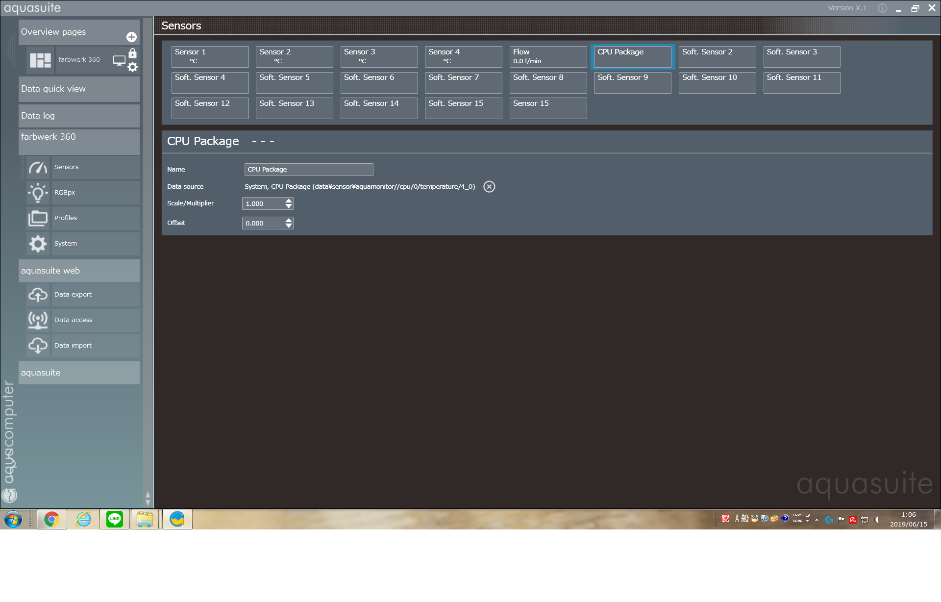

I can not set the soft sensor of ferbwerk360.
I want to reflect the CPU temperature.
I don't know what's wrong....
Please help me...
»tetla« hat folgendes Bild angehängt:
Please help me...
Use Windows 10. If you use windows 7 or 8 (not 8.1) the required device drivers not available.
