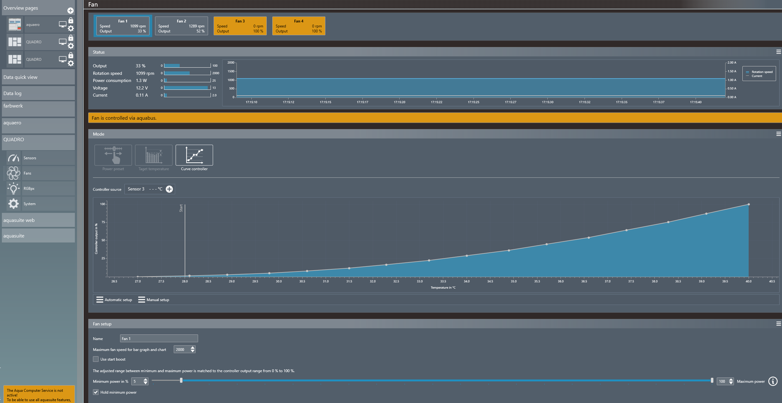

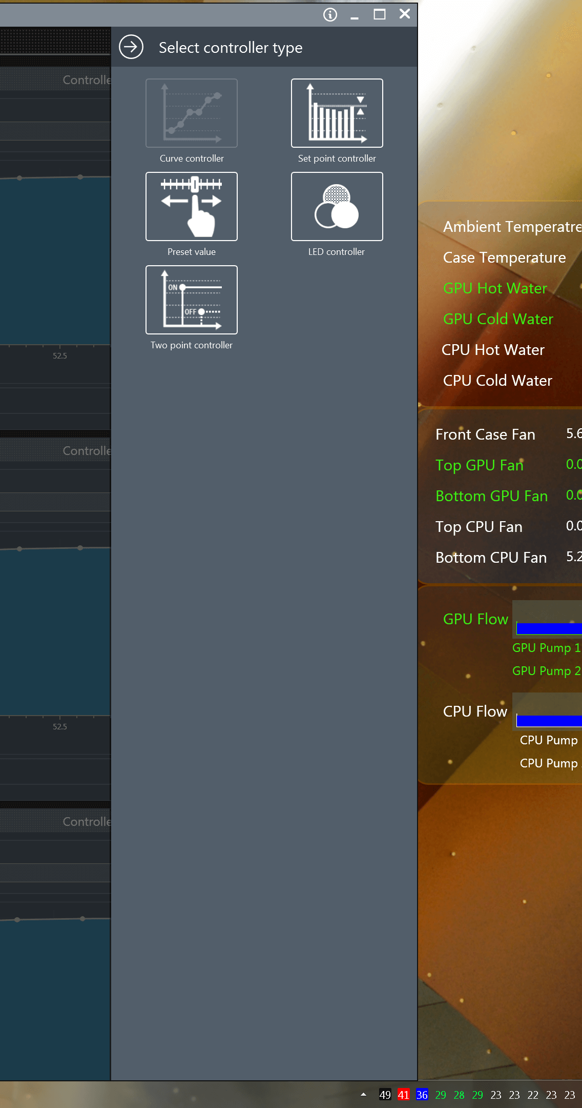

Atm. I have Aquaero 6 XT with 7x PA3 connected via aquabus and as we all know, Aquaero is limited to 4 Curve Control channels.
I am aware that I can still add Quadro to my current setup, but will adding Quadro also add additional curve channel. :)
Thanks

Doesn't seem to add an extra curve controller to the AQ6. You are still limited to 4.
Another thing is that once you connect it through aquabus to the AQ6, you lose control over the fan outputs through the Quadro and can only control them through AQ6.

Freitag, 12. April 2019, 19:24
I have it on both USB and aquabus and fan control is impossible through Quadro tab. It seems that only start boost setting affects it (seems to be a bug), but otherwise you can use the curves in Quadro AQ6 while it's connected through aquabus.
Dieser Beitrag wurde bereits 1 mal editiert, zuletzt von »vvv850« (13. April 2019, 20:29)

Freitag, 12. April 2019, 21:49
So, I disconnected the USB cable and the Quadro disappeared from aquasuite. In this case only the fan outputs can be controlled through AQ6 only.

vvv850
Samstag, 13. April 2019, 16:16
Dundys
Samstag, 13. April 2019, 17:57
Ooo I see, so even thou you disconnected quadro from USB it seem that it has its own tab. That image is quadro connected only via aquabus?
Normally when I connect PA3 via aquabus all PA3 tabs that where created while over USB can be deleted and everything is under Aquaero, but Quadro has its own tab regardless
Thanks I appreciate your effort
Dieser Beitrag wurde bereits 2 mal editiert, zuletzt von »Dundys« (13. April 2019, 18:00)
vvv850
Samstag, 13. April 2019, 18:08
Like I mentioned yesterday, once you disconnect the USB link from the Quadro, you lose it's tab in Aquasuite and have to control the fan outputs through AQ6 as usual (no RGBpx or anything except fans through AQ6). The picture above was taken with the USB and aquabus links bith connected.
