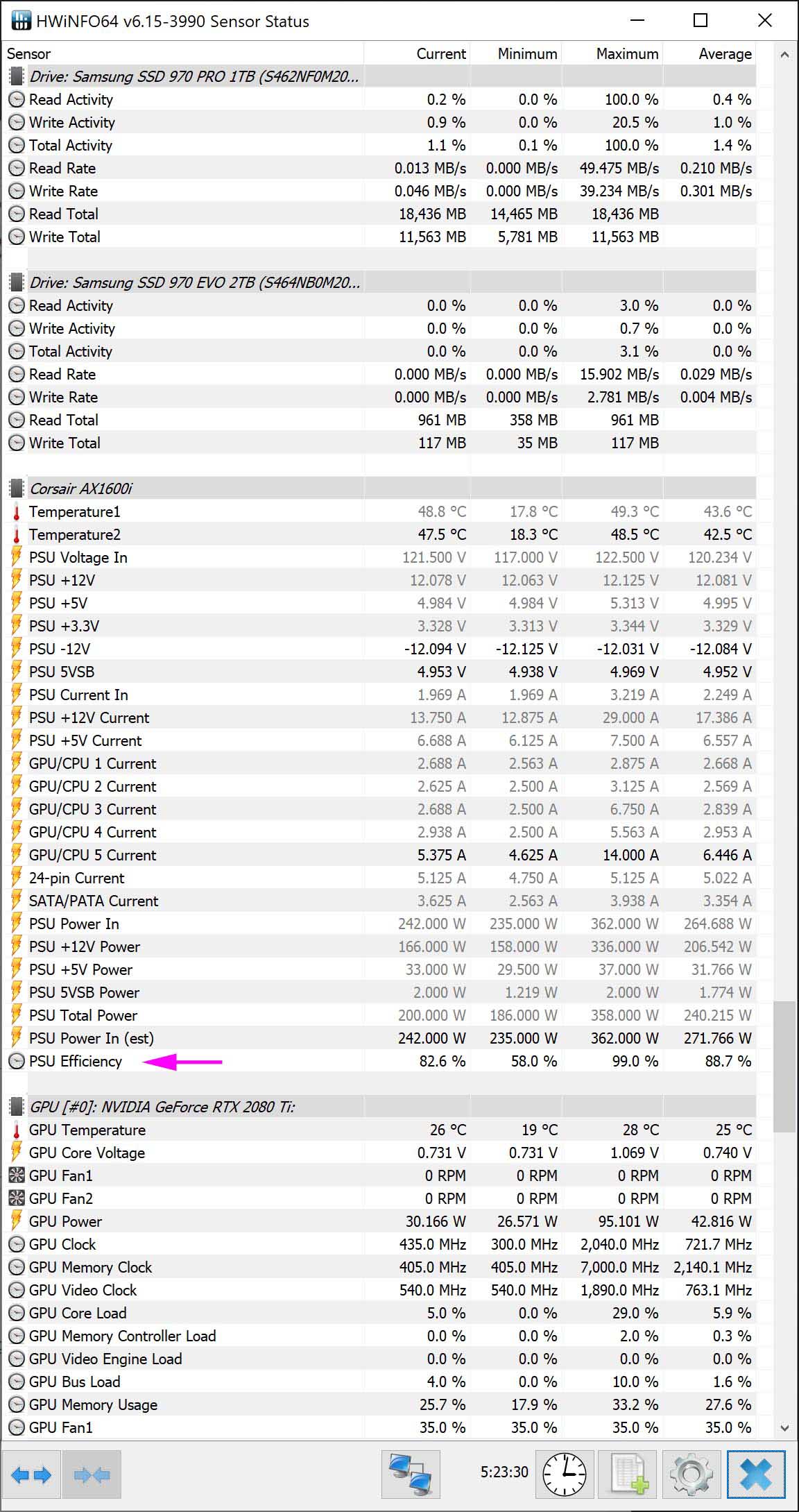

If what you are looking for is in the snippet below, then the answer, as mditch suggested, is the same as when you were pursuing this some time ago.
Why be a fanboy of a company that disses your requests, and then you go down on the one that has what you want?
HWiNFO is the superior product between it, AIDA64 and HWmonitor... and yes, I still have a license for AIDA64 also, but it will not get renewed.

Is that from HWInfo? I opened HWInfo (not Aquasuite mind you), and found nothing of interest.
Yes, the source is HWiNFO.
I updated the original snippet above with an arrow to draw attention to the sensor source path... you may need to reload the page for the picture to update.
The Corsair Link driver must be running, but the Link software should NOT be running... polling issues.
Snippet of the HWiNFO Sensor Panel:

[attach]7063[/attach]
Thanks!
