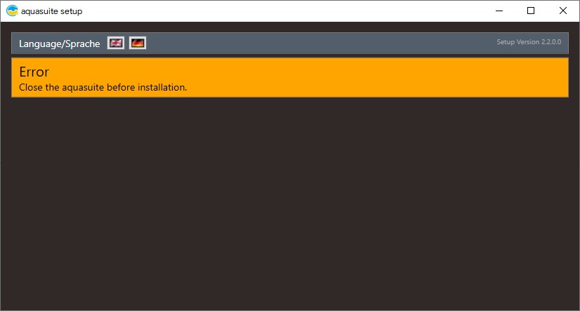

I've just bought Farbwerk 360 and RGBpx monitor kit, connected everything, started up PC, system discovered farbwerk 360, so next step I try to install aquacomputer software but everytime I try to run it it says "Close the aquasuite before installation". Never had to do with Aquacomputer software/hardware. I tried to delete the farbwerk 360 in Device Manager but it didn't help. I don't really understand what's going on. Any solution? I'm runing latest Windows 10 1909 x64.

No, there's nothing, except the aquasuite.exe process which is triggered by the installation file. I've never had anything from Aquacomputer, so it's impossible there might be something. I'm using ProcessHacker to check running processes, drivers and services and Autoruns to double check and eventually disable from autorun but there's completely nothing.
I've tried to disable couple of programs like HWiNFO, Argus Monitor, MSI Afterburner, Kaspersky, Malwarebytes Anti-Malware, before running Aquasuite.exe. Tried to restart, run in compatibility mode Windows 8. Nothing. It won't install :S

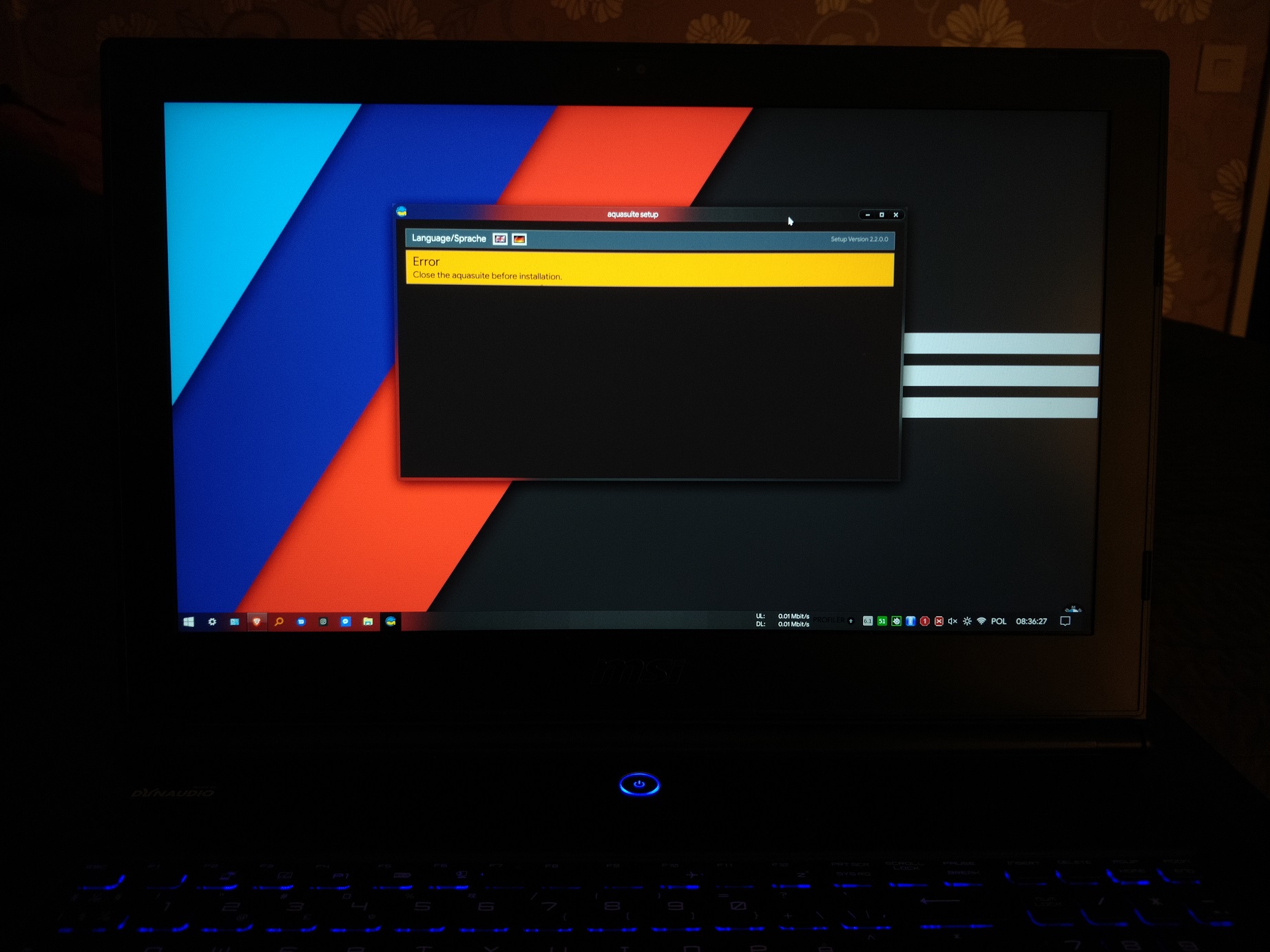

EDIT: I've just tried it on my laptop and the same shit is happening. The laptop is running Windows 10 1809. A proof has been attached below below.
EDIT: I've just tried to run it on a laptop of my friend and it works, but not detecting any Aquacomputer device. May I ask which service(s) does this software need to run? Maybe there's one which is disabled/stopped and need starting?
