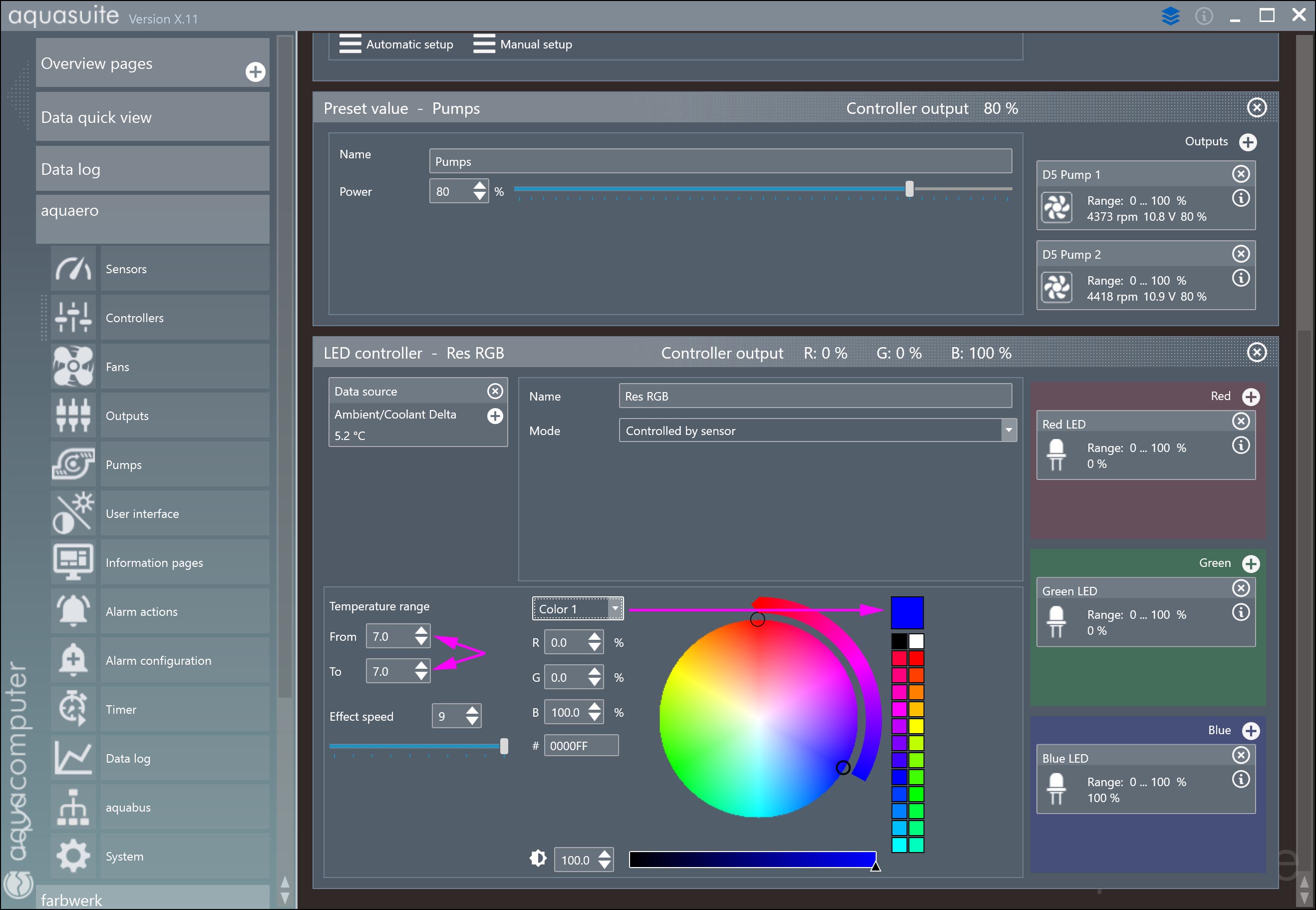

Actually, yes.
Set your temperature range from 8C to 8C and then set color 1 to blue and color 2 to red.
As long as the temperature is below 8C, it will show blue, at 8C+ it will show red.
Sample of my setup below (I have threshold set at 7C).
