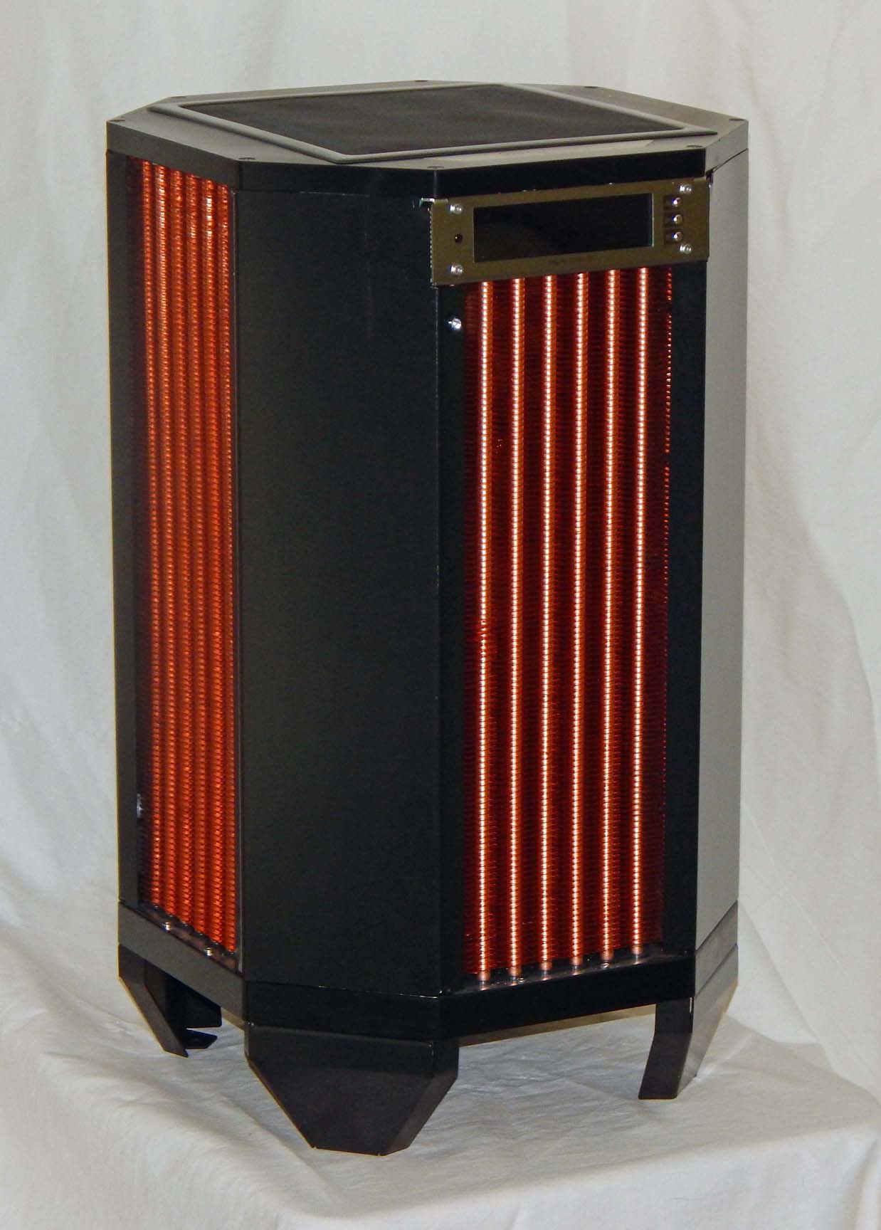

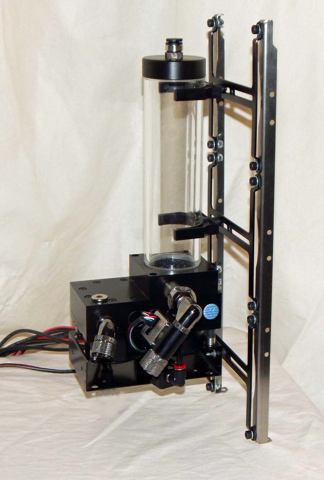

Here are two shots of how I did the pumps in my Gigant a couple years ago.
For Ss & Gs, I had the aluminum and SS bits anodized black.
Pro Tip 1: Place some pads on the bottom of the SS stands or they will rip your desk up.
Pro Tip 2: In order to remove the 4 aluminum side panels you have to remove the 4 SS stands in order to access the panel's bottom retaining screw.
I checked with aquacomputer, and they advised the side panels do not contribute to the integrity of the radiator, they are wholly decorative.
So after the initial side panel removal, I screwed the bottom screws into the panel from the inside of the panel, so the protruded out the bottom of the panel.
This allowed me to "stab" the bottom of the panel into the retaining holes in the lower end, and the secure it with the screws at the top.
This way the panels are removable without turning the thing upside down and removing the stands.
