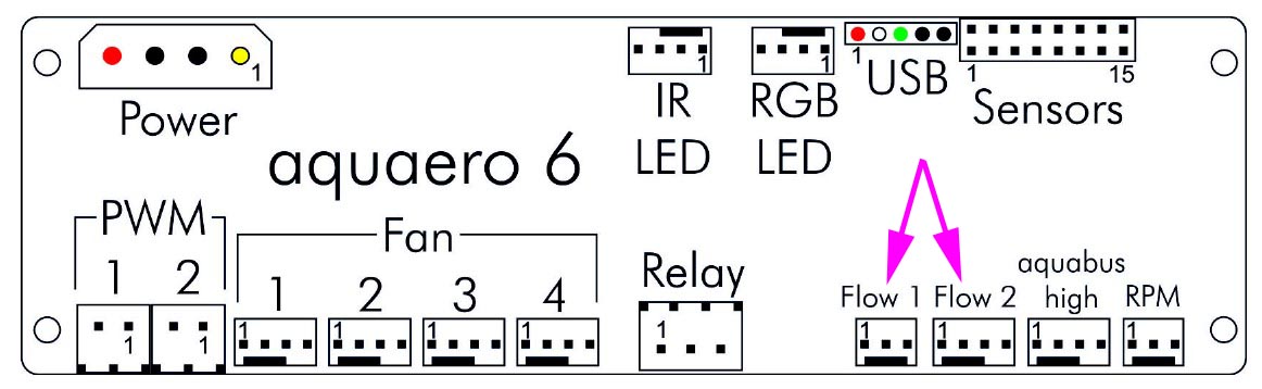

  • the aquaero now has 2 flow sensor ports (aquaero_flow_ports.jpg), plus the quadro has a flow sensor port

  • the aquaero now has 2 flow sensor ports ([attach]7283[/attach]), plus the quadro has a flow sensor port
  • OK

You only have what is available from Aquaero (notably 4 curve controllers only).
So, if i connect the OCTO to the Aquaero, i will see 4+8 PWM ports that i could control separately only from the Aquaero.
Aquaero doesn't have RGBpx capabilities so it can't see the led strip. However, i can statically configure them connecting the OCTO to the USB.
Am I right?
Yes, perfectly right. To be more precise, You would have 4 PWM/voltage connectors and 8 PWM only connectors avaible as Aquero ports (that is, Aquasuite software will display 12 continous fans without indicating whether they are from Aquaero or OCTO. You cannot neither change order of fans as they are displayed in Aquasuite.
As for RGBpx there is no possibility to control it via Aquabus and there will not be in near future. Aquacomputer are quite vague about this - so it is difficult to tell whether it is because of limited manpower or a technical impossibility.
In any case, buying the Aquabus cable for OCTO (53214) You will be able to test both setups (USB or Aquabus).
