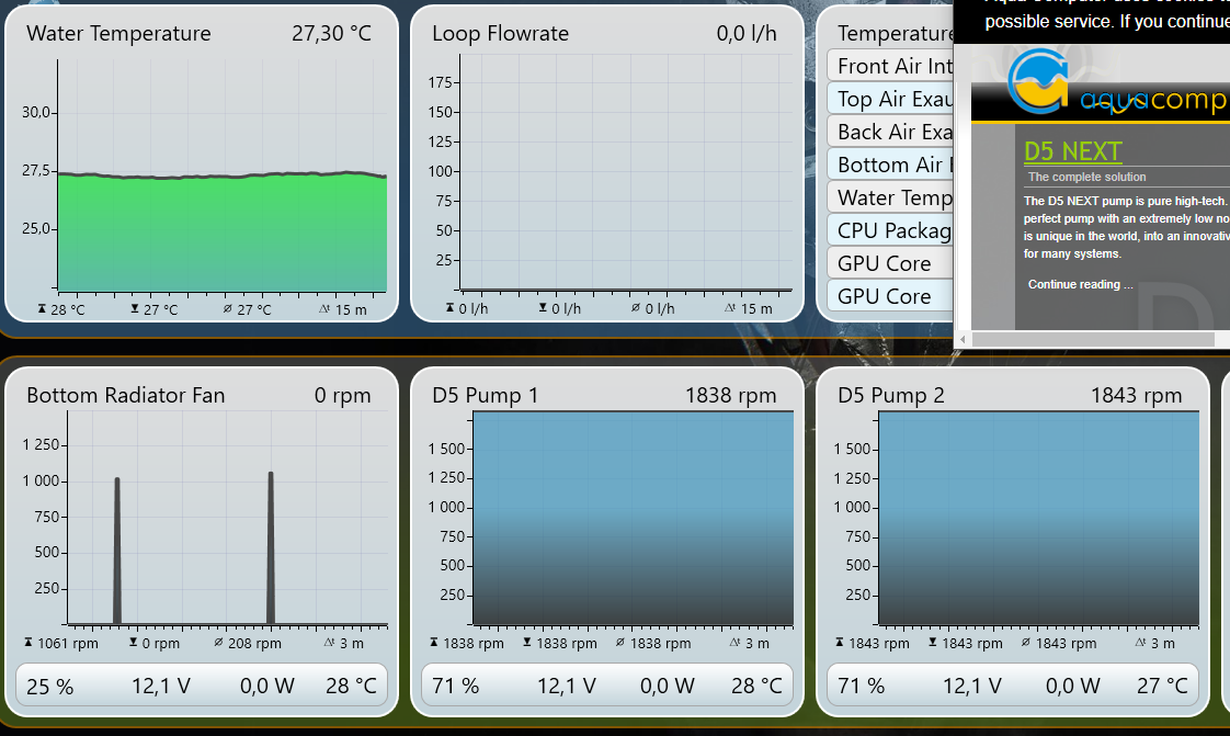

i just noticed that the RPM seems to come back sometime, for a split second, here a screenshot of my monitoring during a spike
Donnerstag, 30. April 2020, 12:53
connect for testing a other fan direct to the device without any y-cables or splitters.
Warmaniac_209
Freitag, 1. Mai 2020, 08:09
just did that, the rpm came back for a while, but was all over the place, when the fan was spinnign at a constant rpm, and now, its stopped working again, these are gentle typhoon 1800 rpm, not my high ones, and there is only one fan connected right now, and these splitter, i want to specify, has only one tachometer wire, the other one that goes on the second fan is not connected, there is only the PWM signal that is being transmitted..... but as i said this point is moot, the header still not work correctly after a full power cycle, and a new different fan alone on its header....
