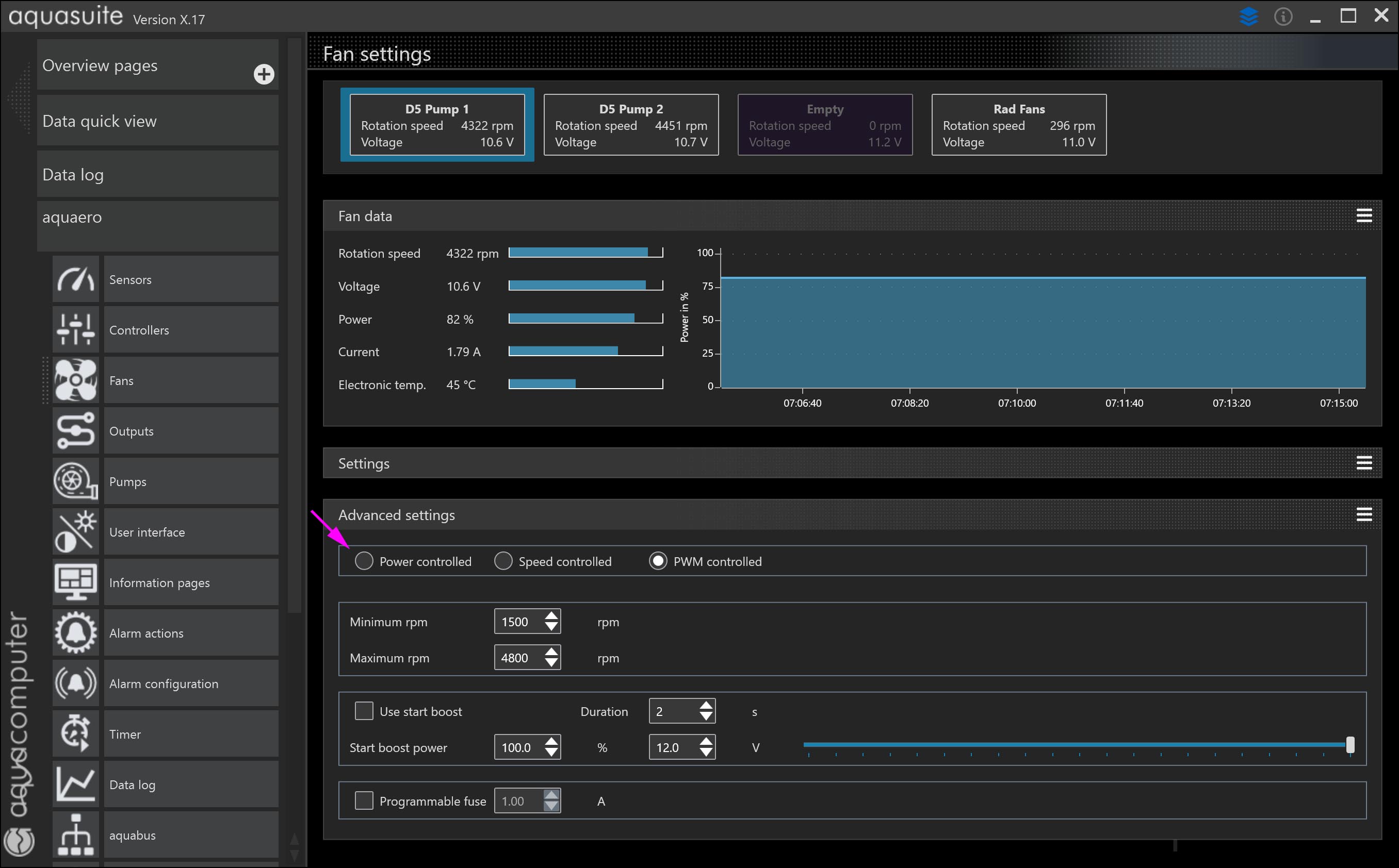

I may get flamed for suggesting this, but if you have the pumps and want to use them, this is an option:
  • remove the 4-pin molex plugs from the pump's power lead
  • replace with a fan style plug (3 or 4 pin), connecting to the +12V & ground pins
  • plug each of the two pumps into it's own fan port on the aquaero 6
  • set the vario knob on the back of the pumps to 5 (full power)
  • in the aquasuite set the fan port to "Power controlled" power_controlled.jpg
  • I recommend you install a Passive heat sink for aquaero 6
The pumps are rated at 2A
The aquaero 6 fan port is rated to 2.5 amps, so you would be running at 80% capacity.
CAVEAT: all modifications are at your own risk... if you are not familiar/comfortable with this process, do NOT attempt!

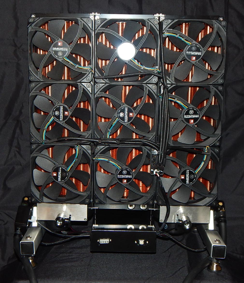

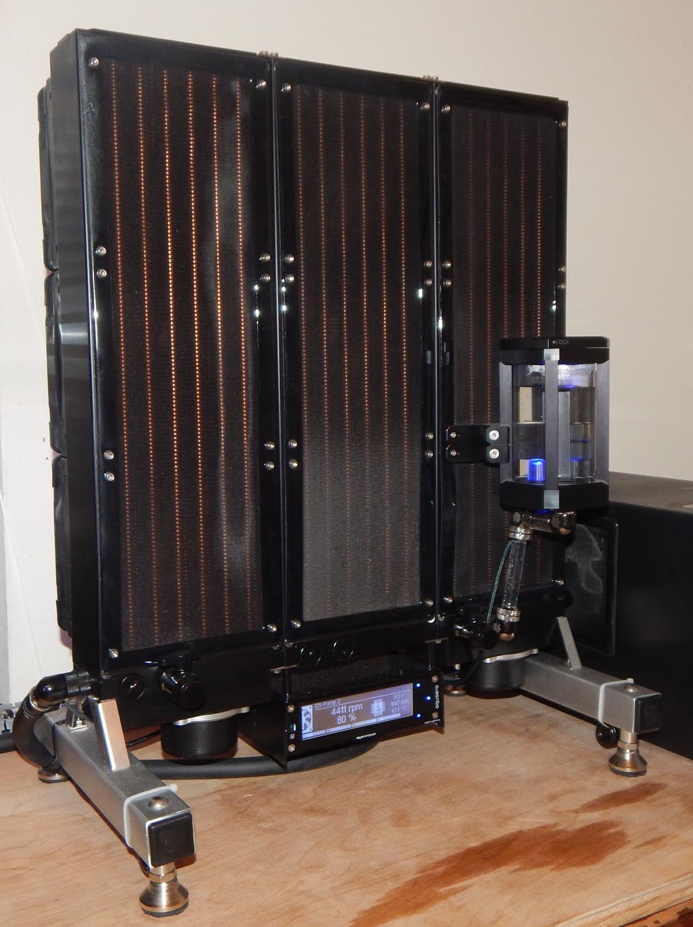

I am doing a similar thing on my external radiator, but with PWM pumps (set at 82% with a Preset Value controller).
I have two Aqua Computer D5 PWM pumps and an aquaero 6 XT on the bottom of the external radiator. radfrt.jpg
I decided to place the pumps' power leads on the PWM connectors to minimize cable clutter. radbak.jpg
The pumps are pulling less than 1.8 A. (the 2nd pump is running the same as pump 1) amps.jpg

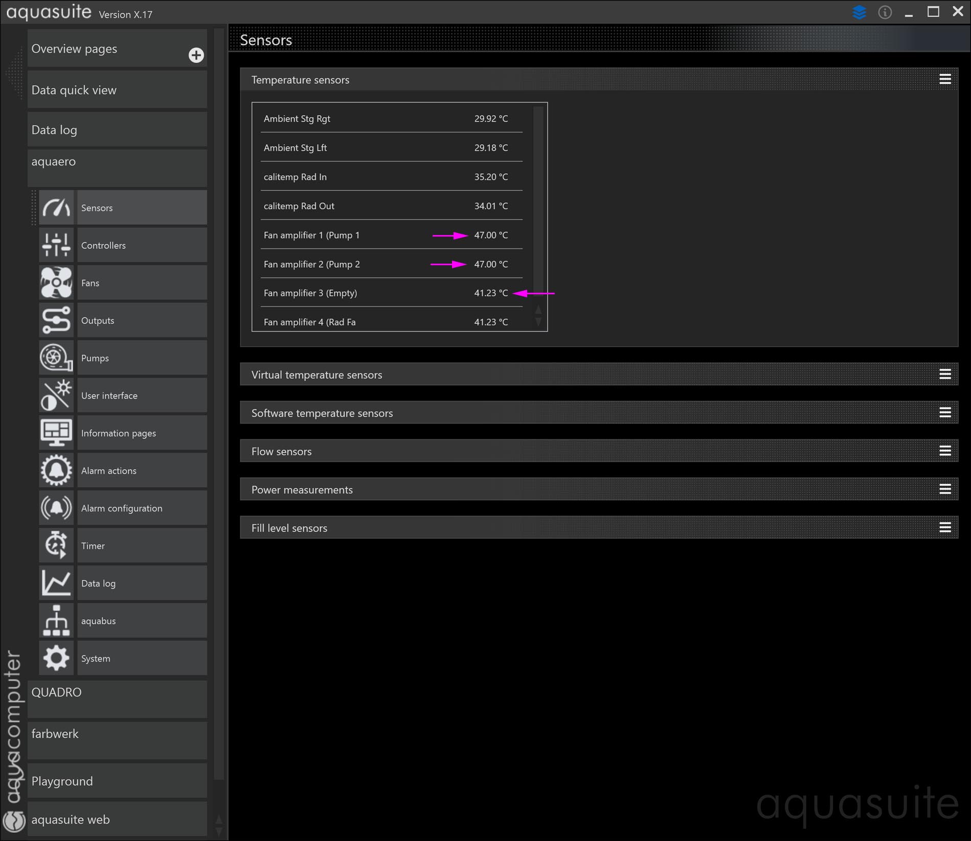

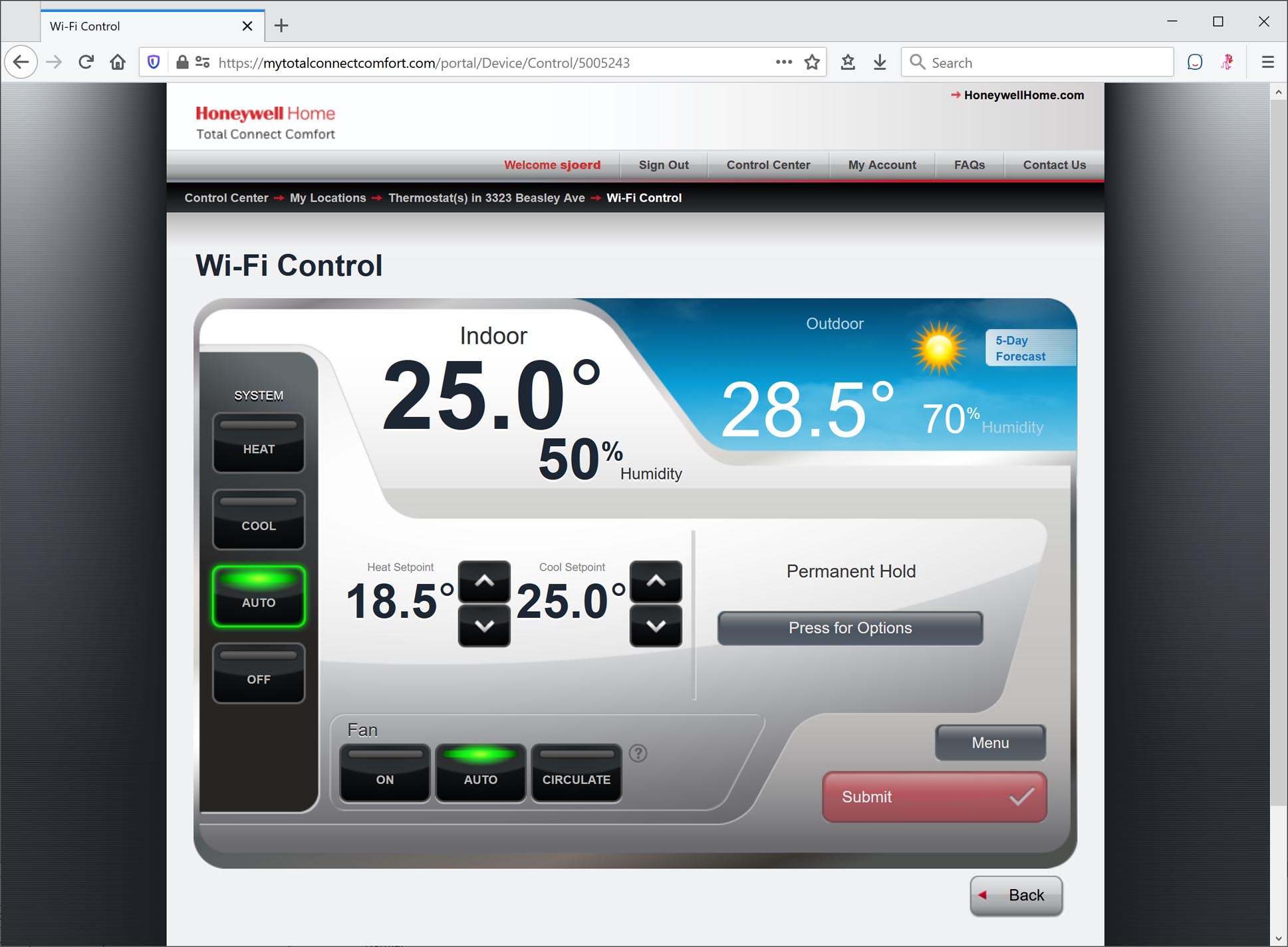

And the amplifier temps for the fan ports are running about 6 degrees (47 C) above the idle port (#3). temps.jpg
