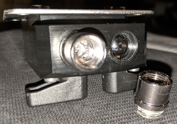

Filter fitting Size?
Mittwoch, 13. Mai 2020, 22:51
Need help to find out what type & size of thread is on these fittings. I have had this filter with stainless steel mesh, ball valves. The new version is stander with the G1/4 thread—the one I have not sure. I have never used it because of that. Is there a cross over for G 1/4?

I just wanted to pass this info forward to anyone that may have this same question as I did. I did reached out to AquaComputer support as well to see if they had an idea what I needed. They did reply, and also provide a solution for me thank you and appreciate the support. :)
Here is there reply:
Hello Antonio,
this seems to be an early variant that used G1/8 fittings.
The thread of G1/8 fitting has a diameter of about 9.6mm while for G1/4 it is about 12.9mm.
You could get G1/8 fittings to match your tubing size or you have to use a G1/8 to G1/4 adapter.
kind regards
Sven Hanisch
