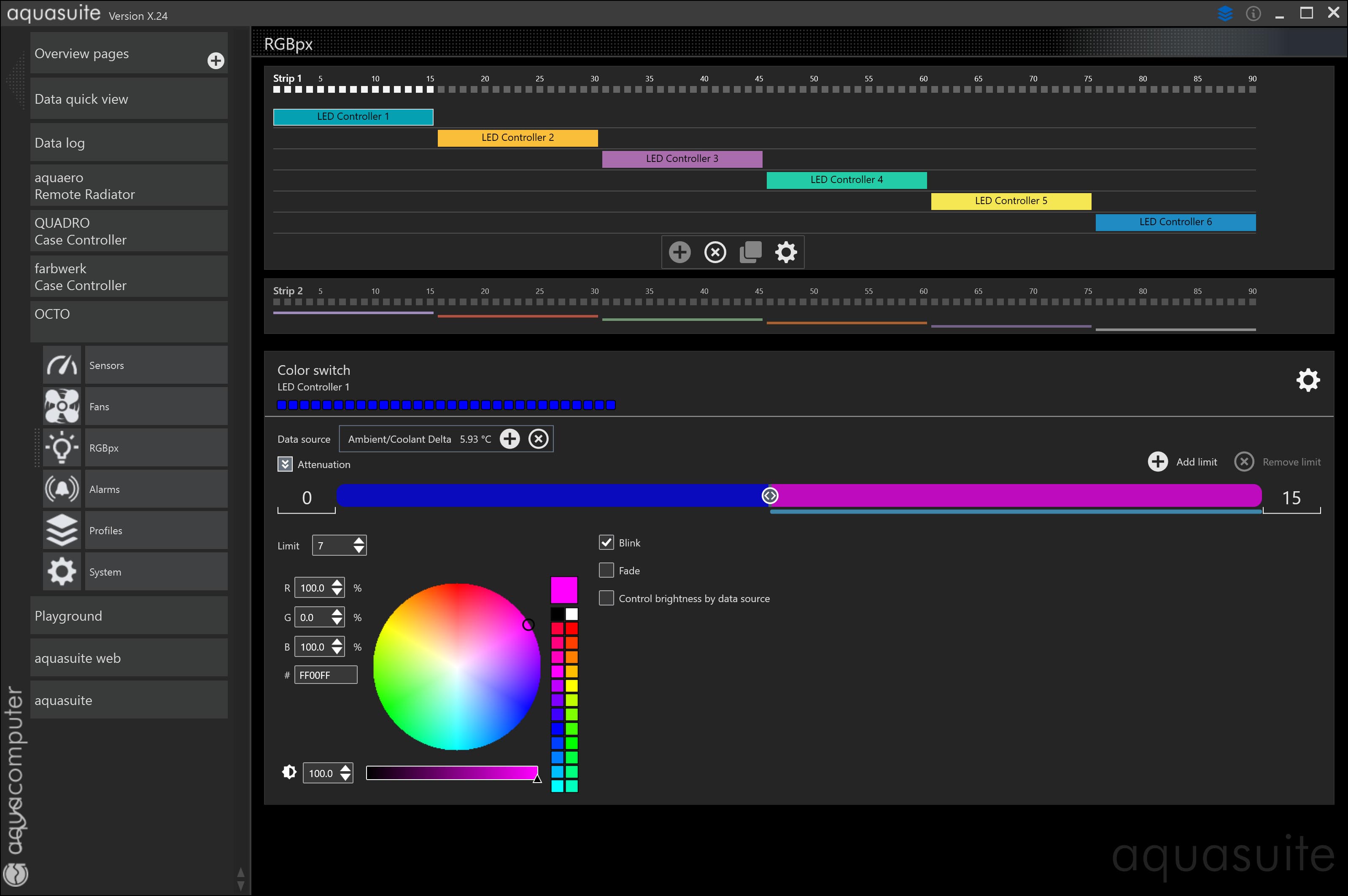

I set the LED color for my reservoir using the Color Switch LED controller to indicate acceptable or high coolant temperature status.
Currently that consists of blue for below limit, and blinking magenta for over limit. sub_controller.jpg
Here is the request... could we add a sub-controller in the color switch controller that would allow me to set an effect for either under/over limit conditions.
In particular for temps, I would like to set breathing for a below limit temp condition and then the blinking magenta for over limit.
Just to add a bit of entertainment :)

Can be done via the global profiles (playground). You set a condition for the temperature that switches between different device profiles with your desired effects.
Dienstag, 28. Juli 2020, 13:06
Got it... first time using profiles...very nice.
