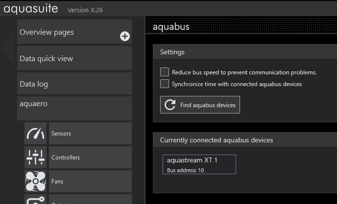

Each time I start the aquasuite, the aquaero loses the connection with the MPS High Flow USB (53129).

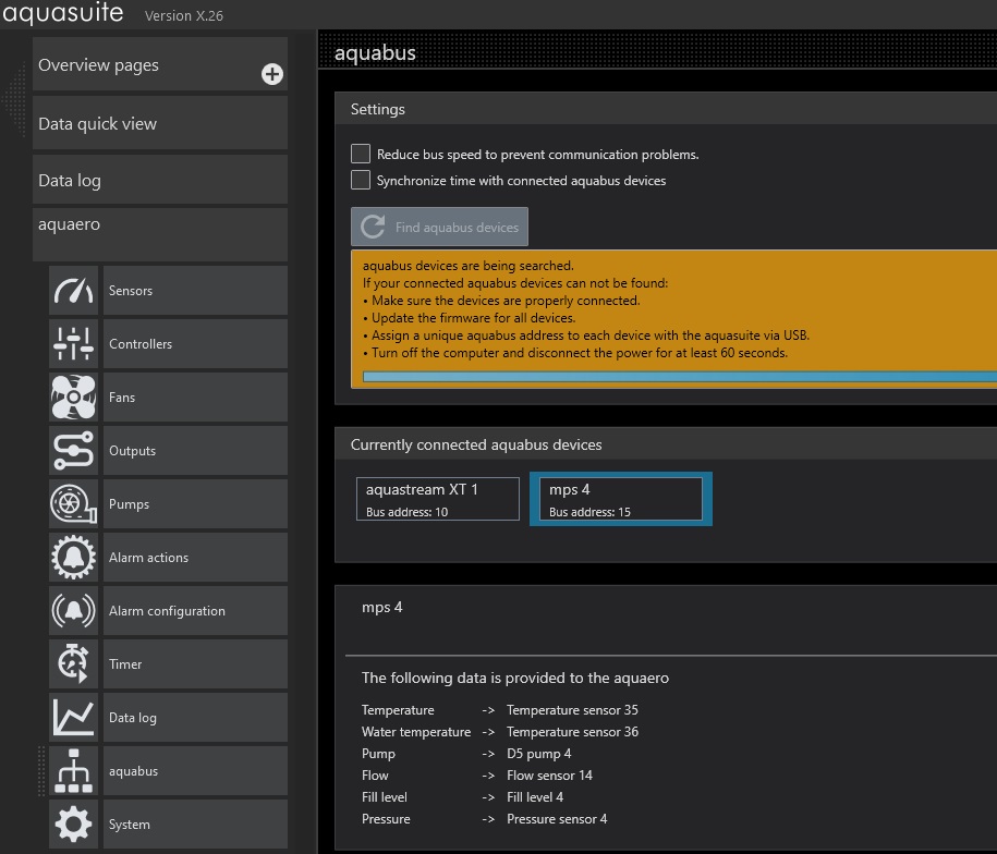

If I click on "Find aquabus devices", it is found again in no time.

A little update on the issue:I've disconnected the fill meter from the aquaero flow2 input and reseted all components to default settings. Next, uninstalled everything and deleted all folders, even those on user profile, then install again. New install, all overwritten, but same behaviour.
USB High Flow is not detected by the aquaero until I search for it, and every time I power up again the PC, sensor is lost.Time to check the Aquabus Y 4 pin cable and BINGO! Culprit found.
If I connect one component, no matter what of the two ends, the aquaero shows it without having to search manually and is persistent between reboots. Tryed with both MPS and the Aquastream XT and all worked.
Now waiting for the Aquabus X4 to arrive and check if it works.

X4 aquabus installed and all working perfectly:
