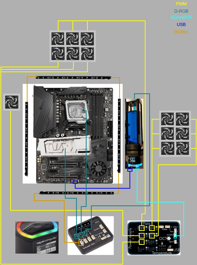

Hello everyone,
I recently build my first PC (newbie here) due to boredom (Corona's fault) and I've decided I want to enter the world of watercooling as well :D
my goal is to fully control this setup using aquasuite
Things I've got so far:
1x EKWB Quantum Velocity D-RGB
1x Heatkiller IV for 2080 RGB + Backplate
1x Heatkiller Tube 150 D5 + A-RGB LED Strip
1x D5 NEXT pump
2x HWlabs Nemesis 360 GTS
12x Arctic P12 PWM PST
1x Noctua A14
Before I buy the remaining parts, I'd like to know your opinions and/or suggestions.
parts to buy:
Octo ?
farbwerk 360 ? wanted to have LED strips around the case
highflow NEXT sensor
As you can see from my diagram, I have no idea what I'm doing.. I have no clue what goes where.
Can somebody please guide me where to plug what XD
Thanks in advance!

OCTO can not be connected to the D5 NEXT via aquabus. The aquabus always requires an aquaero as master device.
The RGBpx and mainboard-style plugs on farbwerk 360 are connected in parallel! If you want individual control of all components you have to use the 4th channel which is not used in your diagram.
If you let it be connected in parallel you have to add a second controller for this channel within the aquasuite. Assign the amount of the additional LEDs to it and set solid white as effect. This way you will get no problems that the port will be overloaded because of a wrong current calculation. The device does not know that you connect LEDs in parallel so you have to add these LEDs with an additional controller in the "invisible" LED area.
Freitag, 16. Oktober 2020, 16:47
Your diagram is missing three USB connections from high flow NEXT, Farbwerk 360 and Octo to the motherboard.

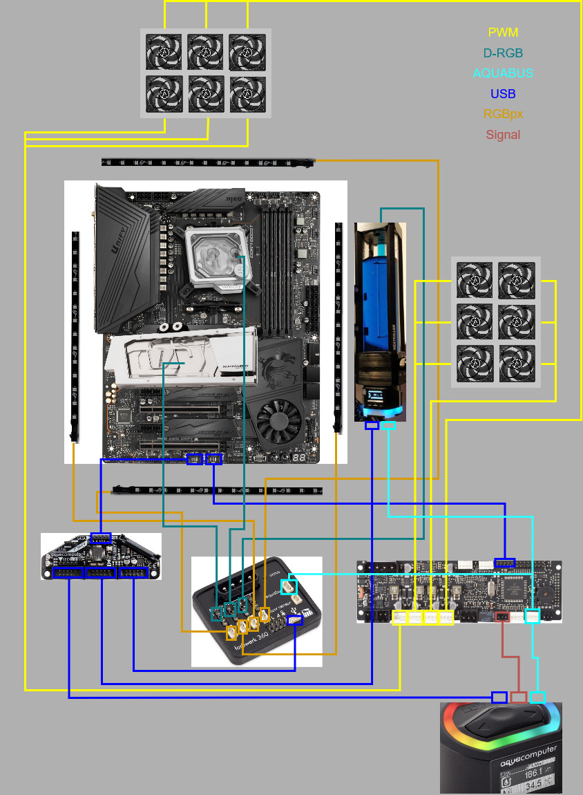

Thanks for the quick response Shoggy! I'll make a new diagram again but this time, using aquaero lt 6 instead of the Octo..
About the 4th channel that you mentioned, would it be possible to use a jumper instead?
Like what I've initially said, I have no clue what I'm doing and where to hook what.. My mobo only has 2 Usb header.. does this mean I have to get the Hubby7 for these to work? ?(

Hello everyone,
I made a new diagram again. Hopefully, it's correct now.
Regarding the Aquabus connection from Aquaero LT 6, I'll be using Aquabus X4
As for the Farbwerk 360's 4th Channel, would it be fine if I use "RGBpx lightning set for monitor" in series using RGBpx adapter for mobo header?
If this doesn't work, can you give me some ideas about what can I do with this 4th Channel?
**If you guys think that there are redundancy, please do correct me.
I'm open for suggestions.
Thanks in advance and have a nice weekend! :thumbsup:
»ae111James« hat folgende Datei angehängt:
Dieser Beitrag wurde bereits 2 mal editiert, zuletzt von »ae111James« (17. Oktober 2020, 11:09)
Samstag, 17. Oktober 2020, 18:05
You have a little mistake in your diagram, the USB motherboard headers provide 2 USB ports each, so you have 4 internal USB 2.0 ports for 4 devices.
So if you don't want to connect other internal USB devices or front ports you don't need the hubby.
It's the same with the Hubby 7, the 9 pin headers are two USB 2.0 ports each.
It is important to connect the internal USB cables always with the black wires in direction of the missing pin.
Translated with www.DeepL.com/Translator (free version)

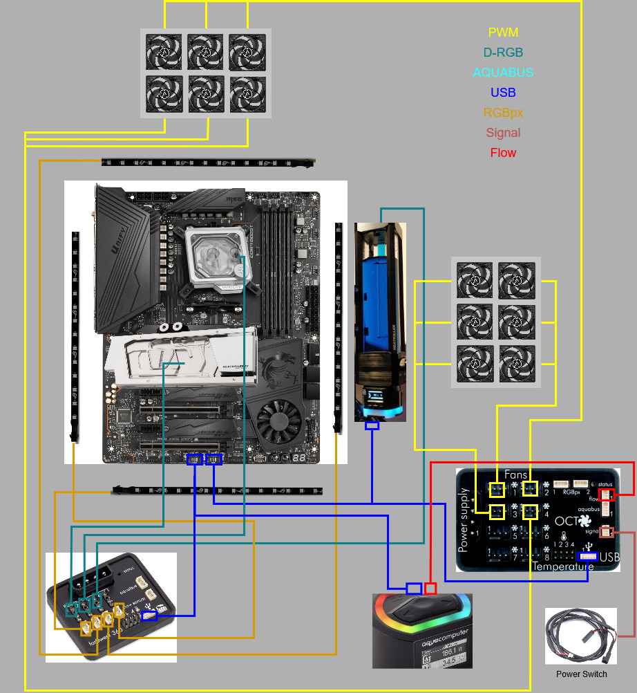

Hello everyone,
I made a new diagram without the aquaero, replaced it with Octo and included the alarm cable.
Instead of using aquabus splitters, all the devices are now connected through usb header.
can anyone confirm if what I did is right? can I control the pump's speed with just having the usb connection?

Hello everyone,
Yes, the pump RPM can be controlled with only the USB connection.
Daisy-chaining all four RGBpx strips to the fourth farbwerk 360 port may be a better solution (see Shoggy's post above), the only caveat being the total LED count has to be 90 or less.
Using THESE CABLES you could add four of THIS STRIP in series and better be able to control effects across all four strips. This will not work if you cut the strips (with exception of the last strip), as you will loose the OUT port on the cut strip

Hello InfoSeeker,thanks for the help! Shoggy helped me finish my diagram. It ended up almost just like what you said basically :thumbsup:
