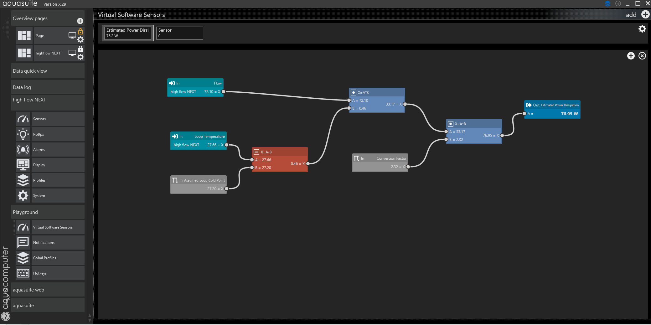

I'm sorry if this has already been answered / is obvious. I've tried searching, but haven't found anything.
I'm wondering if it's possible to have Aquasuite software read in a CSV file as if it were a "sensor"... my reason for wanting to do this, is that I have several temperature sensors in my loop which are connected to a Corsair Commander Pro (which I use for PWM control). But I also have a Flow sensor high flow NEXT in my loop, and I'd like to be able to use one of the temperature sensors connected to my Commander Pro (the sensor at the coldest point in my loop) with the temperature from my Flow sensor high flow NEXT (which is at the hottest point in my loop), in conjunction with the flow rate to calculate the power dissipated in my loop. I was planning on using a virtual sensor as per the layout below.

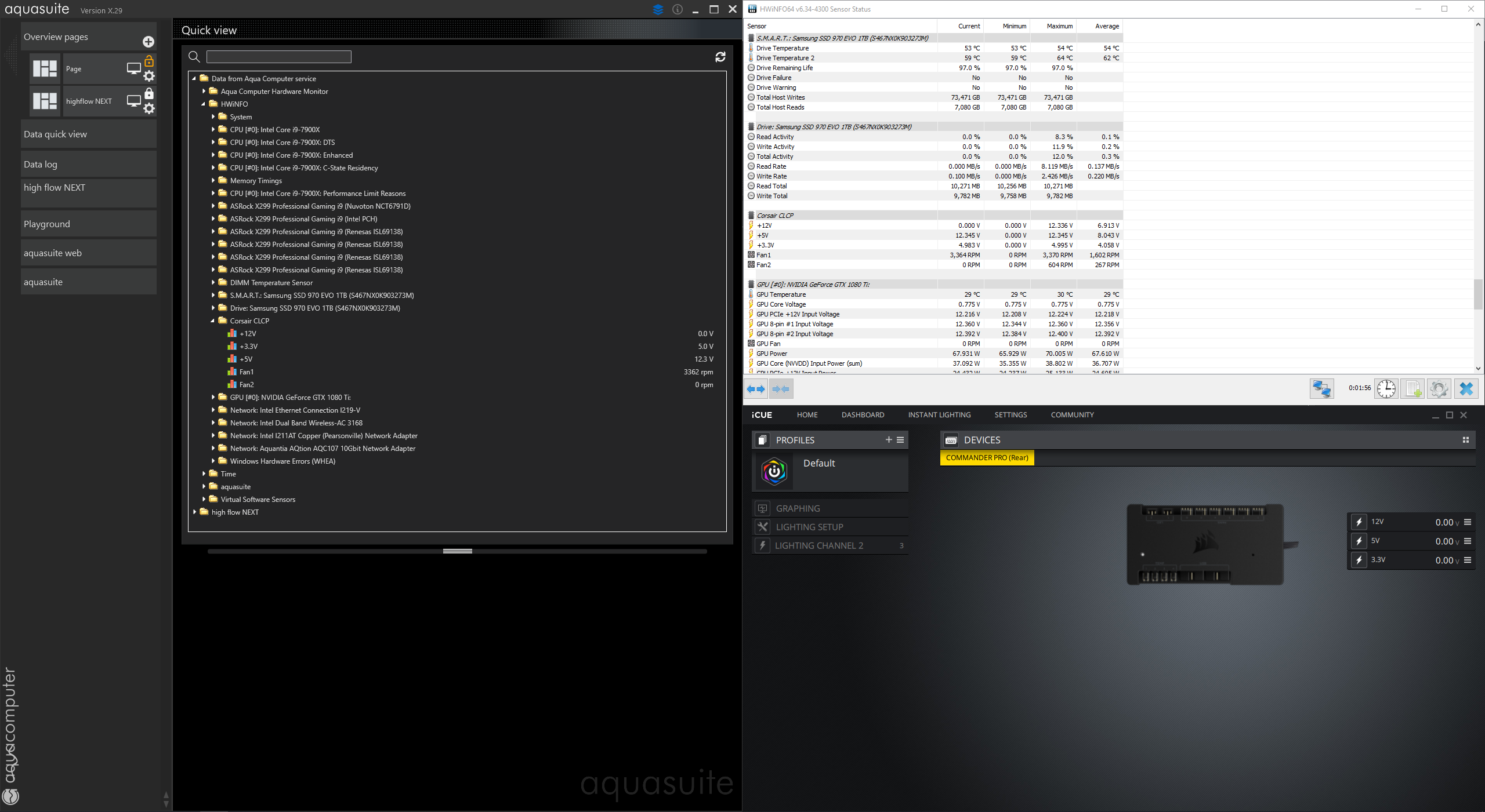

I didn't know that HWInfo data was visible inside Aquasuite. I generally don't have HWInfo running all the time, so I didn't see it. But seeing your post (and the previous one) made me try it. But interestingly when I start HWInfo, then iCUE software stops working correctly -- iCUE stops reporting temperatures and fan speeds and no longer allows me to control this. This is probably my first problem to solve. But here's a screenshot showing what I mean. Normally I would see 2 temperature sensors and 3 fan controls in iCUE.
But, this does mean that if I can solve the HWInfo to iCUE problem, then it should also solve my data availability in Aquasuite problem. Is incompatibility between iCUE and HWInfo a known issue?

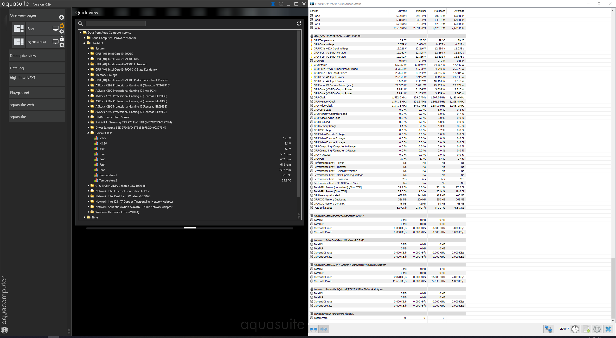

Ok... after a little bit of quick googling it turns out that iCUE and HWInfo really don't like playing in the same sandbox. I disabled iCUE on startup and now HWInfo (and by extension Aquasuite) can see the temperature and fan speeds from my Commander Pro just fine (see screenshot). This doesn't solve the temperature calibration issue. Nor does it solve the problem of having iCUE disabled so it won't control my aRGB anymore. But it does solve my original data source problem.
