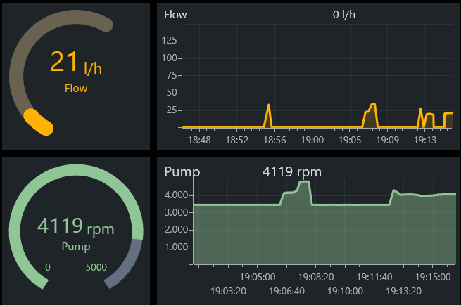

Hello,
i just installed high flow NEXT and i have 2 problems:
1) the Flow meter shows 0 l / h up to 72% of the D5 i.e. 4118rpm and 21 l / h 100% D5 4826 rpm
2) the temperature sensor of the D5 is 26.6 while that of the Flow meter is 29.9.even under stress there are always 3/4 degrees of difference (differences are put in places but being a small circuit the difference cannot be that big. which one should I believe ??
my custom lloop is so formed. Tank> D5Next Pump> GPU (Water WB 3080)> Radiator> WB CPU> Hight Flow meter> Radiator> Tank
does anyone know how to help me with the 2 problems listed above?

Your flow rate is too low.
The High Flow Next requires at least 35 l/h to measure accurate.
The low flow rate causes the temperature difference between the temp sensors.
The D5 Next measures the cold water, and the High Flow Next measures the warm water behind the CPU block.

First check what adds that much restriction to your loop. It may be clogged waterblocks for example.

at first glance from the plexiglass of the WB CPU / GPU I don't see anything, is there a way to understand if there is something blocking inside the radiators?

Maybe a Fitting is too long and screwed in too deep so it blocks the water flow...

I noticed that when I turn off the PC, a large air bubble comes back to me, between the Tank and the radiator on the radiator outlet and another air bubble between the flowmeter and the radiator at the inlet. So I'm sure there is an air bubble inside the radiator that can't get out.
the radiator is placed vertically with the inlet / outlet at the top, suggestions on how to get the air bubble out?
