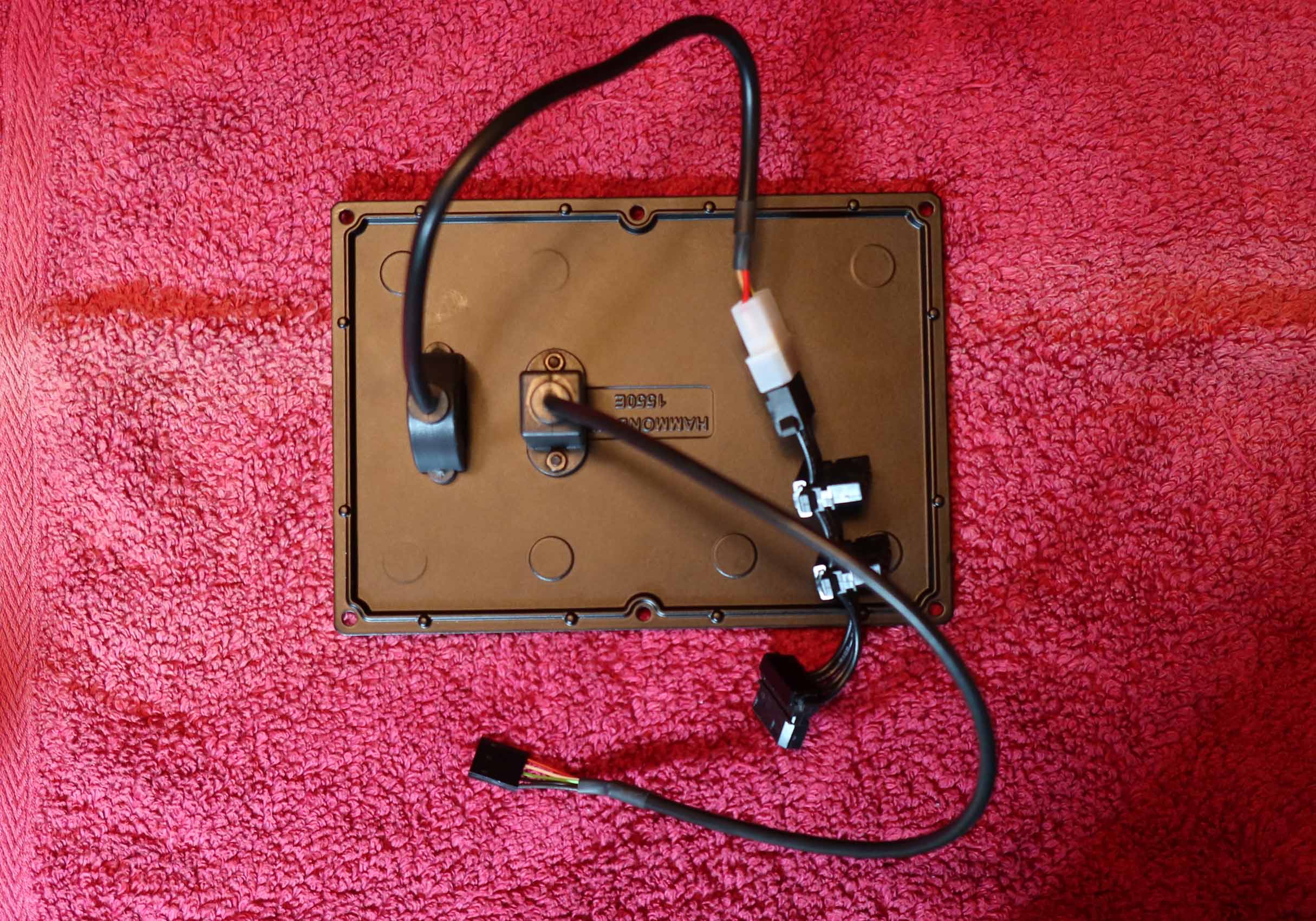

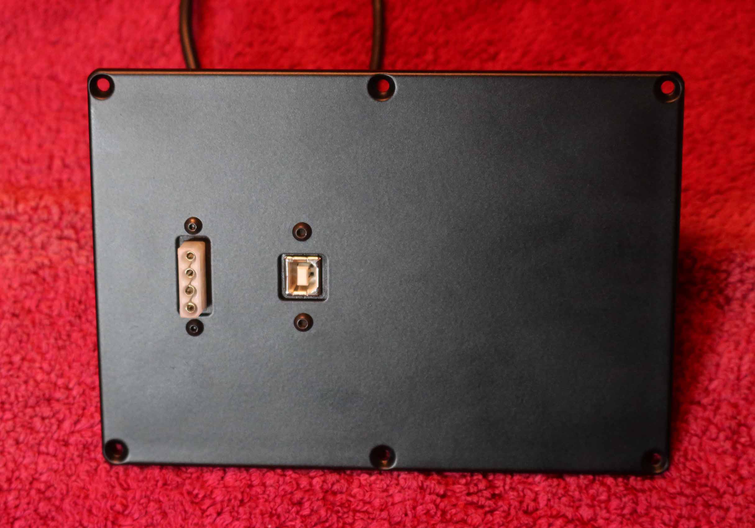

I designed a mounting plate to which I will mount the reservoir, the dual pump top w/pumps, analog & digital flow meter/sensor, temp sensor and a junction box, which will house an OCTO, HUBBY7 and maybe a farbwerk 360.
I modified the junction box to mount a Molex 4-pin panel mount connector and a USB female B connector.The 4-pin Molex power connector is reversed from what would be optimum, so the terminal end will either need to be reterminated to female, or use a gender swap.
I also added a Molex 4-pin panel mount connector to the back of the computer, connected to the PSU.
To connect the coolant hoses, use you favorite quick disconnects.
To connect the 4-pin Molex power connectors, use any extension cable, and either reterminate the female end so both are male, or use the gender-changer mentioned above.
Use a standard USB 2.0 Male A to Male B cable, of the proper length, to connect the USB port to one of the computer USB ports on the back plate.
Snapshots of the connectors mounted to the j-box lid: outside.jpg inside.jpg

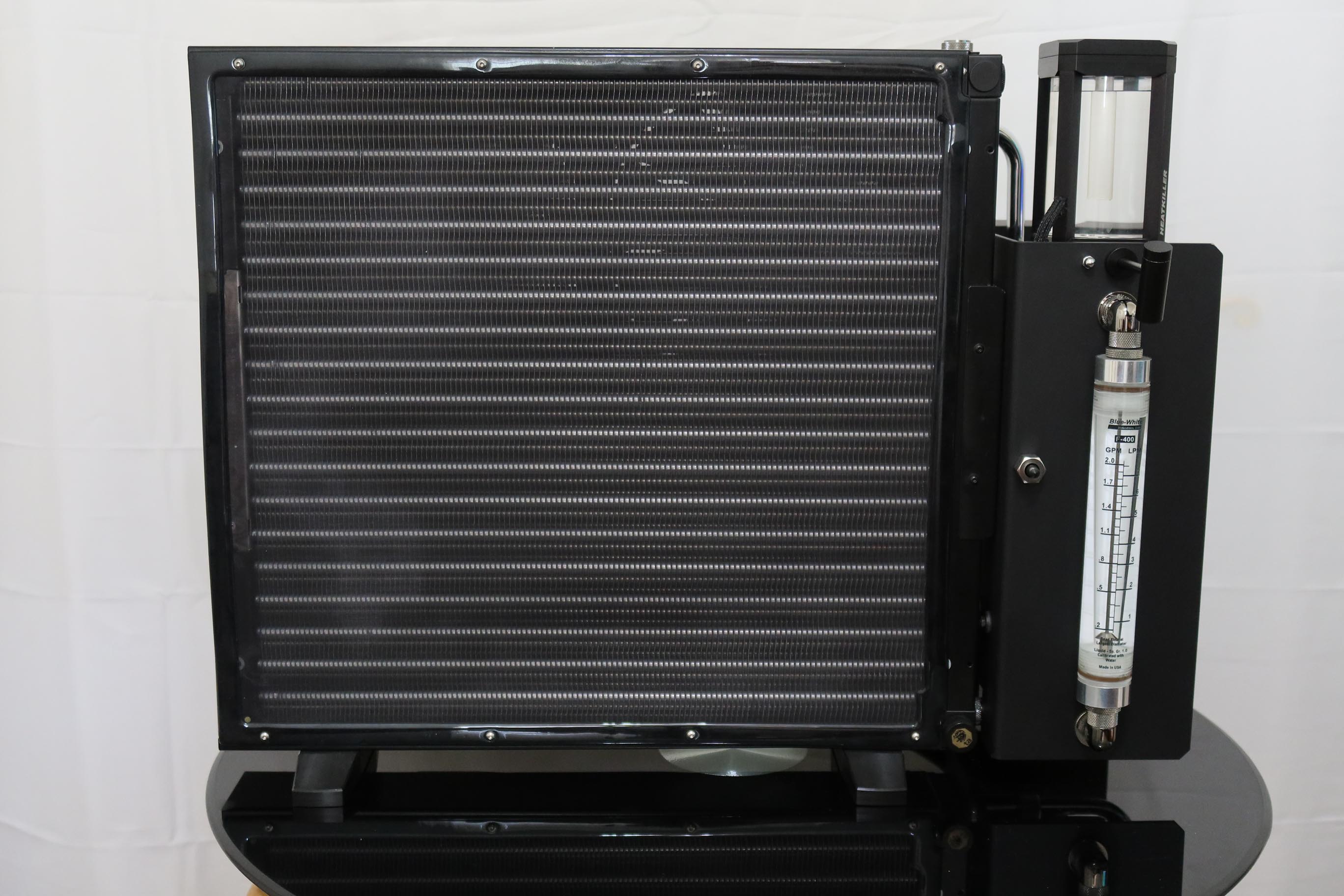

That King Instruments glass tube flow meter is very interesting. Can you explain how this device operates and how you plan to integrate it, and why?
Dienstag, 5. April 2022, 18:32
I went with a Blue-White flow meter. I liked the aesthetics better.
begna112
Mittwoch, 6. April 2022, 04:27

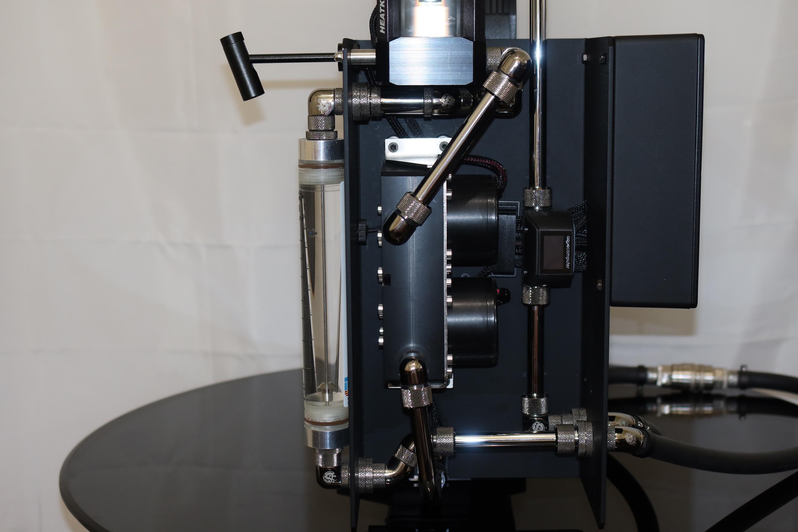

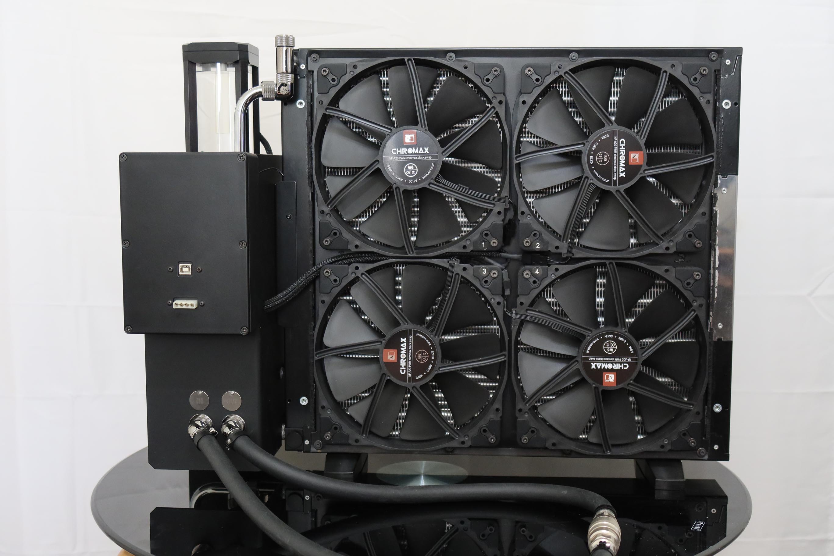

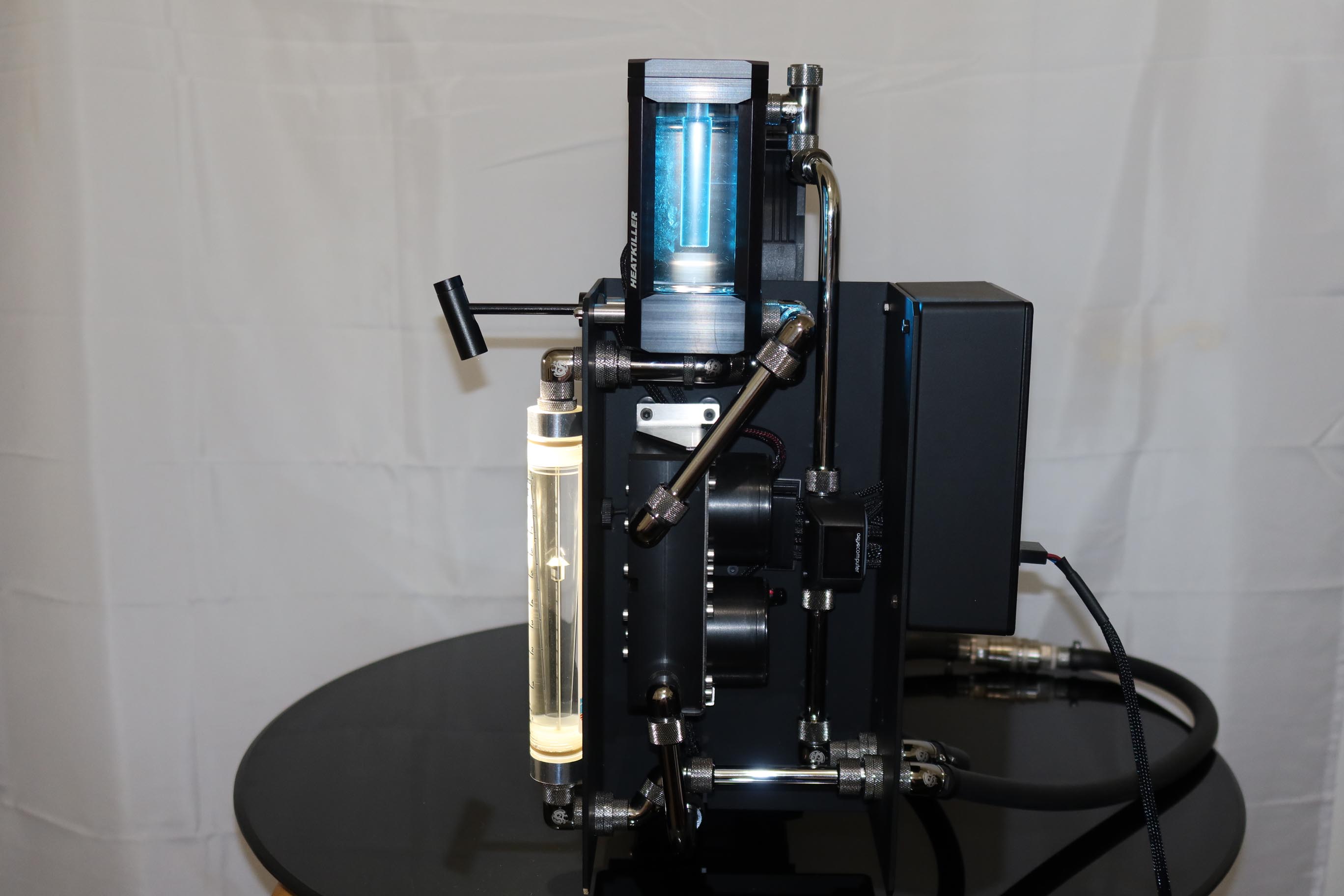

  • Front ([attach]9363[/attach])
  • Back([attach]9364[/attach])
  • Side ([attach]9365[/attach])
  • Side zoom ([attach]9366[/attach])
What's the black thing sticking out above the flow meter tube? And did you make the surrounding metal bracket thing yourself?
Mittwoch, 6. April 2022, 05:18
The black thing above the flow meter is a modified display case led light to light the flow meter.
It runs on 12v, so I put a fan connector on it and I use an input so I can take the fan controller from 1 (default) to 0 (off).
At 1 the octo fan controller puts out 12, volts and at 0 it does not.
I designed the mounting plate and contracted a machine shop to build it (Mounting_Plate_v6d-mm_Redacted.pdf)
Edit: THIS is a short video I made, but lighting is poor.
