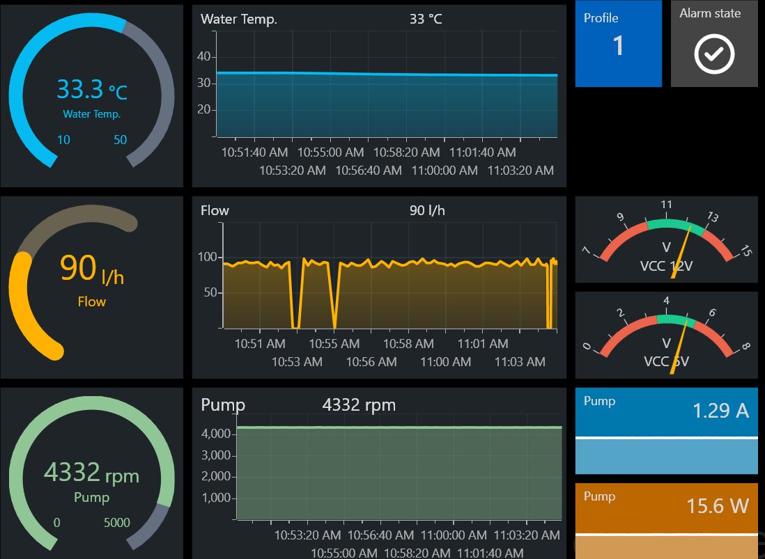

InfiniteImp
Montag, 8. Februar 2021, 17:07
Once I start getting close to 33 C, this is what I start seeing:
(see attachment)

Montag, 8. Februar 2021, 19:55
1. Are you using DP Ultra coolant?
2. Have you calibrated the virtual flow sensor?
1. No, I don't have access to that here. I'm using Swiftech HydrX. It's all I have on-hand.
Aqua Computer said many times, that the virtual sensor only works with DP Ultra.
InfiniteImp
Montag, 8. Februar 2021, 20:28
Seriously? They created a function that only works with their coolant? A coolant that I can't buy here.
The promotional video doesn't mention anything like 'Virtual flow sensor works only with DP Ultra coolant'.
I'm really hoping this isn't true because otherwise I really like this pump.
Montag, 8. Februar 2021, 20:44
Please read the manual, page 19:
Prerequisites for use:
● Double Protect Ultra as coolant
● Pump speed of at least 3000 rpm
● Flow rate of at least 80 l/h
● No additional pump in the cooling system
● Calibration process completed
Flow rates below 80 l/h will not be displayed due to increasing imprecision of the
calculation method for low flow rates.
They wrote it also in the Forum:
Genau das [anderes Kühlmittel] macht aber den Unterschied. Das steht auch so in der aquasuite und im Handbuch.
Wie bei der aquastream geht der Virtuelle Flow Sensor nur mit DP Ultra.
Translation:
"But it is exactly that [different coolant] that makes the difference. This is also stated in the aquasuite and in the manual.
As with the aquastream, the virtual flow sensor only works with DP Ultra."
Dieser Beitrag wurde bereits 1 mal editiert, zuletzt von »wpuser« (9. Februar 2021, 01:12)

Dienstag, 9. Februar 2021, 09:08
This function needs to know about the viscosity of the coolant. Otherwise it will not work.
So you simply need to achieve the right viscosity. You can mix a coolant with ~30% ethylen-glycole. This will have approx. the same vicosity as DP Ultra and the function will work.
