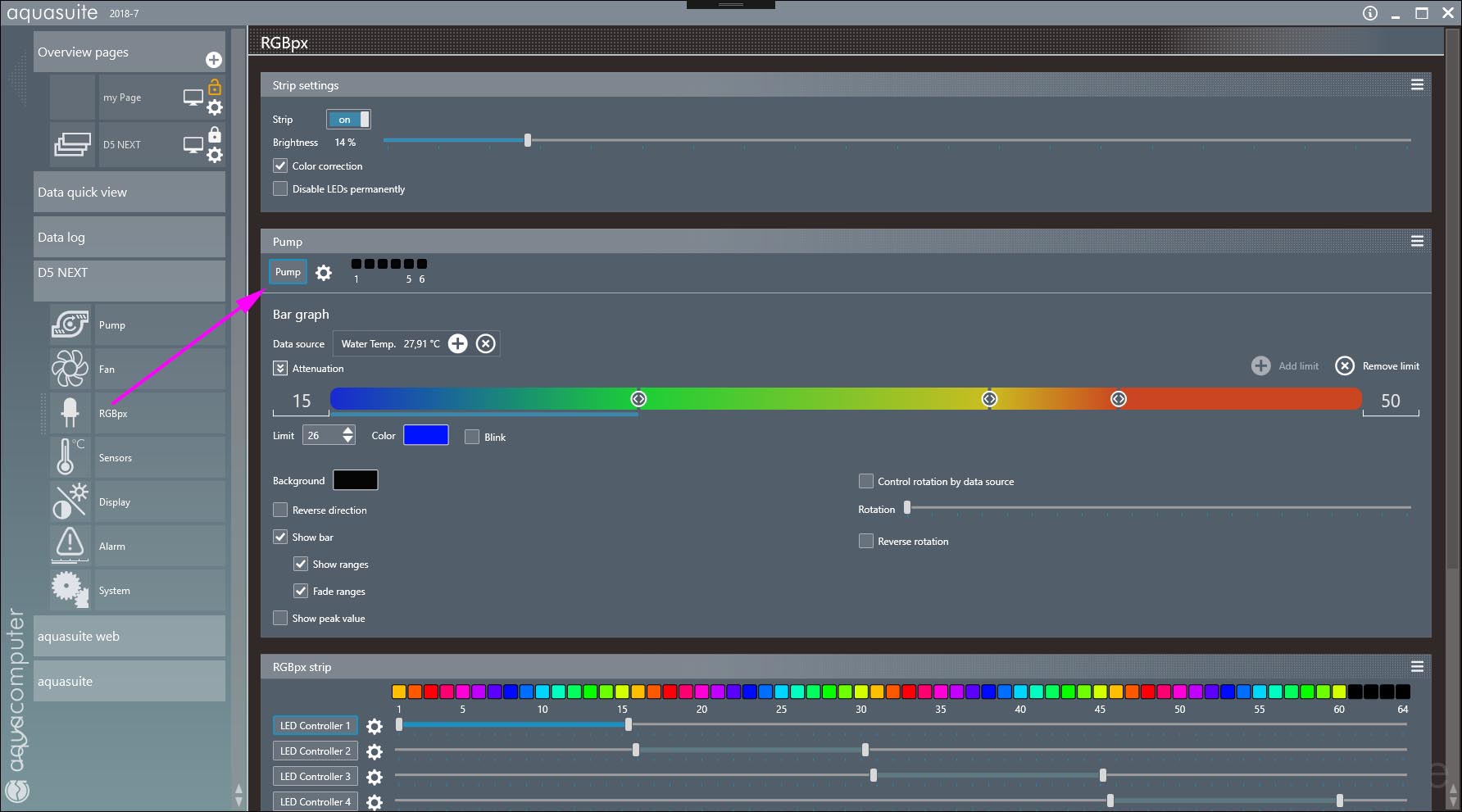

The D5 NEXT's LEDs are controlled internally in the pump from the RGBpx tab in aquasuite. d5rgb.jpg
If not using aquabus, the Ultitube RGBpx Ring can also be driven from the D5 NEXT's RGBpx/aquabus port. (same RGBpx tab as for the D5 itself)

Be sure the RGBpx/aquabus port is set to RGBpx in the pumps settings (I don't know the default)
