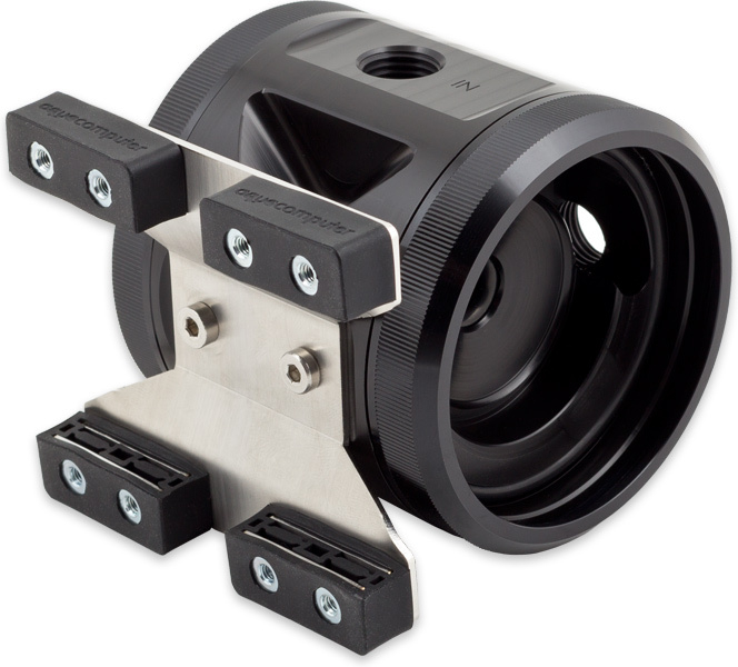

Depending if you're mounting the radiator vertically or horizontally, you will need to attach the ULTITOP DUAL D5 feet so the IN port is located to the top. (1.jpg)
Then you screw the Rotary Connector into the Ultitop IN port. (the fitting is 13.8 mm tall)
Lastly, screw the bottom port of the EK-RES X3 250 Lite onto the Rotary Connector (assuming you are returning to the top).
The advantage of the Rotary male/male connector is that you can rotate the tube to align the return port at the top for best installation.

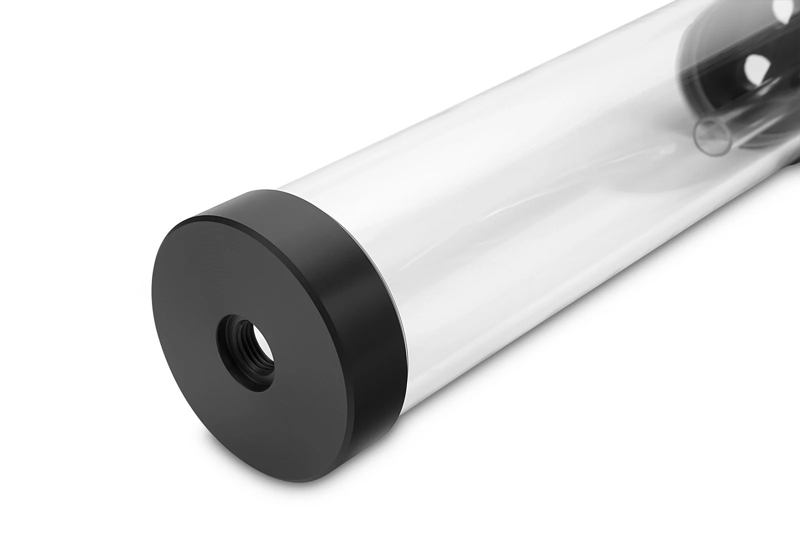

The only question I have is that the bottom port of the Res X3 is slightly recessed, but I believe the rotary fitting should fit. (2.jpg)

Good catch on the recessed res from EKWB if the LITE might be an issue i can always go for a stand alone 200mm tube and 1 upper top and one base top this should hopefully be ok.

The EK X3 Res Lite comes with extenders as well as the fitting to combine Duel Revo and res so it should work fine with Aquacomputer duel D5
