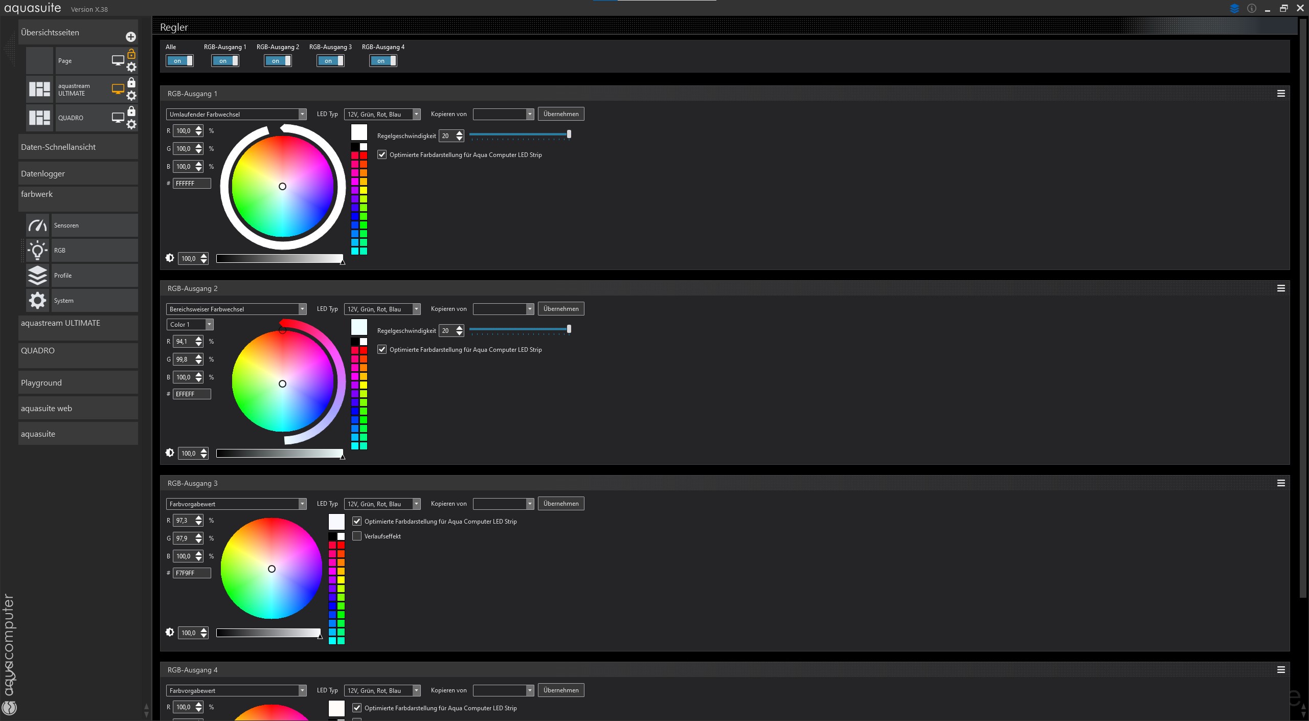

then if anybody has both, are the control's similar enough to where you could replicate what you have on RGBpx over on the regular rgb side and then just hope they come on at the same time? it really is a simple effect.
link to bigger version, can't get the embeded link to link through to a big one for some reason >.>
Dieser Beitrag wurde bereits 3 mal editiert, zuletzt von »anub1s21« (18. April 2021, 08:54)
Sonntag, 18. April 2021, 09:10
Here are the controls of the Farbwerk, I don't think it will fit.

ah ic yes thank you very much that indeed does not seem like the solution i was hoping for. oh well hold on untill i eventually upgrade my gpu and then slap a a-rgb block on it ^^
