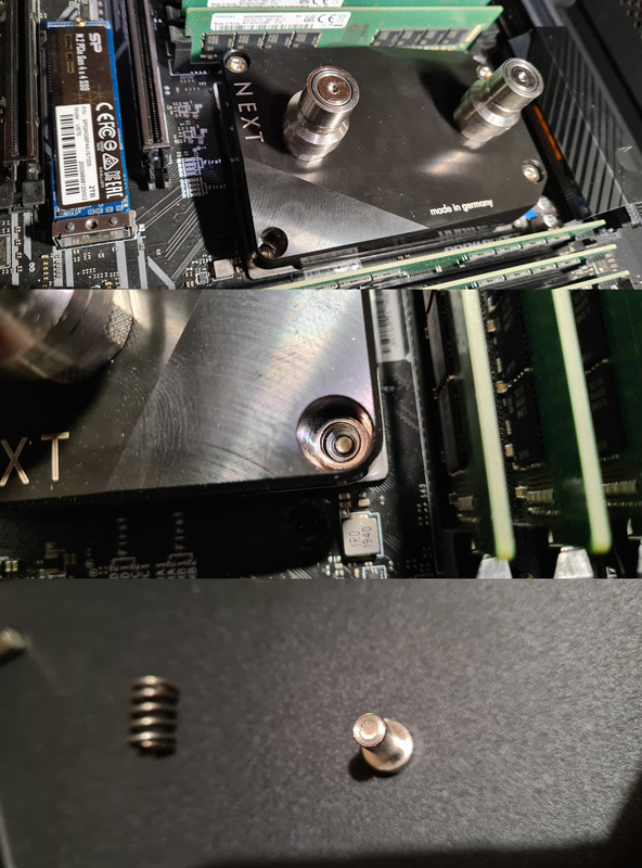

Hi all.
I have a terrible situation here - one of the screws on the waterblock broke. Just yesterday I was assembling the system and now my waterblock is holding on to three screws instead of four and in addition there is now a piece of broken screw inside the socket.
I have two questions - first - where to write about this incident and second - if someone had the same broken screw - how did you get its broken pieces from the socket?

Nasty.
support@aqua-computer.de
If you remove the block, is there enough left on the stub to grab with vise-grips?
Edit: perhaps an Easy Out type screw extractor?

It's right under the level of the socket, i.e. nothing is sticking out. :(

Then a screw extractor may be your best solution.
The upside is the screw should not be rusted in or stuck.

From the back of the board, use a very small drill bit as if you were going to drill out the screw. Once the bit grabs, it should start unscrewing the screw.

I think I found what type of screw it is (shoulder screw, m3.5*0.6 thread L=3.75 full lenght=20mm head D=8mm cap L=3.9mm shoulder L=12mm). They are sold everywhere except the aquacomputer shop (I mean as spare parts). So weird. God bless aliexpress (hope to find it there).
The screws seem to be made of nickel-plated brass. That's why they are so brittle.

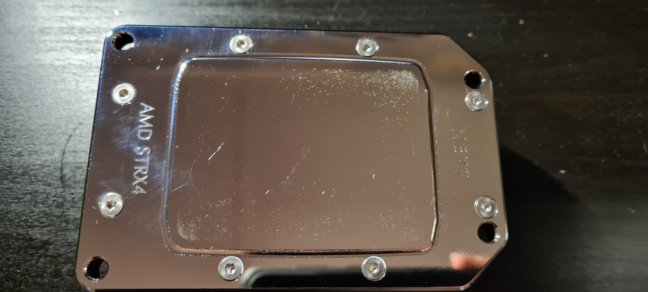

I am in the wildest shock. The thermal grease, which is included in the package - scratched all over my waterblock and CPU cover! I can catch the craters that are left with my fingernail. And where there were no screws, there are almost no scratches. The upper left corner is in the picture.
How much is the waterblock cover ? This is the included thermal paste... I'm shocked. I read that it can scratch, they had a bad batch. How did I get so "lucky". That's a damn shame!
I'm going to write to thermalgrizzly now.
Dieser Beitrag wurde bereits 1 mal editiert, zuletzt von »Paul Oblomov« (5. Juni 2021, 12:21)
Samstag, 5. Juni 2021, 13:39
I'm curious, how can thermal paste scratch your cooling block?

Coz they did crappy thermal paste... And now I used noctua h2 for this new fresh install. It doesn't scratch anything and is cheaper, than this crap.

Remayz
Samstag, 5. Juni 2021, 18:30
never had any scrach using kryonaut.. as they say, there's lots of counterfeiting, and also the possibility to get bad batches.
When some say MX4 spreads better than kryonaut, clearly they didn't get the stuff i know. MX4 is super thick and kryonaut very fluid.
Now remember that you had your cooler secured with 3 screws for a while, that throws everything off balance. doesn't surprise me you have two opposite corners marked. just fiddling with the broken screw could do that. the paste squishes out and you got metal to metal contact.
unrealted but, breaking the screw isn't a good sign ^^' you probably applied too much torque too. it's m3.5, the kind of stuff you do finger tight.. and shouldered is even more fragile than a straight M3.5.
All the pressure is done by the spring. as soon as you feel the shoulder bottom out, that's it, no need to torque down at all.

Polished metal rubs against polished metal and produces scratches (you can see btw the small dots, like sand particles were pressed into) :) Genius! But it's unlikely about the balance - there are three pressure points anyway.
About the fake thermal paste it's unthinkable - I used the paste from the waterblock kit. And to break the powdered brass is not so difficult, as my example showed :)

Samstag, 5. Juni 2021, 18:52
My question was rather designed to learn what should have been in the paste that can cause such scratches.
The particles must have had a size that you would have felt or heard it immediately during mounting or assembly.

the Ryzen IHS is not smooth, only the lettering is. that surface scuffs up very quickly, same on intel actually. that's the kind of marking i usually got with thicker thermal pastes like the MX. Not that the paste itself has big bits but it sometimes clumps, maybe because short shelf life? no idea.
Usually the paste gives like a tarnish, but not such sharp points.
Was it actually kryonaut, and not a cheaper one like Hydronaut or Aeronaut?
I'm really surprised, because kryonaut is so fluid and thin.. i don't see how it could possibly do this. Maybe the 1g syringes that ship with waterblocks don't hold up as long as the bigger retail ones.. really weird.

I don't understand why you're all so surprised. There are a huge number of these stories with Kryonaut. It's a defective batch. Thermalgrizzly RMA to some. Sometimes.

The screw is more annoying yea. i wonder why they thought using a crappy brass screw was a good idea to compress such a spring.
I'm kinda surprised you have 3 that didn't snap!
All the coolers i ever bought, air or water, came with steel hardware.
