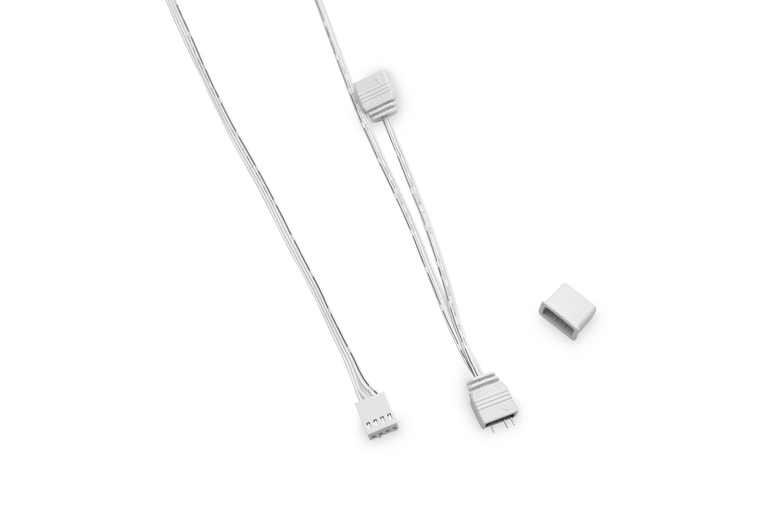

My fans have a splitter cable which allows me to connect more RGB/fans, however, every next fan is picking up the same 9 leds and thus duplicating the setting instead of showing up as extension/additional leds. This means changing the first 9 leds in aquasuite will change the leds on all the fans.
Fans in use are "EK-Vardar EVO 120ER D-RGB (500-2200 RPM) - White" - https://www.ekwb.com/shop/ek-vardar-evo-…-2200-rpm-white
Picture of the RGB splitter built into these fan connections:

the connector on the vardars are parallel connexions, so all fans will play the same preset. they would need to be 4 pin fans to be able to daisy chain as you want (data in/data out/5V/ground).
afaik, the only other option is to use one fan per channel which is uh... pretty wasteful. So i'd be interested if there's another option out there but i don't believe there is.. besides hacking the fans to make a connexion to the last LED to serve as data out for the next fan.

the problem is they have no way of daisy chaining one fan to another since there's no data out on the fans themselves, so you can't connect them in series at all.
working around that sounds like a complicated mess ^^' Honestly i feel like making a fan dedicated farbwerk with many small led channels would be easier
