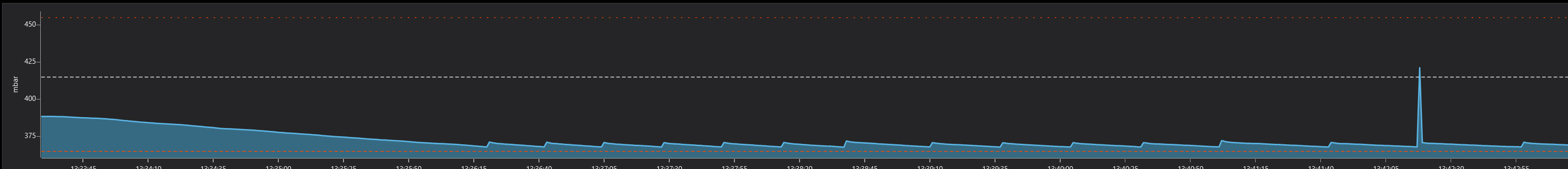

Hello
I have a strange behaviour. When the GPU is heating due to load (standard game), the pressure drops then the LS has to run frequently. See the attached screenshot. That phenomenon is not happening when the CPU us heating the liquid. Water reaches 48-50°C. (since my fan header of the D5 Next doesn't work I can't adjust the fan&pump rpms to the water temp yet)
Moreover, water bubbles can be seen on the GPU WB (mounted vertically) at the top left, while the loop has been drained several times (see photo). It sounds like the waterblock has not been perfectly sealed and when the temperature rises, the oring and/or the mechanical constrains makes the WB less sealed, and only the 'very' low pressure applied by the LS can identify it.
if the operating pressure is set at around 250mbar, that issue doesn't occur. And it seems that, when I hadn't the LS yet, the water was spreading a bit beyond where the PMMA contacts, up to the oring, at the exact same spot.
Has anyone a Leakshield AND a kryographics next WB? and if yes, experienced that kind of pressure drop? Or am I experiencing again a fourth issue with AQ products?

you water is WAY too hot. that's one thing, but it would create high pressure..
What's weird in your photos, besides a dangling strip :p is the little bubbles we can see on the oring sealing surface towards the bottom left. worth checking if all the screws are correctly tightened around the acrylic face of the waterblock.

Hopefully this is not applicable, but under 1/2 bar vacuum the boiling point of water is down to about 80 degrees C. If water is heated to this temperature locally then it would 'boil', which would introduce vapour to the system. This would increase the pressure/decrease the vacuum of the system.

yes indeed
at 550 mbar absolute which is around 450mbar relative displayed by LS, pure water boils at 84.1 °C
ingame, when pressure drops, the hotspot temp indicated by the GPU itself says 75°C, quite steady
there is a bit of a margin but actually that was an interesting thought Thx

if it came to boiling you'd have more pressing problems hehe
75 is air cooling temperatures, so there's work to do there :p the water temp is usually not much below the GPU water block temperature, so that's a big delta you have here. Maybe not enough flow to start with. i wouldn't go far below 50% pwm on any kind of loop just because of that.
These waterblocks are pretty good so i would expect to see 10-15°C difference between water and GPU temp under load.
That big bubble, plus your 25° temp differential = maybe low flow.
