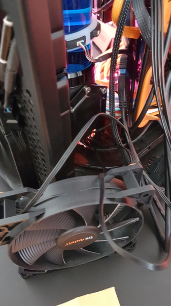

  1. the fan header of my D5 Next is not working at all: see http://planete-flop.fr/gallerie/_data/i/…9c0e38fb-me.jpg and my post D5 NEXT: Fan header not functionnal

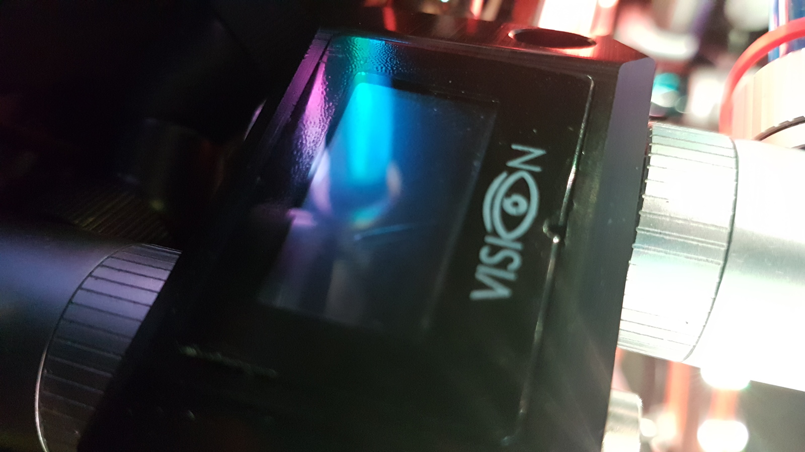

1- I received the VISION RGBpx connection terminal for kryographics with active back plate: the screen was not fixed/clipped in it. I thought it was a great idea since I had to plug the temperature sensor and the rgbpx cable.
2- when I switched on the power, the screen was not working and I saw cracks on the screen. Fitting the screen on the terminal was actually very difficult, so I thought I was careless. I've order a replacement screen, product n° 53240.
3- the installation of the replacement screen was again very difficult. And when I switched on, I actually saw and heard a crack on the screen. I've just seen the logo in full a second. Half the screen died (see pics at the end). Then it entirely died.

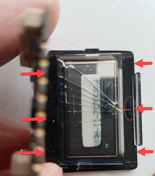

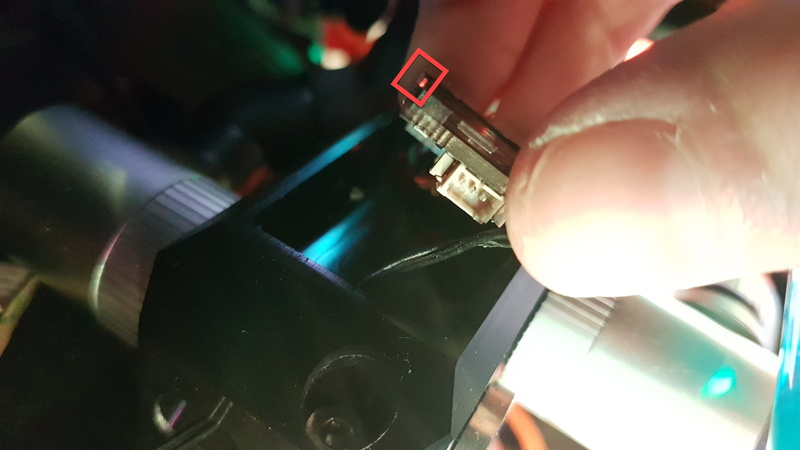

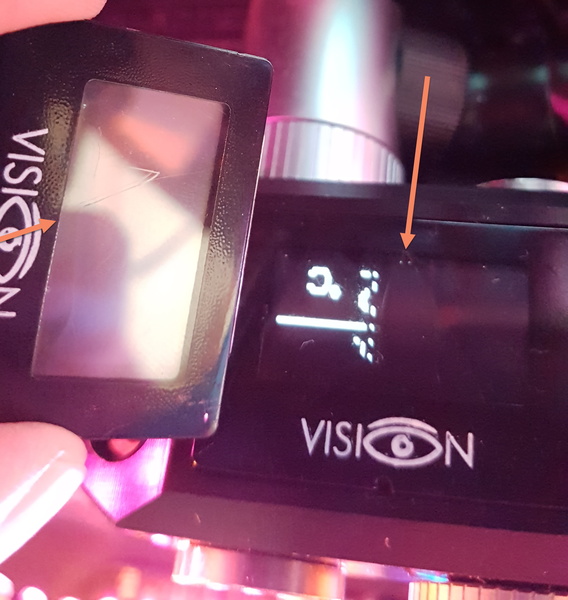

with the pics below you can very clearly see that the top plastic bit (in the orange circle on the picture) applied to much pressure on the screen. On the first screen, the cracks starts at the bottom, so that was the bottom one which induced the cracks. So in both cases, the pressure applied was too high on the width of the product and that mechanical constrain on the black plastic cover was distributed to the screen itself, which is not flexible. The mechanical constrain on the black plastic cover comes from the transparent plastic bit at the top, which reduces way too much the width when lodging the VISION into the terminal. Your terminal tolerances may be faulty, your design for the vision may be faulty...

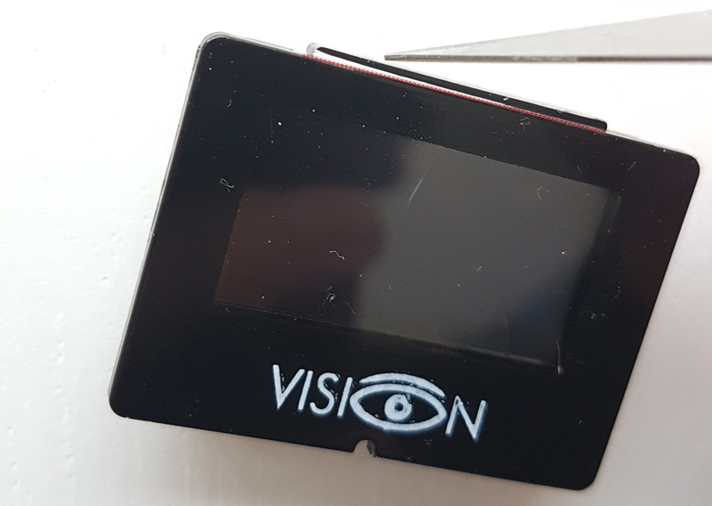

I've removed with a scalpel the rectangular transparent plastic at the top of the screen. Not surprisingly the screen fits much much more easily. It wiggles a bit since the fit is no more extremely tight but it holds it.
the 2 dead screens
investigation and explanations of why it broke
just before removing the plastic
now fitting the screen without the top transparent plastic
working like a charm:
