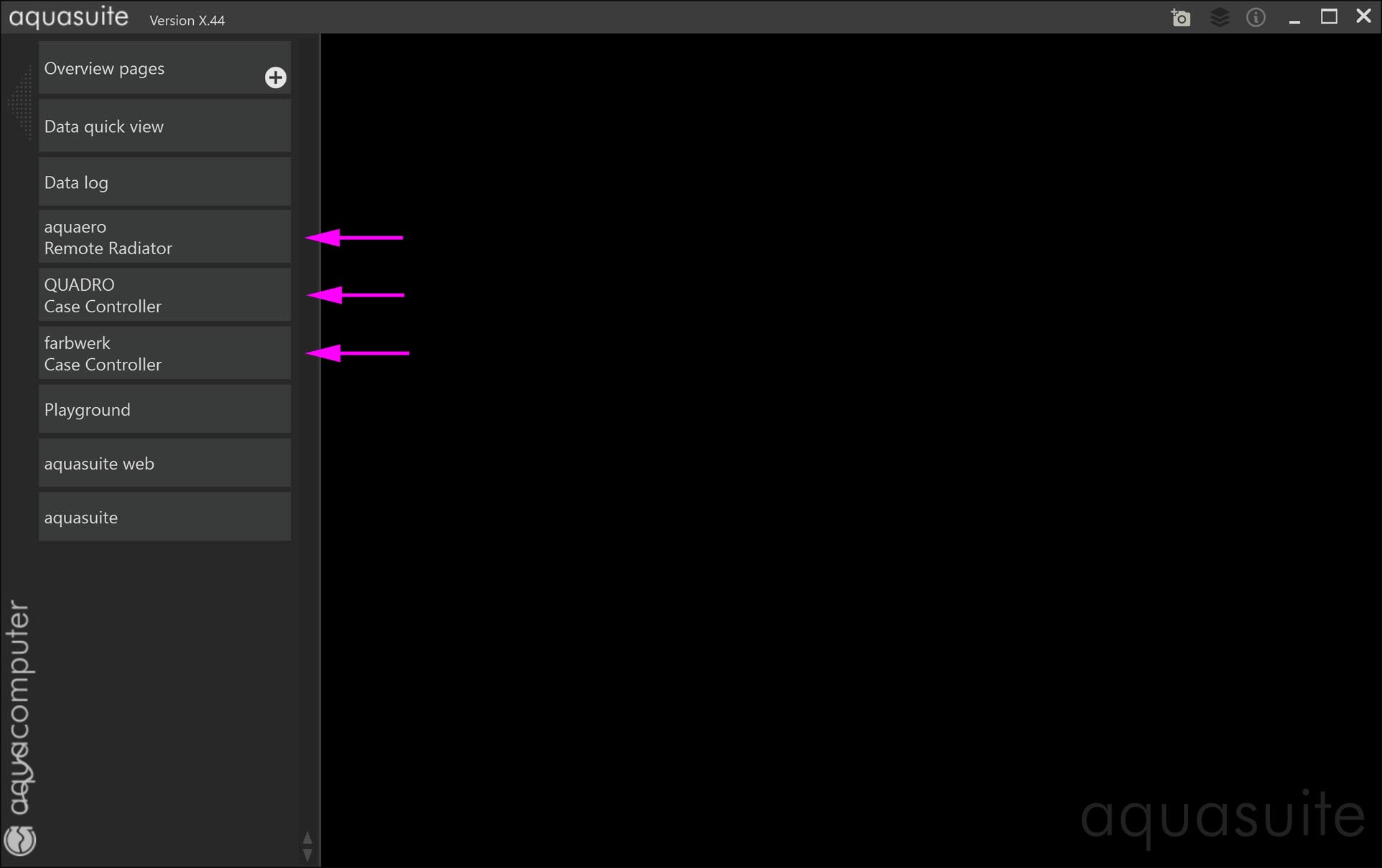

Dienstag, 14. September 2021, 13:13
If you are able to run aquasuite, you do not need to employ the aquabus.
The aquabus has benefits, but also introduces limitations.
The aquabus is most useful for systems that cannot run aquasuite (e.g. Linux OS)
All aquacomputer modules with USB are able to communicate via the aquasuite.
Bottom line, if you run aquasuite (sans aquabus), you can get the full effect of every installed Farbwerl 360.
Edit: each aquacomputer module with USB will have it's own tab in the aquasuite. (tabs.jpg)
