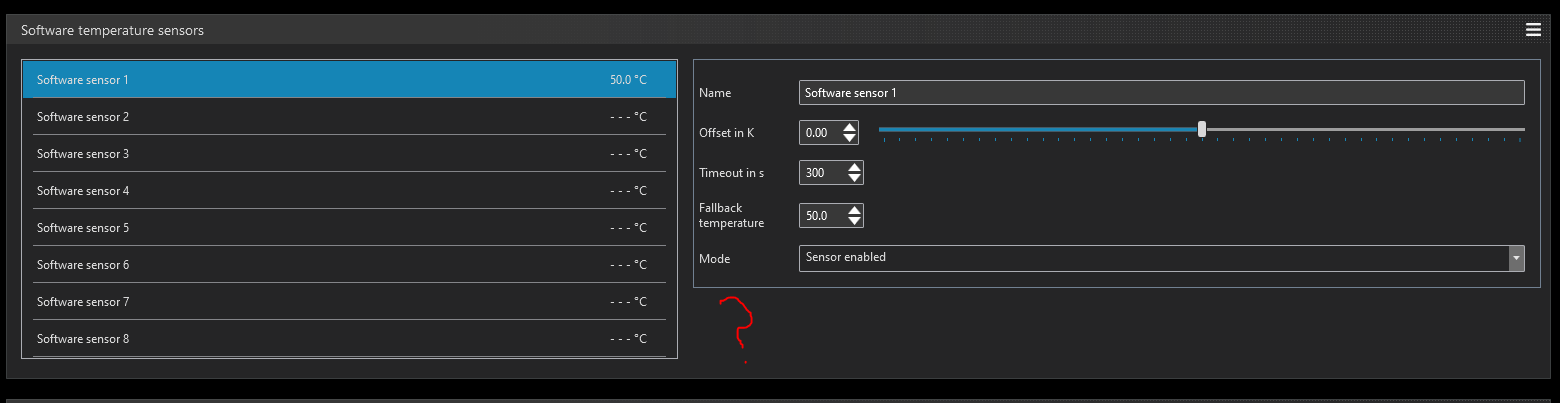

Hello,
I am trying to setup Software Sensors for my Aquero 6, but I cannot add any data sources to them. See attachment. I have a farbwerk as well and the Sensors there allow me to add Data Sources.
Is there something I need to do to get the 'add Data source' button to show up?
I am running AquaSuite x.44 and my aquero 6 is on firmware 2104
Thanks!
»haydn.williams« hat folgendes Bild angehängt:
Montag, 20. September 2021, 09:49
The Service is not running correct. Restart the aquasuite service.
