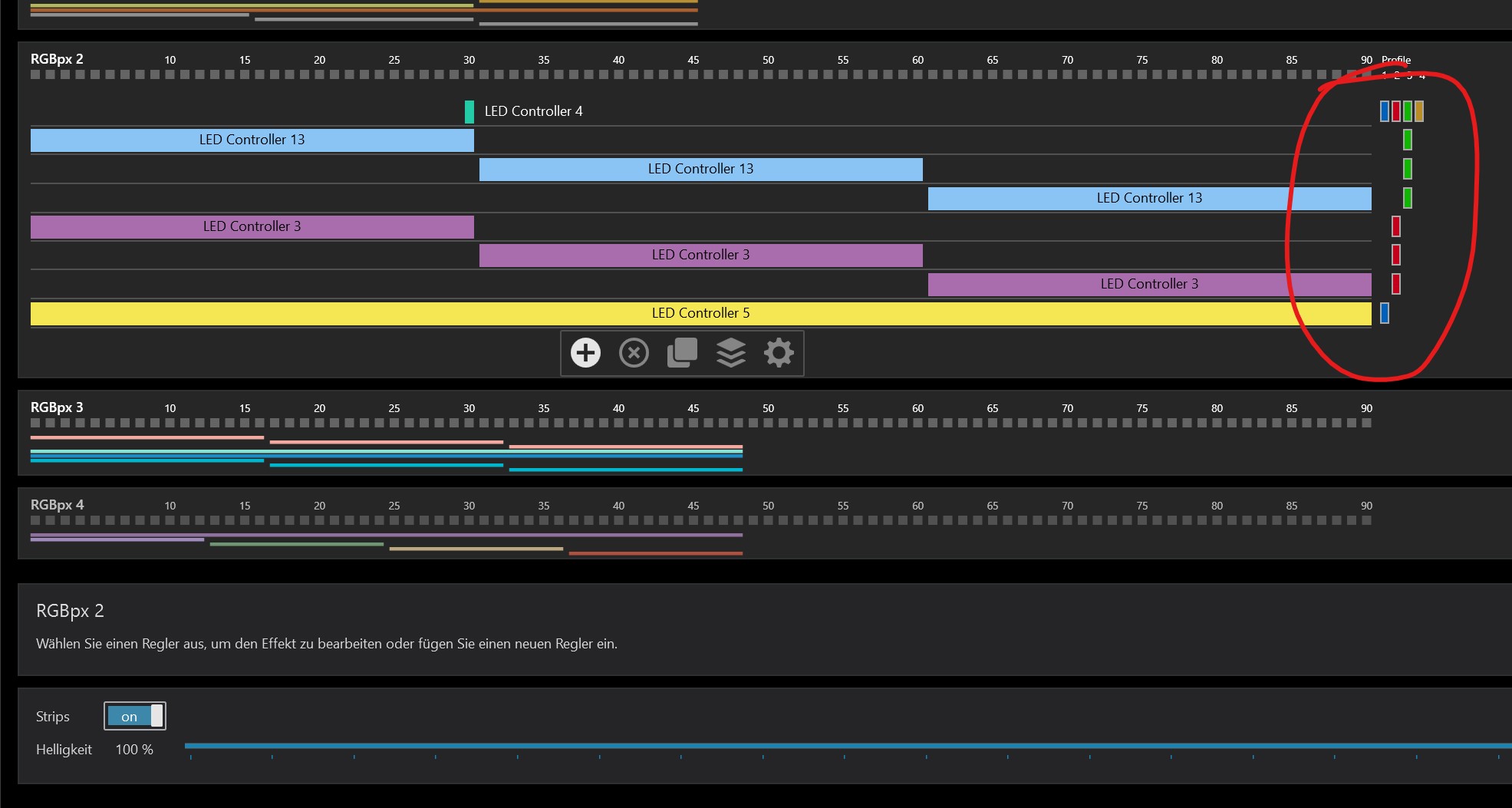

Look at that screenshot of my Farbwerk 360 setup. See the colored boxes on each line (I've marked them)? They show which profile the respective controller is assigned to:
That means, if you activate profile 1 (blue), only controller 5 (the bottom one) and Controller 4 (the top one) are active.
In profile 2 (red) controller 3 and 4 are active and with profile 3 (green) controller 13 and 4 are active. With profile 4, ONLY controller 4 is active.

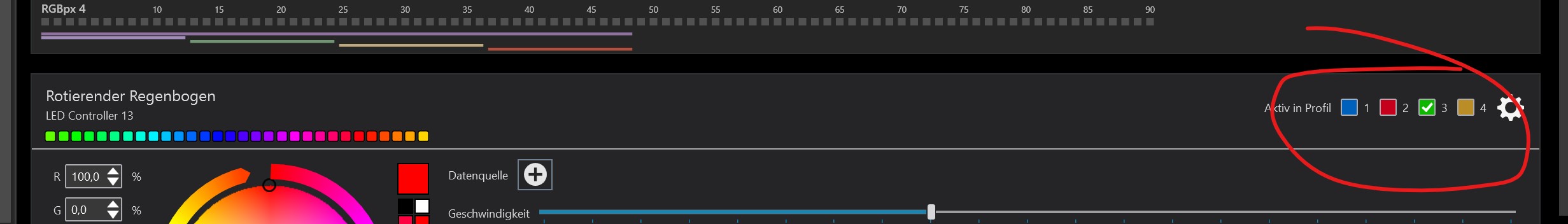

You can set which profile a controller is using with these checkbuttons:
Hope that helps!
[attach]8779[/attach]

Thank you so much I got the 360 figured out that ss and selecting the checkboxes changing profiles basically set it straight for me. I thought selecting profiles you had to go into profiles and click on one that makes it a bit easier. Now I just do the nano the same way and add more leds to the same rgbpx1 and select certain checkboxes for those leds. Got it thankyou so much!
