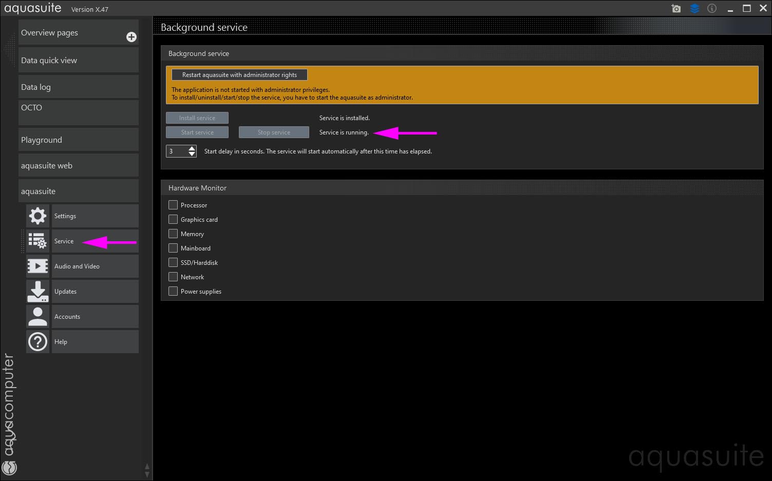

I have not used aida64 for some years and I do not remember if you have to activate shared memory. If it does require activation, do so.
Aquasuite requires you activate 'Background service' from the 'Service' tab {service.jpg}

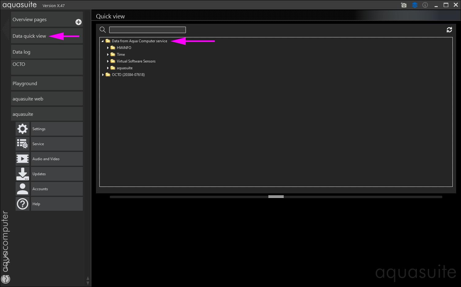

Aida64 should then list in the 'Data quick view' tab under 'Data from Aqua Computer service' {data.jpg}
If you see aida64 listed, then you can use sensors from it as a source for your fan controls.
