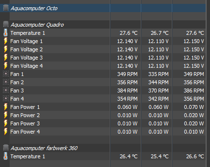

Octo sensors missing in HWiNFO after upgrading AquaSuite to X.47
Dienstag, 4. Januar 2022, 21:38
Hello!
I was previously using X.44 and today I upgraded to X.47 and did the device firmware updates. My Quadro and Farbwerk360 are showing sensor data in HWiNFO (6.42-4360), but my Octo is showing as having no sensors in HWiNFO.
I've rebooted and shutdown a few times just to see if there is something that needed re-initialising, but it's still not appearing.
Is this a known issue perhaps?
Thanks!
Chris
»cmsj« hat folgendes Bild angehängt:
Remayz
Dienstag, 4. Januar 2022, 23:03
the firmware changed quite a lot. you need the latest HWinfo version to read the sensors again

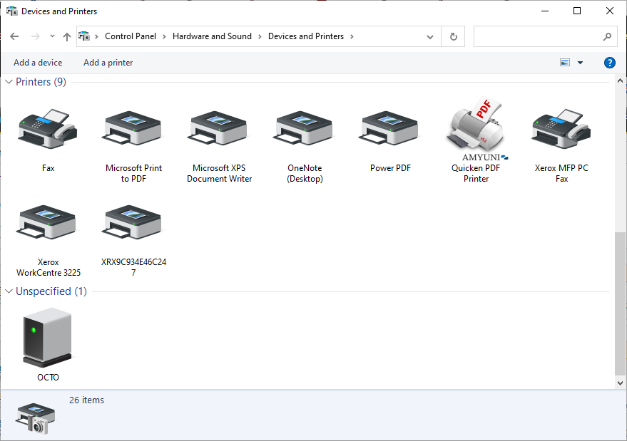

Mittwoch, 5. Januar 2022, 01:04
Does the octo show up in Windows? {octo.jpg}
cmsj
Mittwoch, 5. Januar 2022, 10:48
Even though the Quadro and Farbwerk360 still show up in HWinfo?
Does the octo show up in Windows? {[attach]9019[/attach]}
Yes
cmsj
Mittwoch, 5. Januar 2022, 10:57
Well, annoyingly, it does seem that updating HWinfo has fixed it. Thanks!
